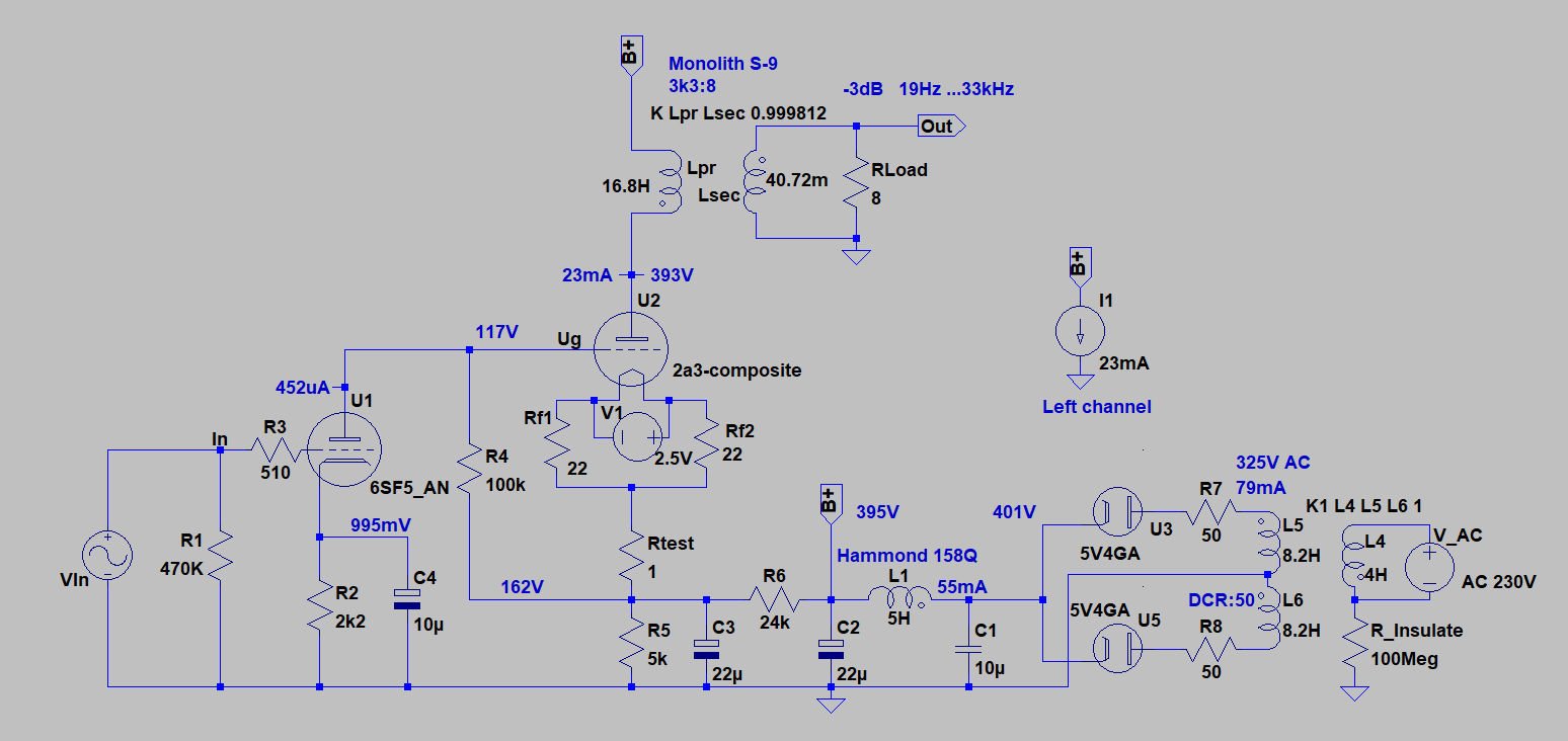

Ok, so you have a plate voltage of 228V? or is that the A-K voltage, with the plate at around 330V (or so) with the cathode at around 102V? If this is the case, then you're a lucky person. 😉

Lucky? Not really. I did my homework. A-K to be more precise is 228V. Yep 330V exactly. Yes on the cathode V. Originally I used a PT more inline with the 2A3 tube requirements. I saw a post on another forum where the builder used a PT from a Sony TC500 reel to reel unit. It worked out perfectly with just a change of the rectifier, that's it. As can be seen I did make corrections throughout the thread from post #1. I gave as much info as possible but I find I had to repeat myself a few times while getting faces made at me, not cool.

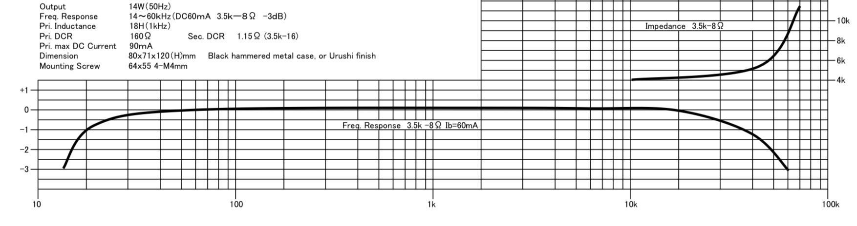

My conclusion- It's the OT's, beautiful beautiful sounding above 60hz and beyond. Somewhat misleading low end specs. Could also be that the Bolero woofers respond better with SS amps. I'm done with this thread now.

So, tell us about these Altec Bolero's where the LF rolls off. Sure, they may be 8 ohm and 90db sensitivity, but maybe there is more out there, because your RCA LC-1 sound quite alright with this amp. Of course the RCA LC-1 is a fantastic speaker from the age where we didn't have solid state amps with gobs of power. The Altec Bolero 89c (for example) came out of the 1970's where solid state amps with gobs of power were all the rage.
Since you're definitely not getting more than 1W out of this amp, this could be an explanation. Some speakers need a little more power before their bass response 'wakes up'. I would not immediately blame the finmet OPT's.

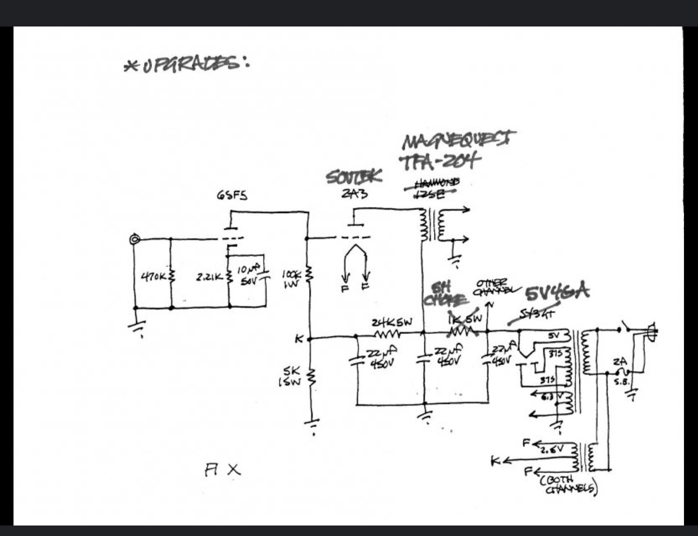

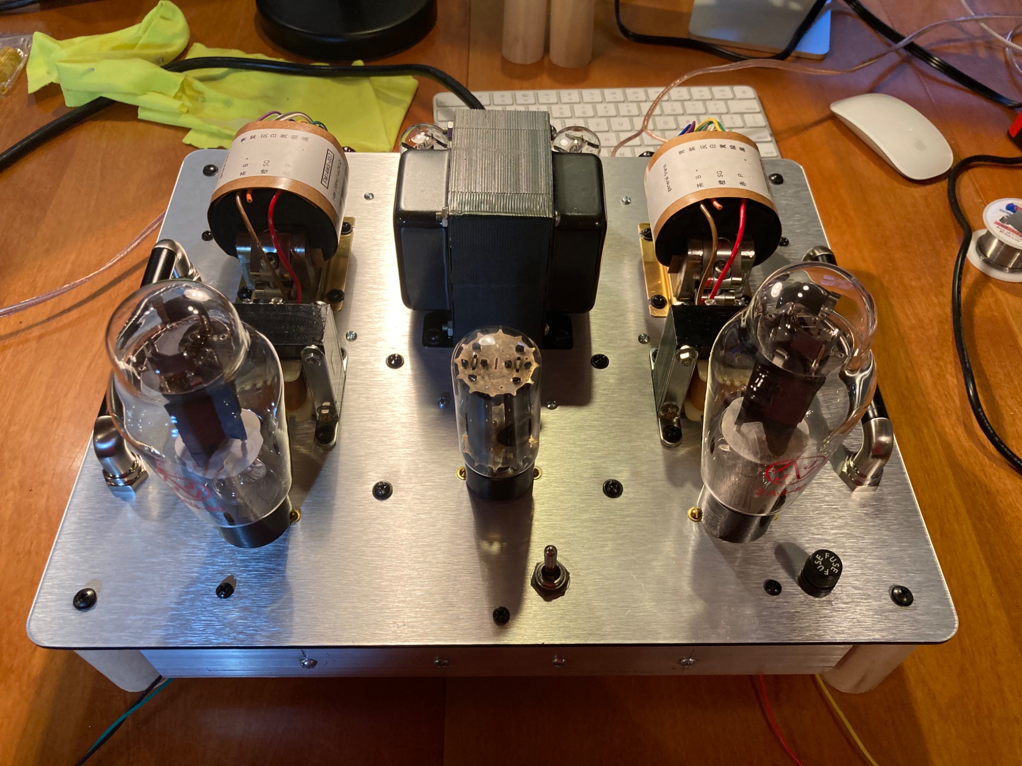

Hey Joseph, thanks for your input! I had a fi X years ago that needed some trouble shooting and Don was kind enough to send me the schematic with voltages so I could do the repairs. The X was pretty much the R&L design I believe. He also granted me permission to build one for myself. I built up a mono breadboard like 15 years ago and I finally built my stereo version last summer. Here’s my Bolerosteins.

Hi Dan, I think you've left a comment(s?) in my blog.🙂
Nice custom Finemets + your chassis captures the essence of Don's Fi 2A3 stereo amp.👏
I'm not surprised that you've had much better luck driving your RCA LC1s with the Fi/R&L derived amp since those thrive on low damping factor. IME, similar speaker/cabinet designs from the 50s by Altec/Jensen/RCA get choked by amps with lots of NFB.

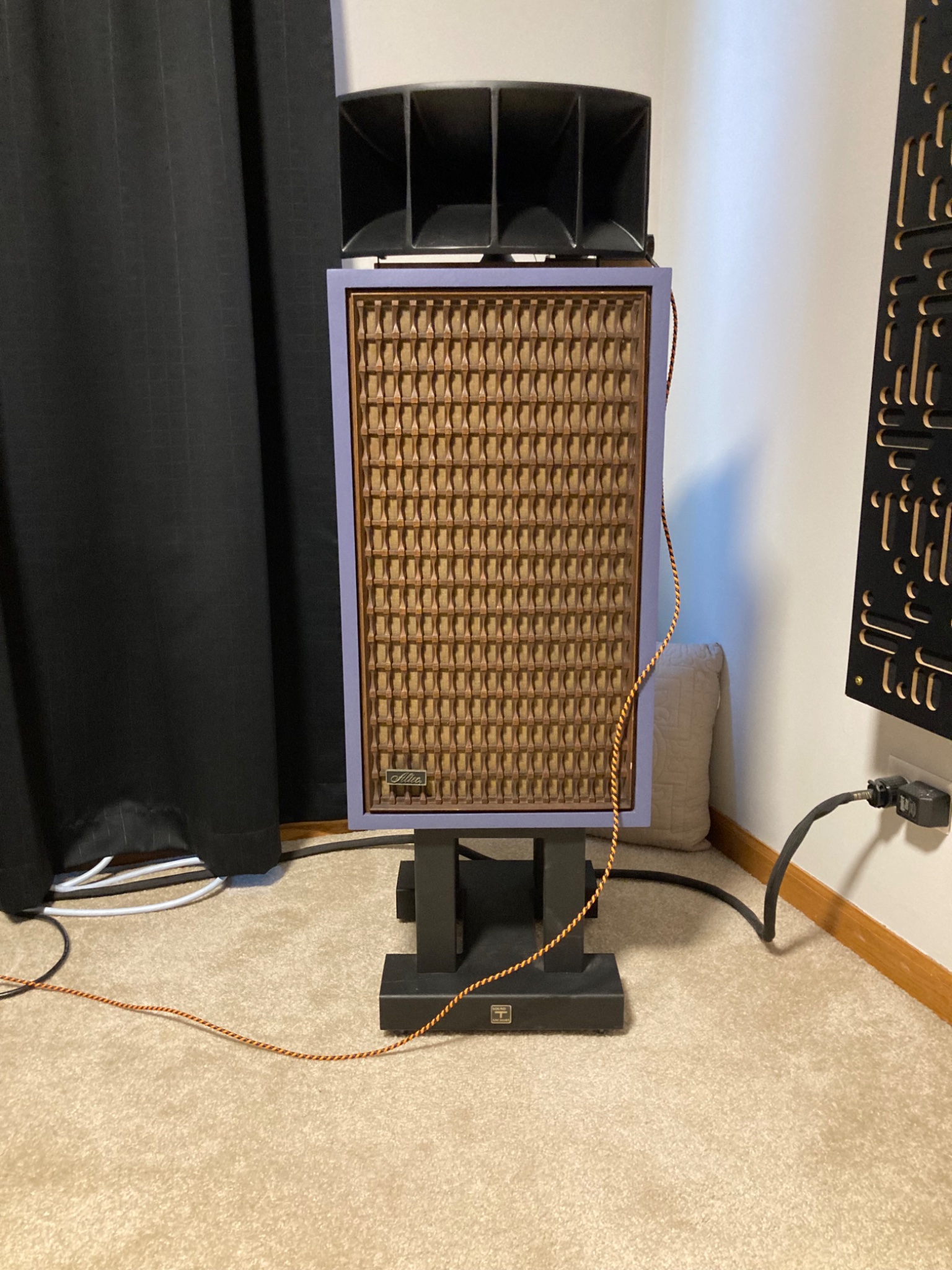

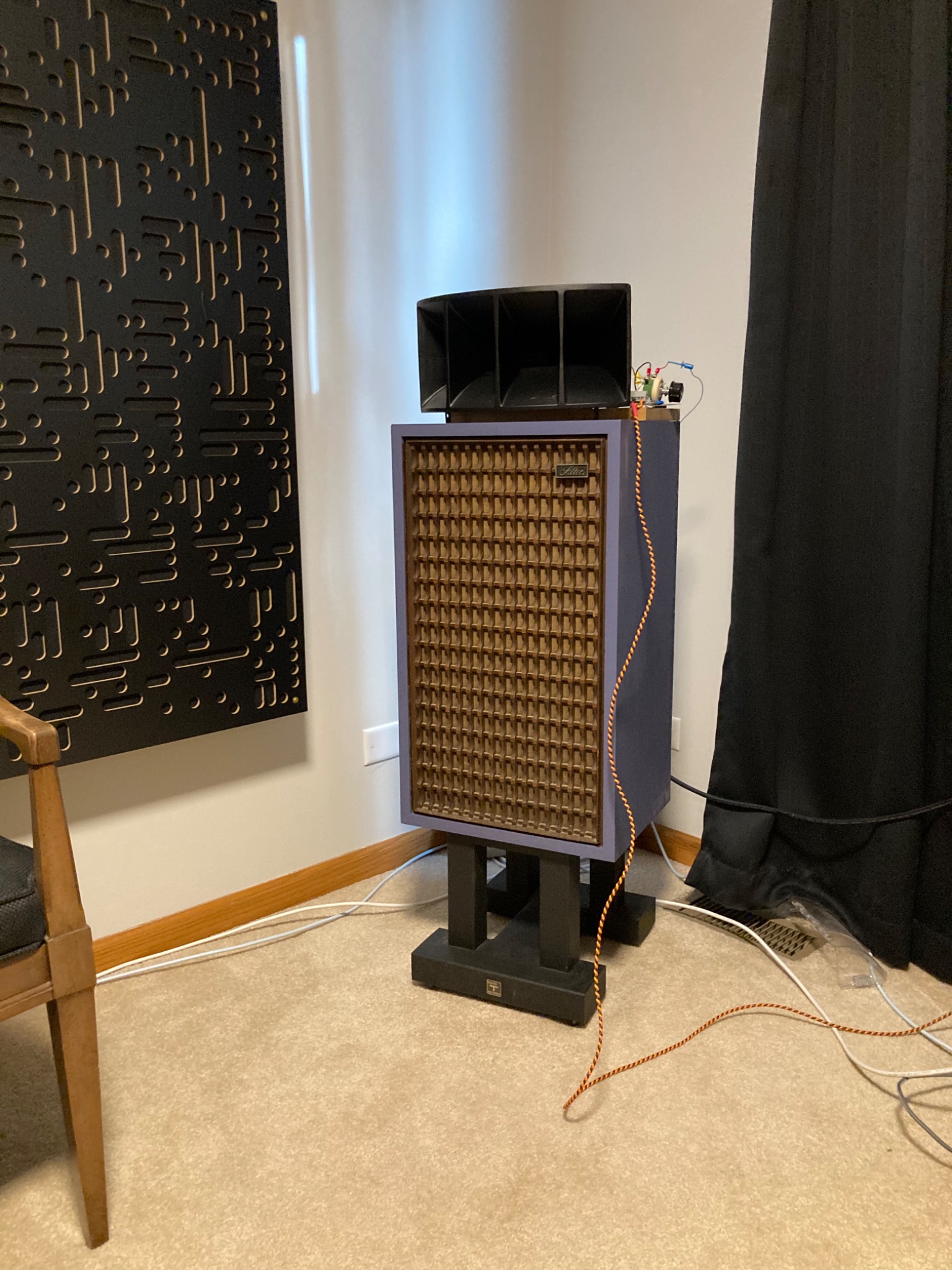

BTW, what driver are you using with the Stein horns?
The ST-35 is a very good amp! Good to keep around for a spare. The driver is a 802D with the Russian paper diaphragm. I’m really not married to the Bolero cabinet there are options as you know. Are you going to post the R&L DC2A3 outcome on your site?
