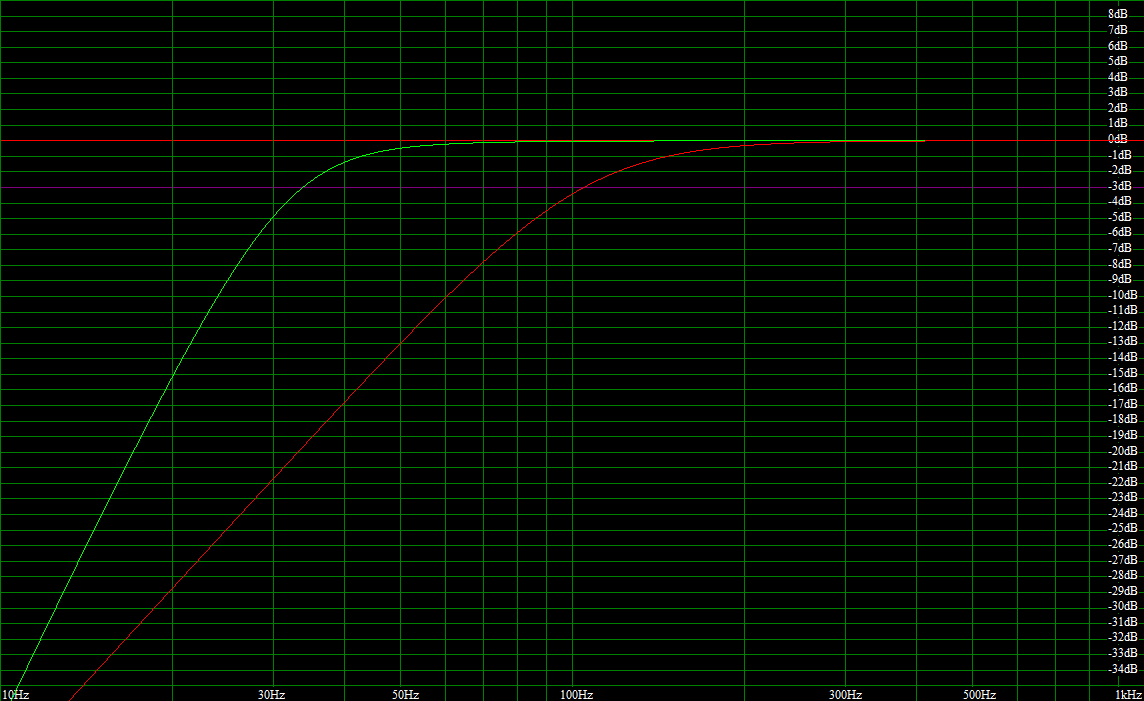

I have a pair of Mark Audio A12s, I want to add a set of mid-bass modules in a ported enclosure. That is all well and good but I don't want to lose my 100% analog signal path. Is the dvx or similar active crossover a good approach to go?
Any recommendations?
Bi-Amp: Yes, I want to pull the low frequency workload off of my primary amp which only has 4 watts. It is a Decware Mini Torii.
So essentially the Mini Torii would power the Mark Audios from 150 up and then a different power amp to power the woofers.
I was thinking of these: Dayton Audio RS180-4 7" Reference Woofer 4 Ohm | 295-374
The woofers would be in a 1.33 ft.3 rear ported enclosure and should reach 35 @ -3 dB. They have a very smooth curve and it should and remain flat.
Then the Marks would be moved out of the Super Pensils to an 8 liter sealed enclosure which will hit 100 Hz @ -3 dB.
Essentially I imagine these looking as if they are a single cabinet but in reality they are two separate enclosures. The reason for the XO is because I want to be able to adjust the setup and relieve the tube amp from the low freq duties. The main reason for this is a XO would rob what little power I have going to the speakers.
Currently looking at this Active XO: Ashly XR1001 | Sweetwater.com
what sort of amp are you thinking for the sub?
I am open to options for the amp to power the woofers, ideally something clean and powerful but my Mini Torii is doing most of the heavy lifting and providing most of the voice characteristics of the frequency range.
I just need the bass extension. I am not listening to hard rock or anything crazy here just some Jazz, Blues, and occasional Van Morrison/Neil Young etc.
I was thinking about the Dayton APA150 or similar, 75 WPC @ 4 ohms.
the Mini Torii doesn't seem to have balanced inputs so wiring in a dbx driverack on both the input and output side is gonna mean some cable building.
what are you using for source switching?
The MT has two inputs, it is a pre-amp and power amp setup as dual mono blocks.
You are correct, no balanced inputs, just single ended RCA jacks.
I was thinking of this cabling...
Turntable -> Pre-Amp -> XO >100 HZ -> MT -> A12p
-> XO <100 HZ -> ?AMP -> Woofers
Is that an improper assumption?
The easier option is to use the pre-outs on my Mini Torii and just send that to powered woofers or woofers that have a passive XO.
Pros: Much Simpler, Cheaper
Cons: Still sending 100% of the signal to the Mark Audio A12s
Thoughts on the two options?
