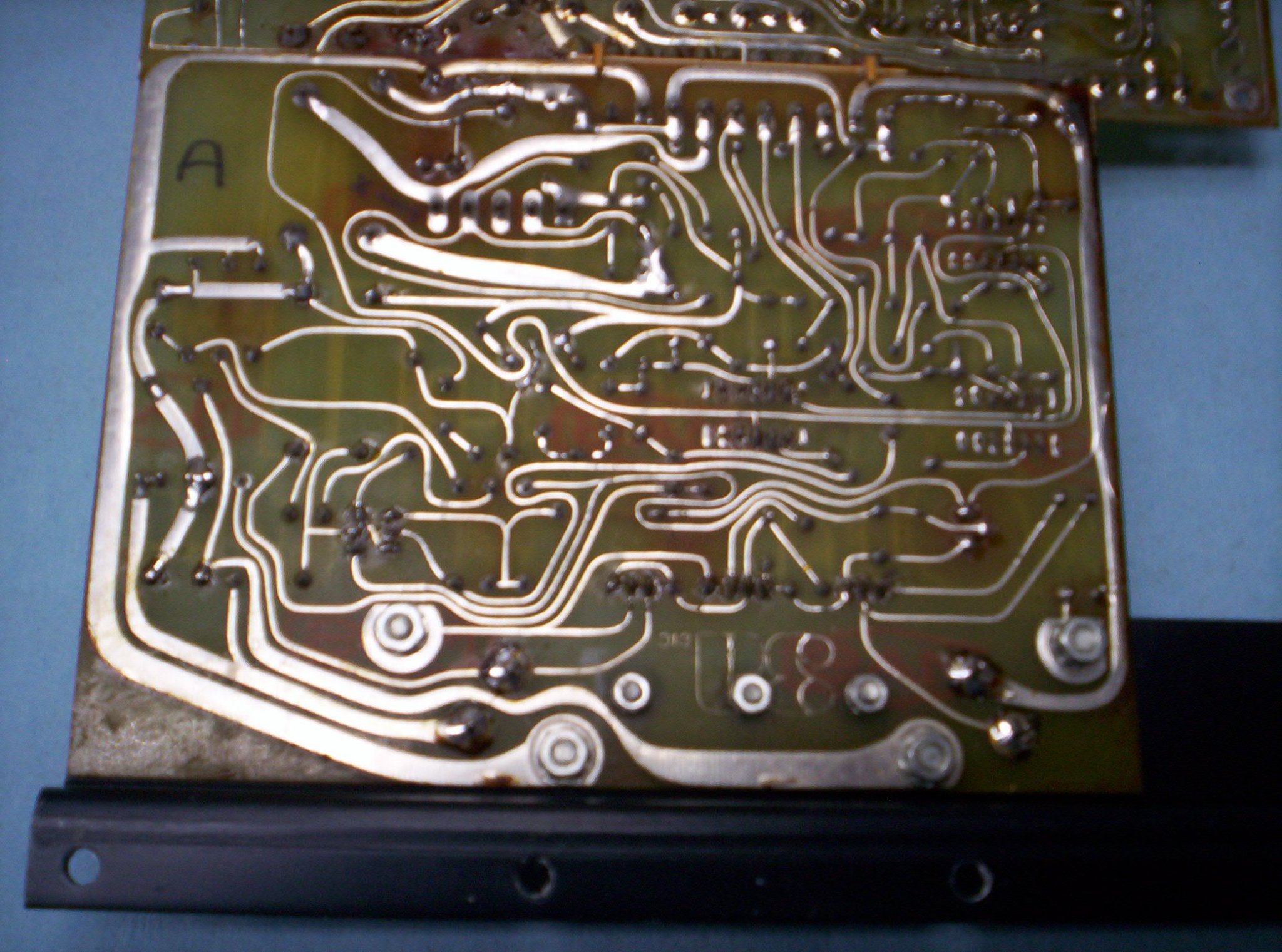

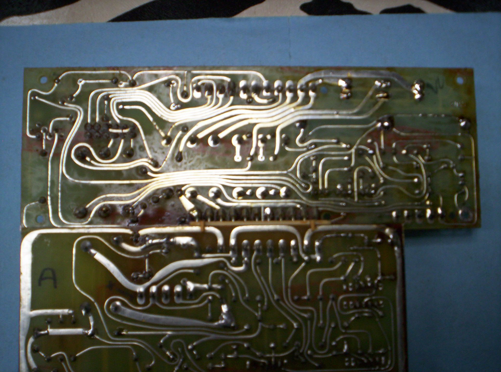

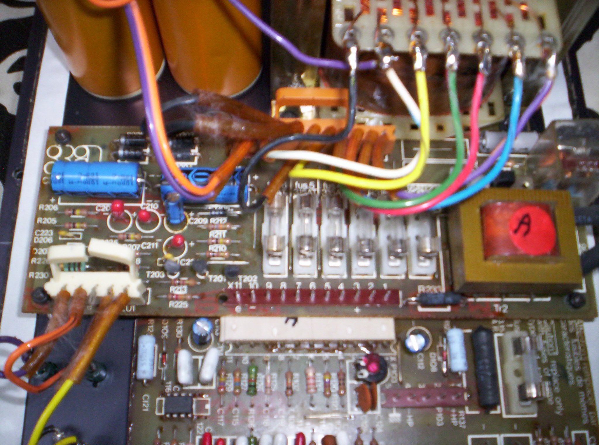

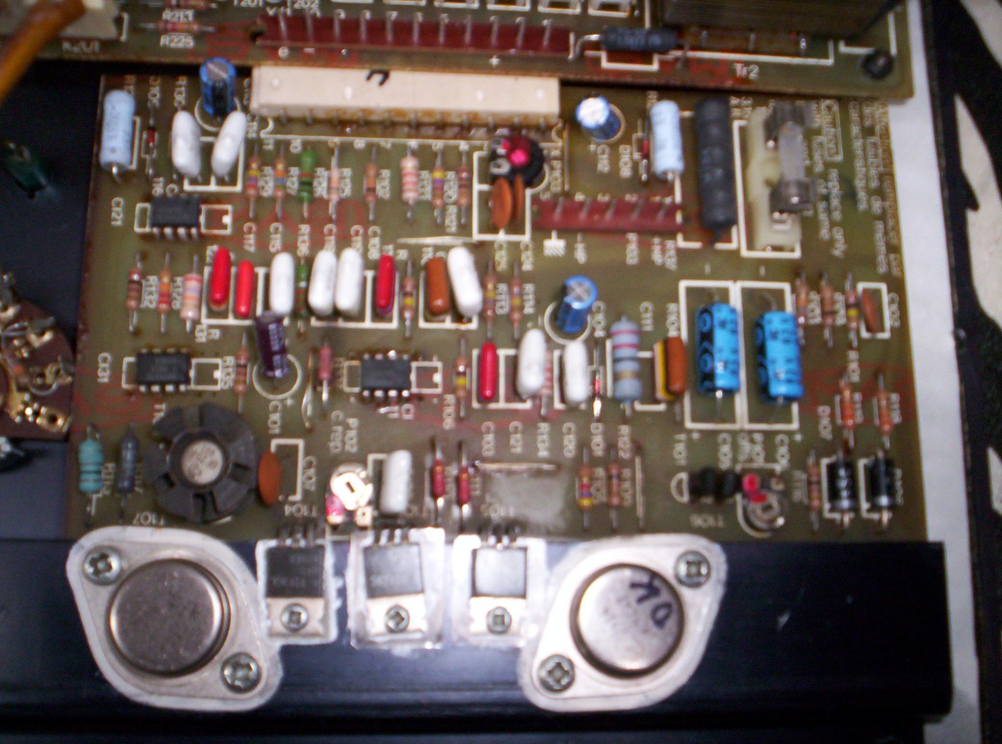

DBT glowing a lil longer then usual when turning on a servo amp...
Here are the boards pictures;
I've tested the 2 TO-3's; all ok
Tested: TO-220's T-104, 105 and 108 all ok
tested; T-107; ok
diodes; D-202 and D204, ok.
I tried adjusting Bias using P-102 (C. Rep), and fuses #3 and 4 burned right away (they are 1.15amps each).
Amplifier is now a short, on my dim bulb tester...

Blurry and/or dark photos, no schematic, no information concerning supply and output voltages and currents, you might as well try to troubleshoot with a wet finger and in complete darkness .
It's not for nothing that nobody looked into this case.
It could well be due to an excessive bias setting, though there are many more faults which can also cause abnormally high loads on the power supply. Since you already recapped it, it does seems likely that there was a deeper existing problem or perhaps you've just done some things wrong in that recapping process - maybe a reversed cap? a poor solder joint or a short caused there, perhaps higher capacitance combined with low ESR which blows the fuses?
It's also likely that a previous owner has already fiddled with anything and everything adjustable to try their luck at fixing problems too. That's not unusual behaviour but there are so many issues that you can only trace by wise measurements but now, the fuses will need replacing anyway. If they are quick blowing types, its usually obvious by being somewhat more complex than a simple, tinned wire inside. Generally, there will be an additional code letter added to the stamped marking on the end caps to make it clear. There are wikis on this topic - e.g. https://www.swe-check.com.au/pages/learn_fuse_markings.php)
