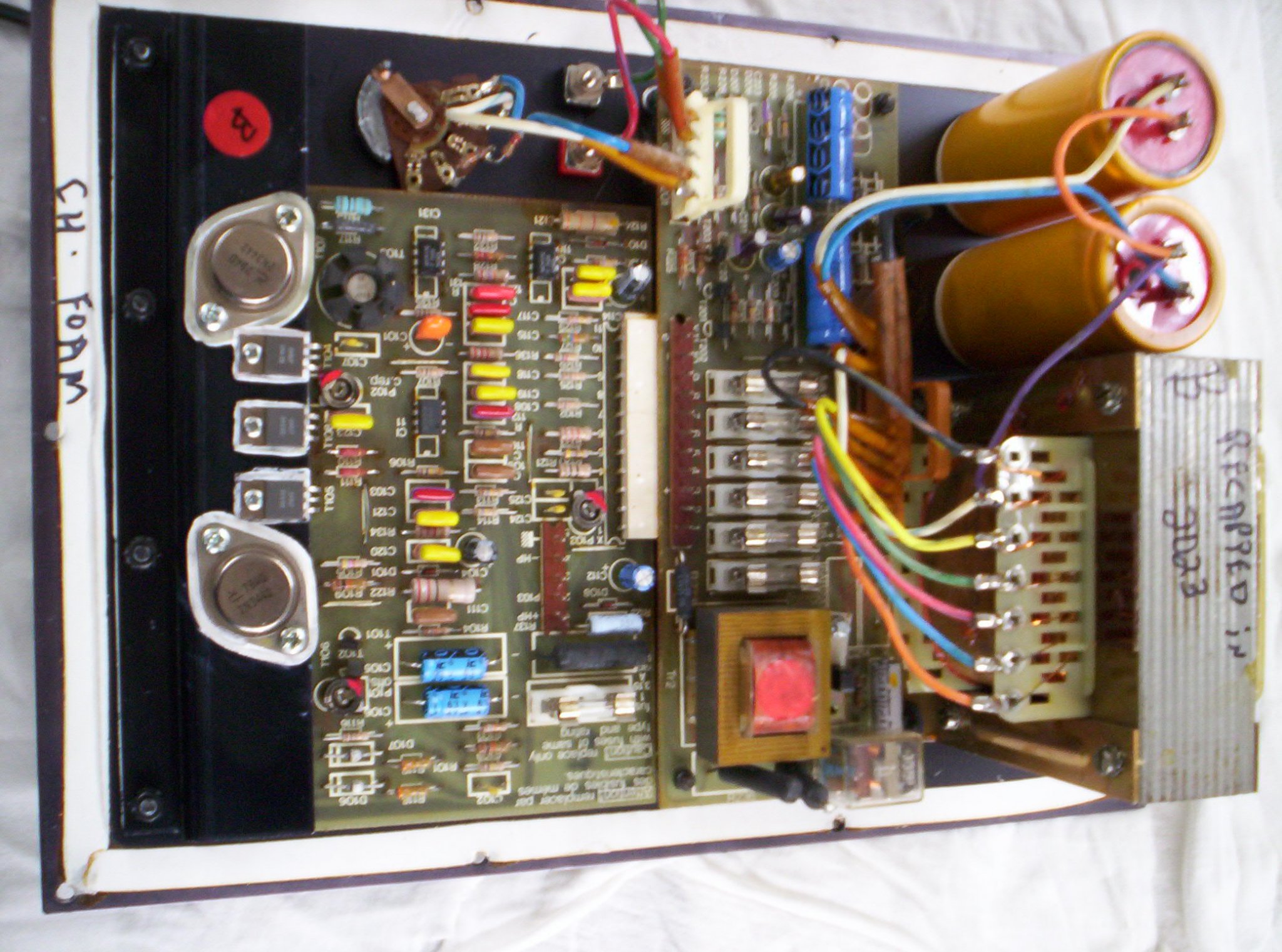

I am working on a pair of 3A Andantes Master Control servo controlled, woofer amps, that needed love.
Bought these loudspeaker as "non working amps". Recapped and changed a few cooked resistors and i.c's
. At first, both amps were doing fine but one of them is starting to act weird on my DBT. The bulb glows
longer then all of the amps i've tested; like 3 to 4 seconds before dimming back to normal...
The other amp, behaves normaly, like the normal charging of the main supply caps, on initial turn-on.
The "defective" amp also has a slight buzz in the woofer, while the bulb glows abnormally long. The amp works normal
it seems, after initial turn-on. Those loudspeakers have a auto-turn-on like a modern subwoofer.
I am going to check DC offset and compare the 2 amps on my scope, using a audio generator.
What could cause an abnormaly long DBT glow on turn-on???.
Pulle all the transistors and diode and tested them on my Peak tester, all OK...
I've tried to find one but, no avail. I have a "in between series" version. There are 7 (seven) fuses in one amp!!!.

I've excerpted the most concerning phrase--- it sounds like one amp was working well but then began to act weird, i.e. it deteriorated?
My conjecture is that variation among amplifiers could easily result in differing settling times. An amp with low initial offset at its input differential pair would settle very quickly since there's little error for the servo to correct. An amp with large initial offset will take longer.
Perhaps when the amp is burdened with the DBT it takes longer to reach equilibrium. I imagine these quirks will evident on your scope. If the problematic amp has larger output on its error amp re the other amp, that would be supportive of my pet theory.

2N3442, 140V, 10A, 117W, Ft = 80kHz, said to be used in audio amps among other applications.
Out of production at the OEM, Multicomp Taiwan does make them, element14 has them available here in India. There could be other makers also.
Please check and compare both amps, should not be difficult to trace, even a bad pot could be the cause.
If i could find the schematics for these! 🙁 . I have no idea where would be the emiter resistors, to measure the bias. There is a DC Offset pot, clearly identified on the board, and 2 other un-clear pots. One has to do with the servo to woofer calibration.
Bias adjustment:
settings on potentiometer R13 (100 ohms)
measures 8mV on terminals 2 and 3 of the "Y" connector.
Setting the midpoint of the power supply (1/2T)
measurement on postive terminal of C9 and adjustment with r11 (220 ohms).
My amp is different, i have: P-101, 102 and P-103... P-101 is DC offset and i did successfully adjust it to nesa zero millivolts. I also adjusted P-103, to match both amps output levels, on my oscilloscope. So; P102 would be my Bias?. It is called " c. Rep" on my amps boards...
