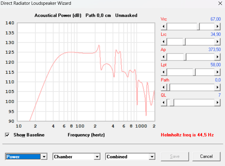

To fully use a good class D +900w amp i own with the DSP and averything already set, i'd like to build a new compact subwoofer with 2 4ohm drivers. I tried to find some 15" 2ohm or 4+4 or 1+1ohm drivers but i haven't found any with the good characteristics yet (at a good price at least).
The best i have made with decently priced drivers is with 2 fountek fw322-4. I've tried a simulation with many different types of enclosures and the DBR (double bass reflex) enclosure showed interesting results (serie-tuned 6th order bandpass boxes were showing good results too but i couldn't fit the 2 drivers correctly without making some very weird abstract architecture designs).
The problem is that the results in hornresp seem weird as the first port was giving better results when larger and shorter - so it could become just like part of the inner walls of the enclosure (and then become like a simple bass reflex).
I have found a way to have a good result with a smaller port but i still have some doubts if my enclosure plans would be corresponding to the hornresp simulation as changing the first port size a little makes the result seem incoherent.
Would the first port really act like a port or just like the continuity of the first chamber ?
(The two drivers are on each side and the second port is on the front of the speaker, maybe it'll cause some issues but i'd like to know if this enclosure would work like a double bass reflex first)

First (interior) port probably only acts as helmholtz resonator at quite high frequency.
Nested helmholtz resonators are complex because nothing can be seen as isolated. I suppose you will have to build a test enclosure after simulating with hornresp to get exact results.

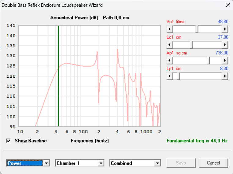

What is impressive is the difference between a BR and a DBR (BR has a slightly larger internal volume):

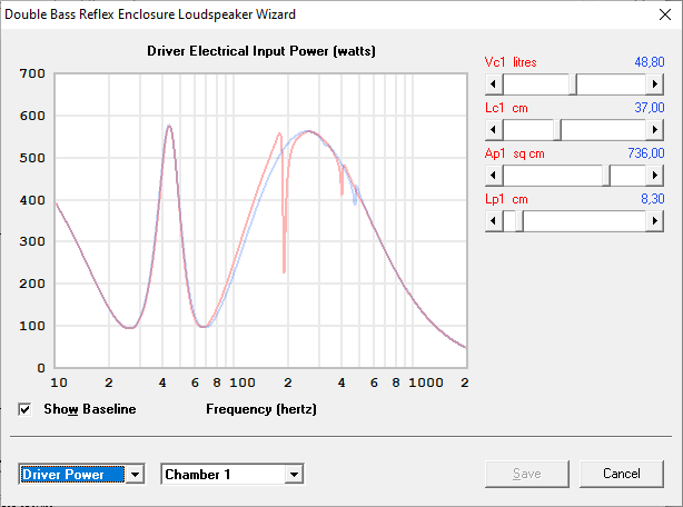

The driver power graph also shows almost 100w more with the DBR at tuning frequency than with the BR (same voltage).
But now i'm thinking about a potential hornresp issue as the driver movement is at 0 on the displacement graph at tuning frequency with the DBR enclosure (instead of 2-3mm with other designs).

At a glance, DBR should have same net Vb as BR and all three ports are the same, so seems like a good place to at least start 😉: https://www.diyaudio.com/community/threads/dcr-double-chamber-reflex.362387/
Not sure i understand. Isn't DBR the 2 ports design ? The 3 ports design is an aperiodic bi-chamber right ?

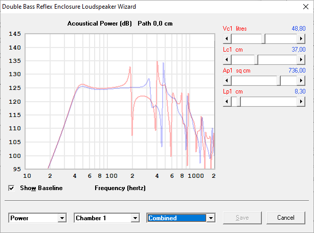

I tried to simulate a (lossless) bass reflex alignment (blue) to match the DBR box (red):
the main differences here are above 150 Hz, probably (and preferrably, for DBR) outside the usable bandwith.
my bass reflex simulation uses the same total volume as your DBR box (72,5 liters) but a longer port (37 cm lenght, 269 cm2 cross section).
here is the driver power for BR (blue) and DBR (red):
as I wrote above: I would rather use a bass reflex alignment unless there is a big benefit from DBR (which is not the case now, the response is quite uneven).
also keep in mind that the DBR wizard is not entirely realistic as it does not account for losses.
