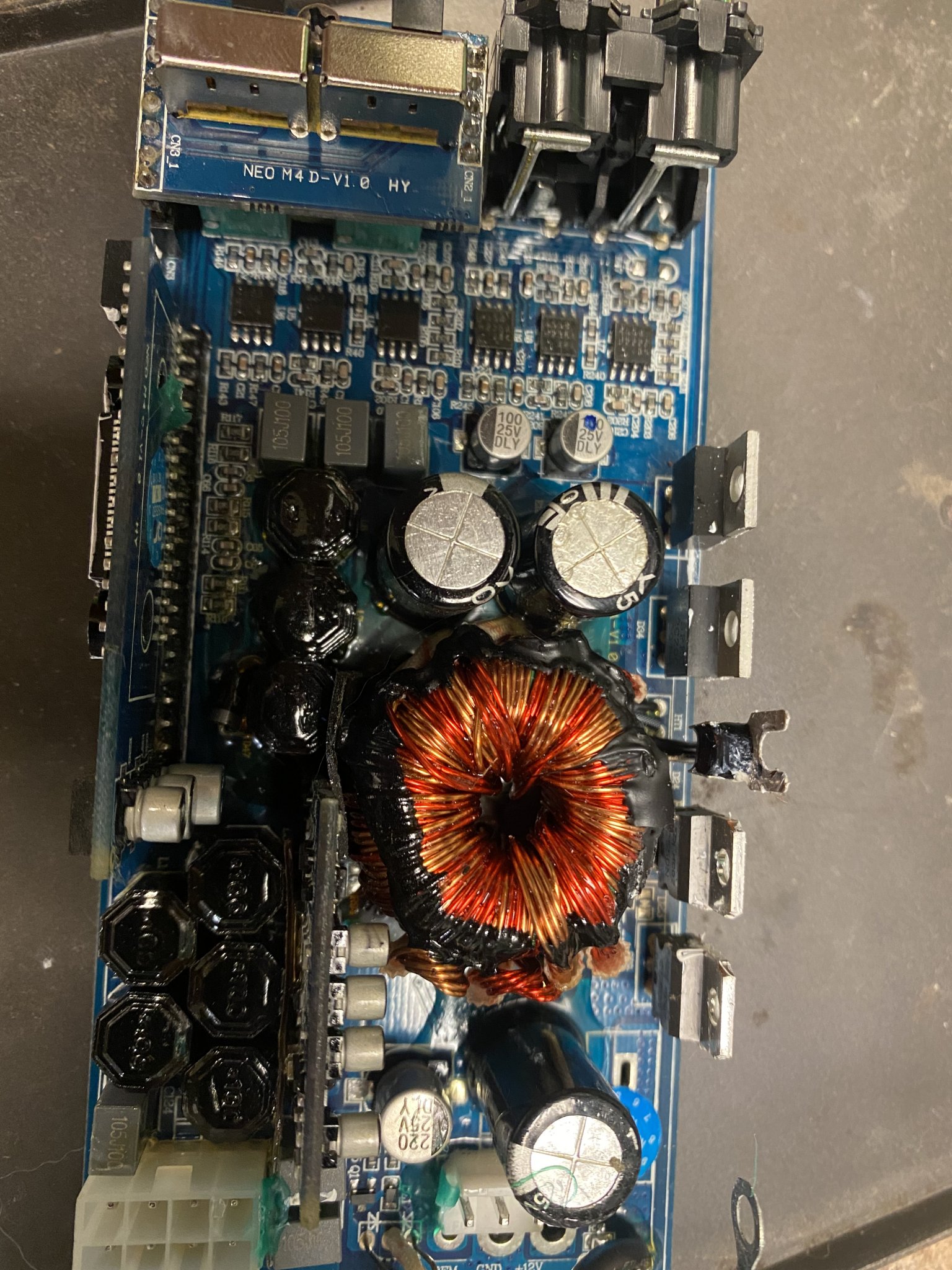

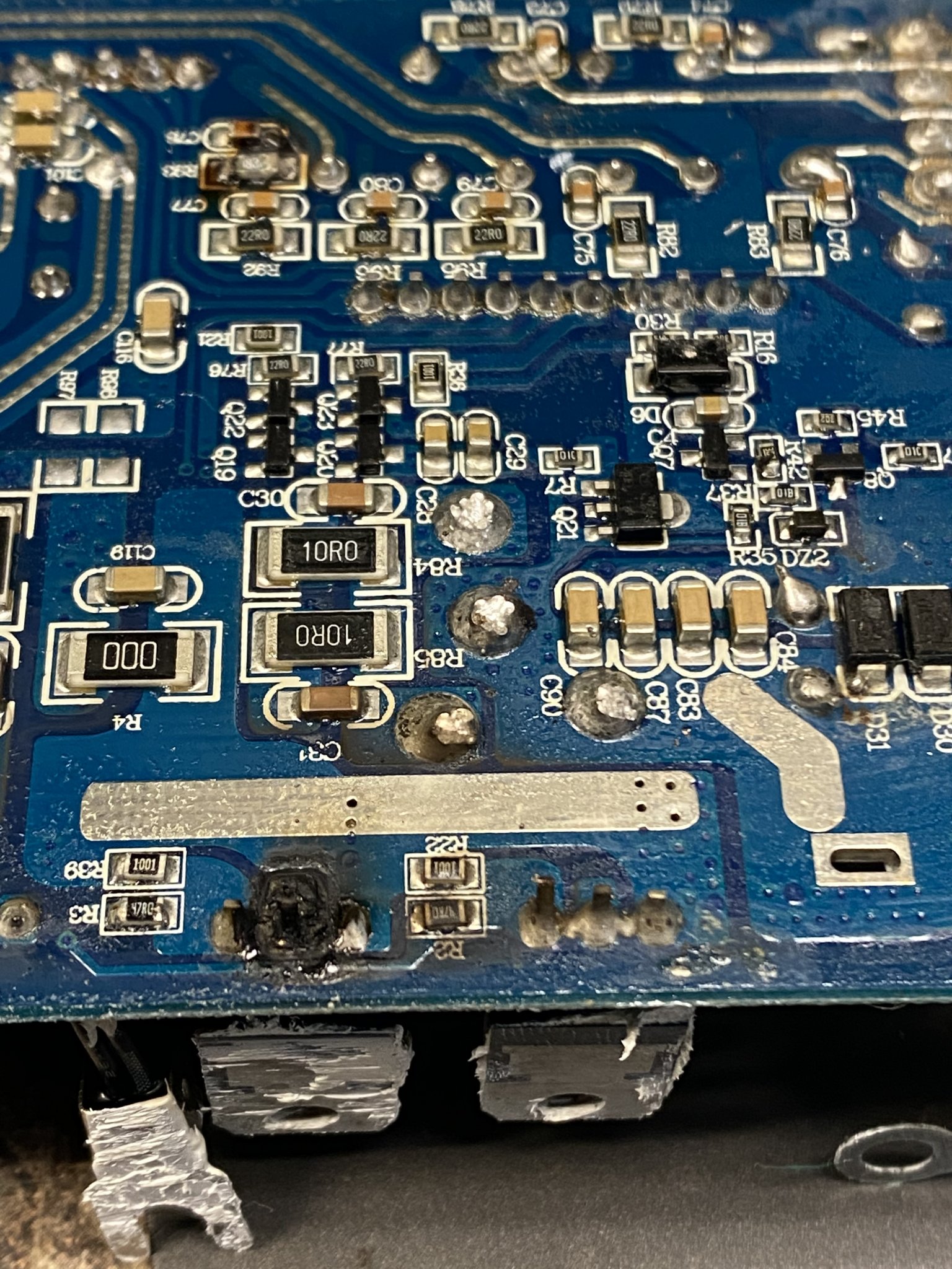

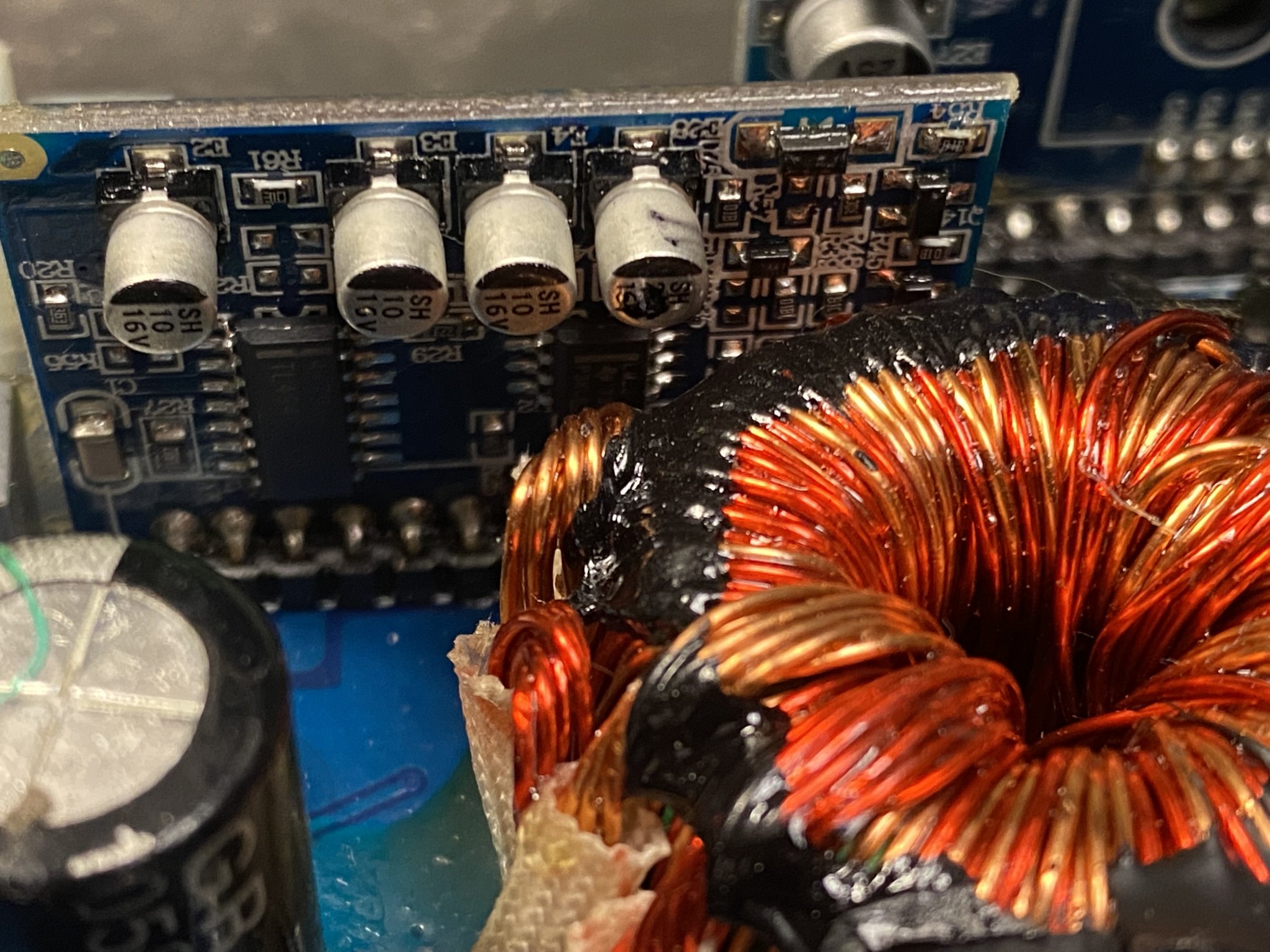

Amp has a few issues with it .
First off the power supply fets are burnt .
The amp has 47 ohm gate resistors for the power supply fets .
The fets are marked CS50N
Anyone know what fets I can replace these with ?

CS50N06
https://pdf1.alldatasheet.com/datasheet-pdf/view/998990/THINKISEMI/CS50N06.html
They are equivalent to a Z44. That or better will work.

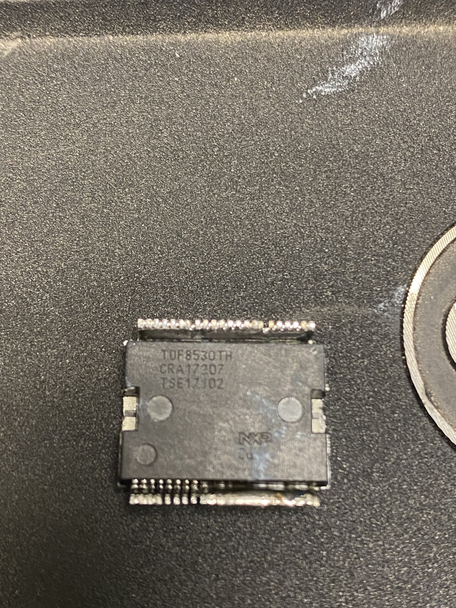

I’m assuming this IC controls the output stage .
Not sure if this ic is defective or not kinda leaning towards it being defective since I have a couple 22 ohm resistors burnt .
I will have to desolder it and check to see if it has a part number .
I believe it’s defective since the amp will power up for a second or 2 then go into protection
