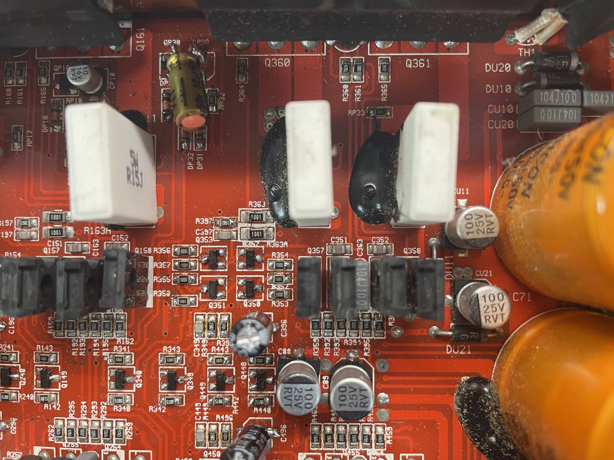

DB Drive DKUR A7M 100.4 Channel 3 very loud
This amp is mostly working. All 4 channels are operating, except Channel 3 is much louder than the other 3 channels. Pre-amp signal amplitude is the same for all 4x channels, but output at terminals for CH3 is about twice as loud as CH1/2/4. Otherwise the amp reaches clipping points and has passed most tests other than CH3 being increased beyond CH1/2/4. All 4 channels clip at the same amplitude, just CH3 clips much sooner than the others - IE with lower input signal.
I think there is something going on with the feedback section of this amp, but not really sure where to look exactly?
R350 left side in from ch3 preamp.
There is typically a voltage divider that goes from the speaker output (near the output transistors) to ground via an electrolytic capacitor. The center-tap of the resistors goes to the inverting input of the differential amplifier. I'd suspect that one of the resistors is out of tolerance.
