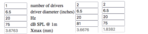

75dB SPL @ 20Hz could be achieved with a 6.5" driver with about 3.7mm Xmax.

In a sealed cabinet, SPL is simply related to excursion and Sd (cone area).
Doubling equally powered (same voltage applied to both) drivers in double the cabinet volume adds +6dB SPL.
Two drivers can produce the same low frequency SPL as one with half the excursion.
Four times the excursion is required for the same SPL for each octave drop, 40Hz to 20Hz.

Maybe I wasn't clear. The set up gives F3 at ~40Hz. 20Hz is ~20dB down. This with the usual 2.83 vrms drive.75dB SPL @ 20Hz could be achieved with a 6.5" driver with about 3.7mm Xmax.
I have a plot of max SPL / max power which is limited by Xmax. At 20Hz this relates to an spl output of ~75dB. It's about 95dB at 40Hz which I think will be ok. So say a signal from the amp wants 95dB at 40Hz. Fine but if that happens at 20Hz whoops.

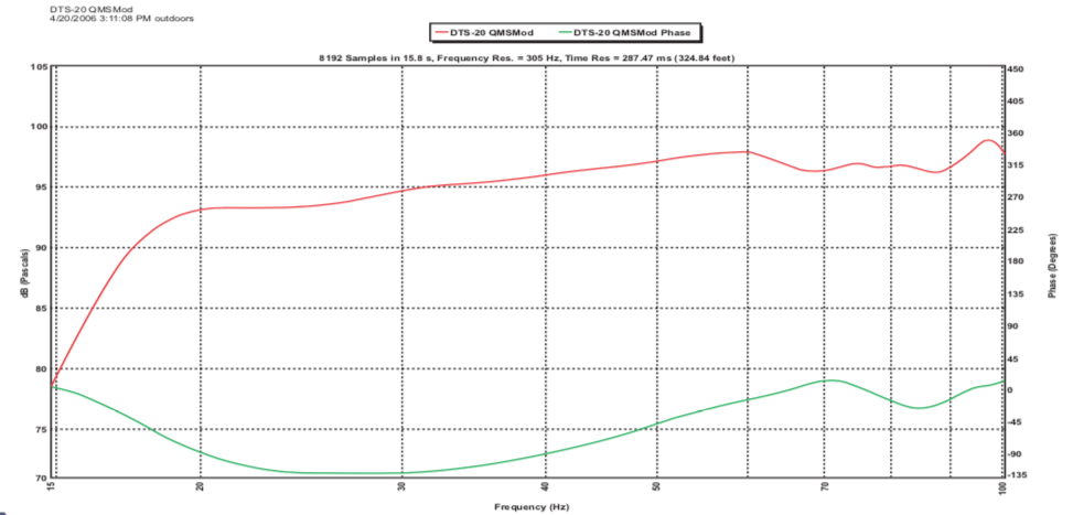

A speaker with 70dB sensitivity at 20 Hz would require 1000 watts to produce 100dB SPL.It's a tricky area for someone who wants to get their feet wet for the first time in this area. I read for instance that 100 and something dB at 20Hz needs 1kw of amp.
A large tapped horn subwoofer like the DSL DTS-20 has about 93dB sensitivity (half space, outdoors) down that low, using about 4 watts (5.65 volts) to produce 100dB SPL at 20Hz.
