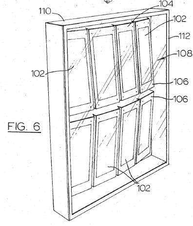

As mentioned above, the SF6 confers certain advantages in power and range but you need to enclose the drivers in the sealing membranes. OK if your ambition is theatre sound. With the bias set lower, no special advantages for domestic music-making without the gas. He sold me quite a bunch of drivers and I've had ecstatic happiness with 8 of the panels mounted in something that looks like a big curved window frame, for each channel. Someday I'll make a wall-of-sound with all my panels... when I figure out how to handle the rear wave.

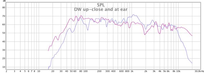

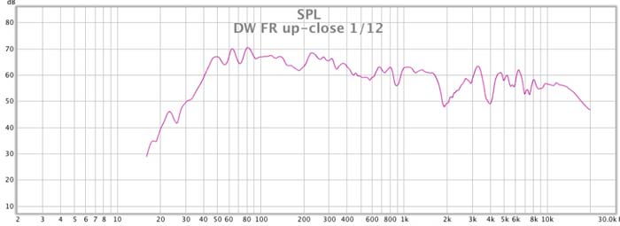

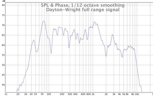

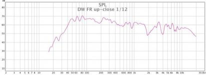

DATA POINT
When a single DW cell (XG-8 series) is tested in "free" air, the output has a peak around 150 Hz. But with an XG-10 speaker (fairly similar cells) with 35 year old SF-6 gas charge that's never been re-charged, the resonance is around 60 Hz.
Not super low, but it should impress a lot of people who dismiss the possibility of getting crystal clear sound from an ESL as well as ESL bass range down to maybe 45 Hz. (Not sure what is means, but REW seems to show more harmonic distortion at the low end; maybe real or maybe artefactual.)
Ben
From the Ooooops Department:DATA POINT
Ben
From my re-reading of the DW website, it sounds like XG-10 cells have a substantially larger membrane area because they don't have the centre beam bisecting the membrane down the middle of the long dimension, like in the XG-8 cells.
My data above remains factual: the later generation XG-10 with gas shows a resonance measured by mic about 60 Hz; the XG-8 cell in air at about 150 Hz.
Since I only have XG-10 cells in gas and XG-8 cells in air, not sure if I can provide much helpful data on the effect of the SF6 gas.
Ben
