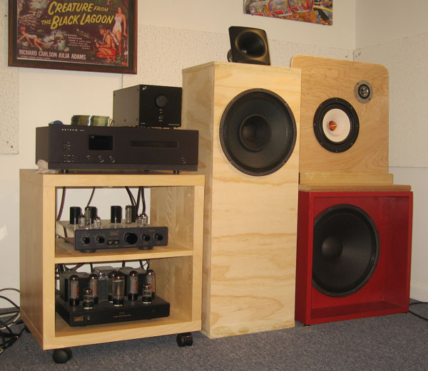

95+db Woofer is easy to find if you use Pro drivers. Check out my "S15" Econowave build. The JBL is only $12 or so.

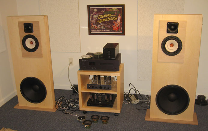

I used the Dayton 12" WG for a couple years. I had the Selenium, JBL, and B&C drivers. I liked it best with the JBL LE-85 driver. I've also built 4 sets of EconoWaves over on AudioKarma. I think the Dayton round 12" is as good as the JBL, Pyle, or QSC wave guides.

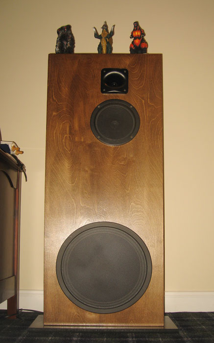

I use the two smallest Dayton waveguides (not the larger round ones) and love them for home use. In fact, i think they are too small for all but the smallest pro applications. I've use inexpensive Eminence, Pyle and piezo's with them all to good effect. Depending on the speaker design you go with any of the round waveguides will probably sound great in a home setup. The best size used depends on the approximate crossover point.

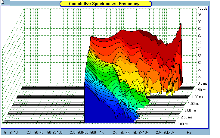

Won't argue that measurement but the CSD (not the one you posted, Augerpro's showed better details) for the D220 is horrible and all my listening tests on using the D220 with the Dayton or Pyle horns just made me cringe. Worst CD I own (I own 5 brands).

The stored energy in the D220 happens all over the place on the CSD plot.

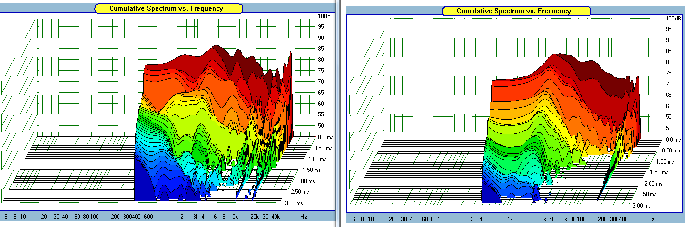

Here is the D220 vs Celestion 1425
Also here is the BMS4550 CSD...
Not only the measurements but playing each of them in backed up what the measurement said. The D220 sounded the worst out of all of them. Can that resonance be tamed?? I have no idea, I just didnt like the sound of them.
