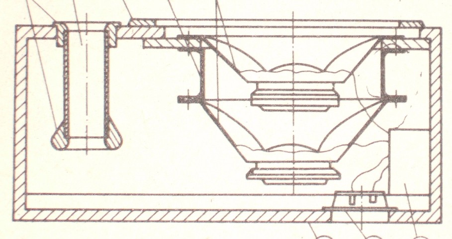

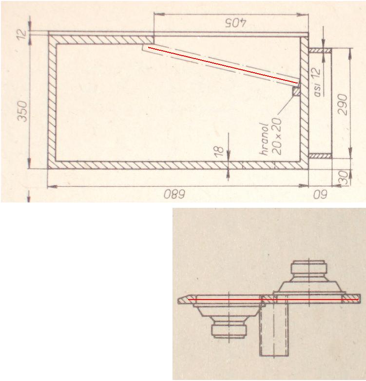

also have in mind to build it like this: closed box, one woof fireing inside second outside. This should provide less distortion. Don't know much about this... are there any info? can you link me something?

At the moment I think of 2x12" sub. I have photos of two designs. This is the one I was describing

My HT is a 5:0 set up with 3-way speakers instead of satellites and single central sub. The front stereo 3-ways are ideal for stereo listening, and having two woofers breaks up the room modes more than one sub. If you cross satellites to a sub above 60 Hz you start to lose some stereo imaging information.
You may want to read some of the posts comparing 3-way HT vs. satellite + sub.
