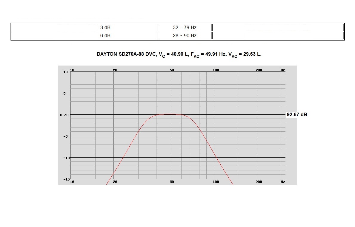

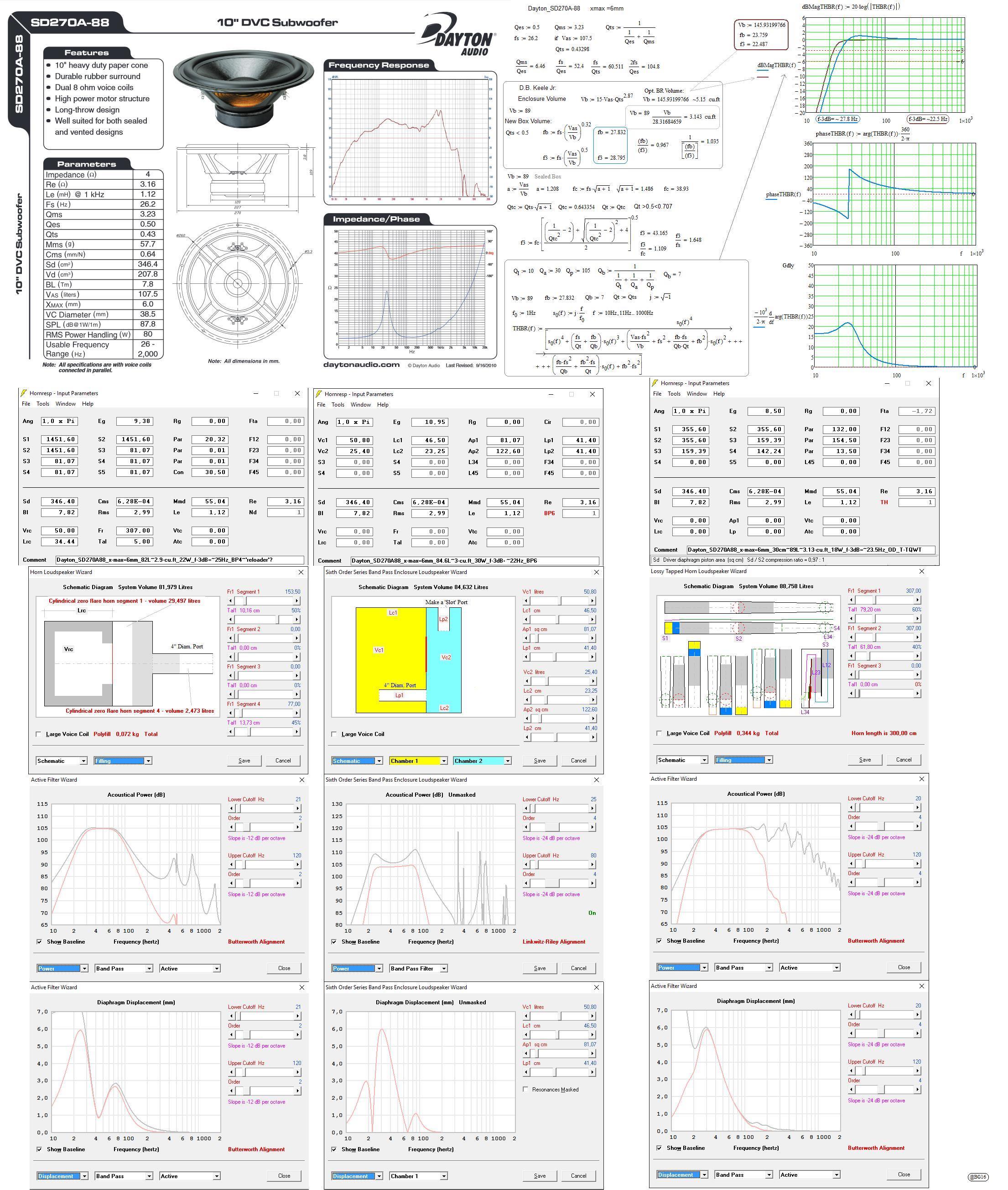

Shawn,
This would be the limit for a
4th order bandpass
6th order bandpass
Obvious that a tuning of 12Hz (), on the 6.order, will give a very lengthly port. So I would go with a more manageable frequency, 15Hz or 16Hz and up, the extension being affected but the port being short. The 4.order looks like a clean alternative, not doing infra-sound.
Hey sorry, I was away for a few days. Looking at this info it seems like the Dayton in a 4th order bandpass doesn't go too low before -3db. Can boosting with eq make up for this or is that looking for trouble?
Maybe I should back up a bit and ask..
Using either sealed for 4th order. What is the best way for me to cover 100hz down?
I only have access to budget drivers from Solen.ca and a pair of Seas P21RE.
Ok, it's making more sense to me now. I was intimidated by everything.
The 4th order looks good. I would be plenty happy with that performance.
For building it, do I just have to follow the volume of each chamber? or should certain boundary lengths be observed?
Thanks for modelling that for me!
Shawn
