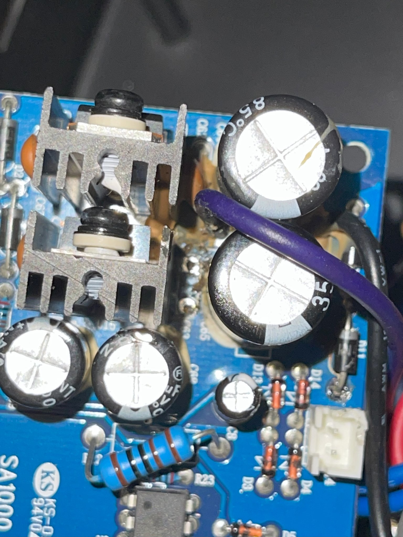

What a timely thread. My Dayton Audio SA 1000 amp is not putting hardly any thing out.
I can turn the volume up all the way and I can just feel a little vibration if I put my hand on the woofer suround.

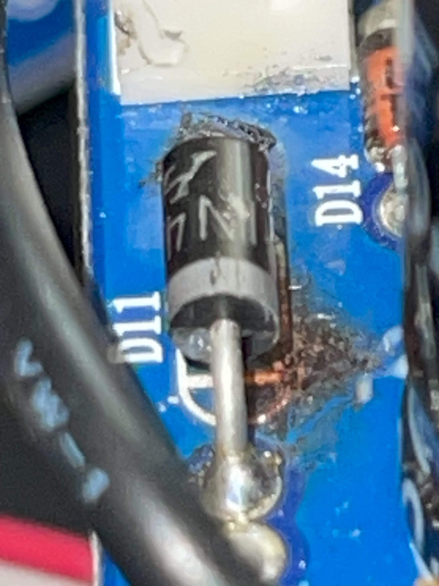

I took the lid off and I can see little bits of splatter on a connector by D11. I`ll try and post pictures.
The device at D11 looks shot. One of the larger caps is kind of loose and there looks to be some debris down in there.
If someone can tell me what that is at D11 I`ll order one and change out the two larger caps too.
Any help would be great.

Length & diameter determine if it is half watt like a 1n4004 or bigger like a diodes.inc A6. A6 also has fatter leads.
Whether it has .7 v drop like 1n4004 or 0.3 like MBR1100 schottky is up to you. Use diode scale of DVM and measure it or similar ones forwards.
On second thought in 1st picture appears to be no bigger than 1n4148 D14. Zeners are usually grey or brown, so could be schottky. If those are switcher nfets below & to left, most surely schottky. If mains voltage gets in there, make PIV 400 v. No lower PIV than the two big caps voltage rating below.
You have to measure the voltage drop with diode scale of DVM. Then measure body size and diameter. Choices are in post 6.
Ok...I don`t have the tools nor know how to do that.
Probably easier to send the board off somewhere , it`s only the size of an index card and would easily fit in a small padded envelope.
Steve
