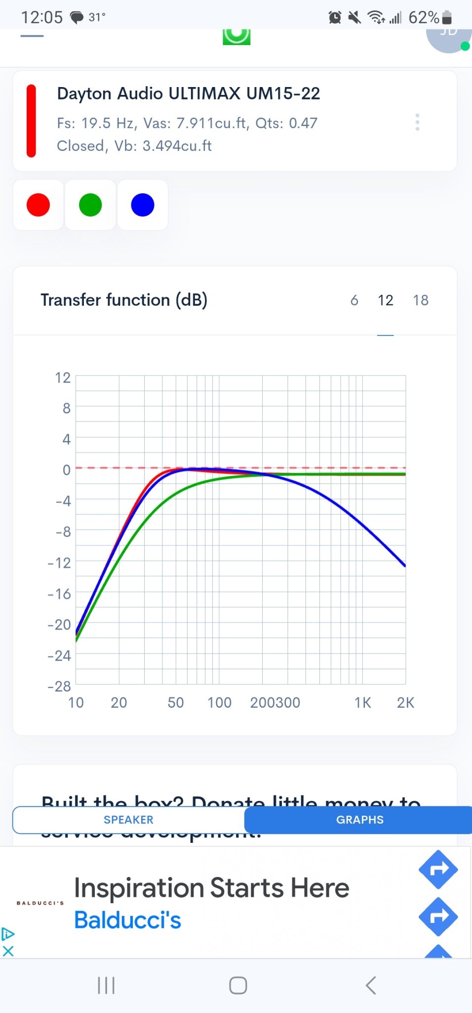

You can model some difference on SpeakerBoxLite.
20x20x20 box. .75" thick wood.
Red: Ultimax 15"
Green: HO 15
Blue: HF 15
Red: Ultimax 15"
Green: HO 15
Blue: HF 15

I don't know if I admit that any of them will produce sufficient spl for my usage if I shall use the one with the lowest Le...

I don't think I need that much output anyway. I am sure I don't actually. Would go with lower Le.
