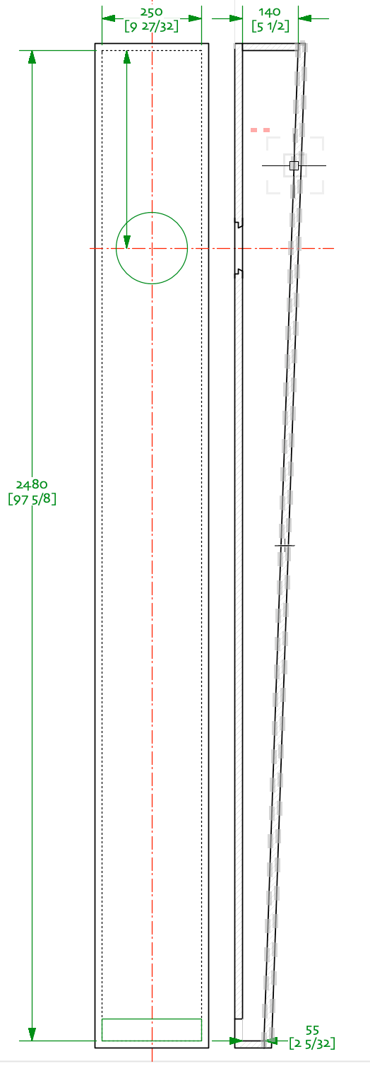

The foldings might look strange. These are just attemts to fit 95 inch evenly tapered into the given dimensions. I would be glad to see other suggestions.
The mouth at the bottom enhances bass better than at half hight. But what is better soundwise?
I hadn’t added anything before being pinged, since i hadn’t hadnalook atb whatb youare trying todo.
It looks like a stepped taper. What are the numbers?
You’d likeit to be 25 cm wide nd the total line is?
350cm² to 138cm², 248cm length. Zv seems to be atbthe end, what is Zd? Terminus area? That specifies an even taper but ll you lines seem to be stepped.
2.5m seems long.
dave
2.5m seems long.
dave
Looks far toomlong andn insufficient cross-section (just a guess from experience)
Looked at the sims, it doesn’t seem to go that low, and the impedance is strange.

You examined my last try which has indeed a very small starting cross section. So unfold as a long pipe this looks strange indeed.
The other tries start at 400cm which is not so much more.
If I remember correctly I read of a thumb rule where the starting cross section should be 1 to 2 times of sd and the mouth 0.5 to 0.7 of sd.
But that might be totally wrong.
I just tried to refold XRK's 2 way tml which is a proven design.
If I unfold it correctly this tapers evenly from 440 to 137 and is 247cm long.
It sure is easy to do a single fold tml as this is only math in hornresp or akabak. If a good calculated tml is not tocbe fold into my dimensions I have to look for some other design like BR.
When I am sitting on my couch my ears are at 30 inch high. So I stick to an enclosure hight of about 30 inches. Ther will be 4cm granite base under the box and the horns are 12cm high. Gives 35 inch for the horn center/tweeter.
The hight of the enclosure is my irrefutable restriction
