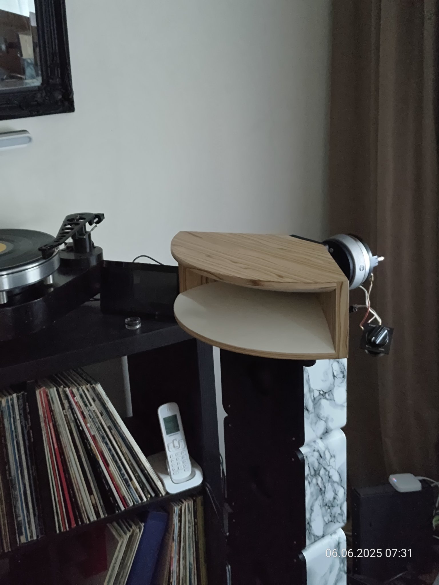

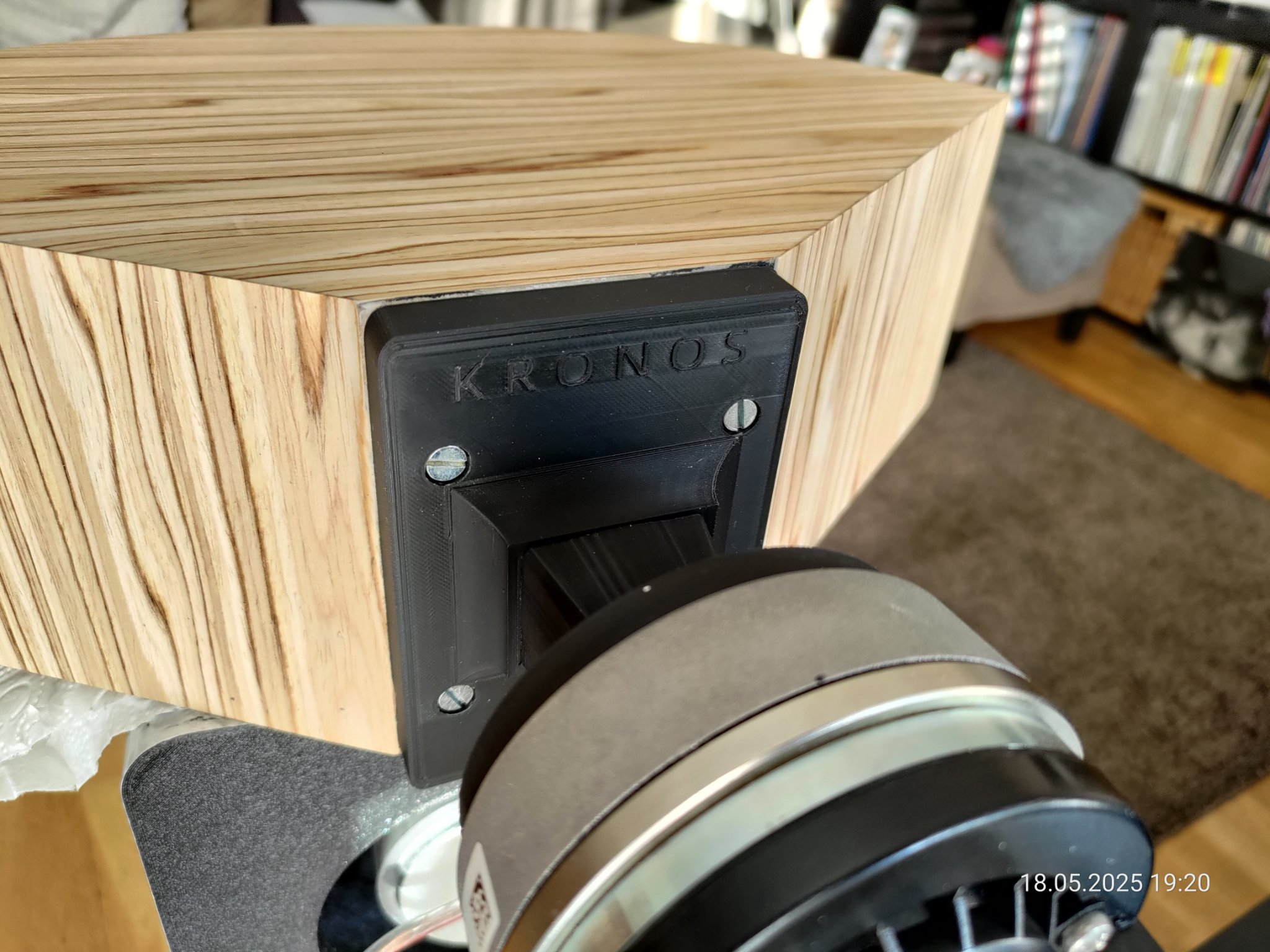

Hi guys,
I recently got a pair of Fostex H400 horns.
They were in bad condition.
So I decided to make them pretty again and use them with a pair of Beyma CD11Nd or CP385Nd which I have at hand.
This is what came out
For the moment I paired them with my PPD Subs. Just to hear what the horns are capable of.
The PPD subs are supposed to play up to 300-400hz. So this is by far no perfect match crossed at 1k.
But I really like what I hear from the horns

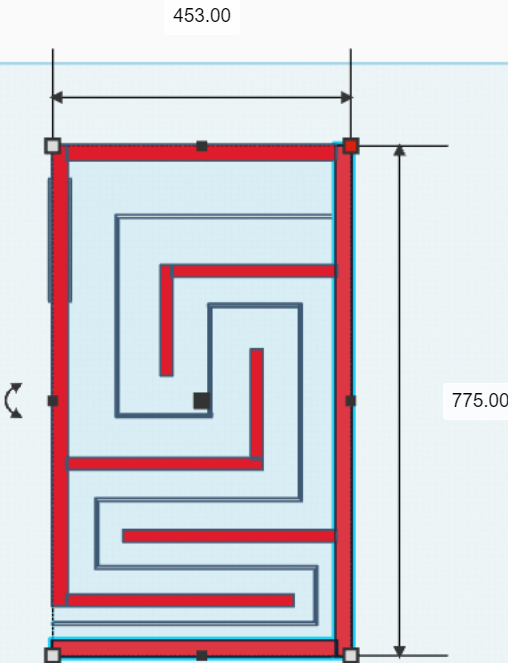

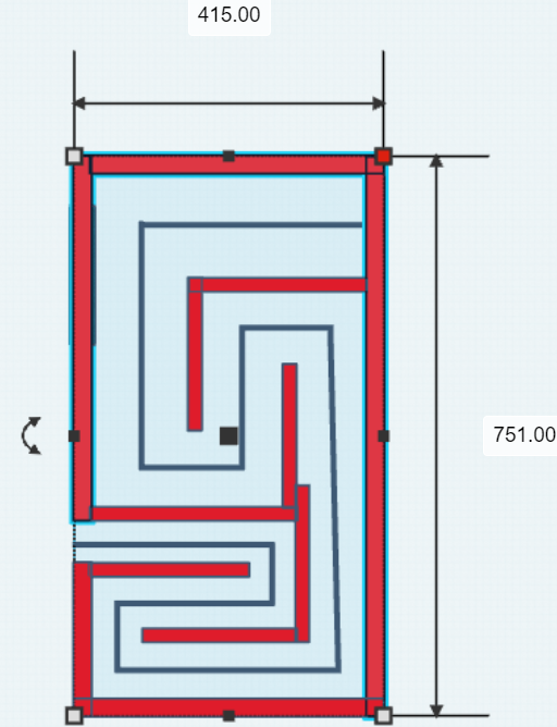

I have a pair of RS225-8 laying around. So I stumbled into the thrad '10F+RS225 FAST' and decided at last (after some advice from XRK) to build a pair of tml enclosures for the Daytons.
The enclosures are to tall for my taste when I want to put the horns on top.
I am aiming for outer Dimensions of roughly 40x30x75 cm
So with 5cm Granite bases the center of the mid/hights horn will be 90cm from ground.
I unfolded XRKs tmls to evaluate the geometrics.
The tml is about 95inch (241cm) long.
Cross section starts at 68sq inches (438cm²) and ends at 2.25 sq inches (137cm²). The cross section tappers very evenly across the length.
So how to fold the TML into my preferred enclosure dimensions?

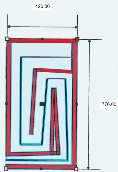

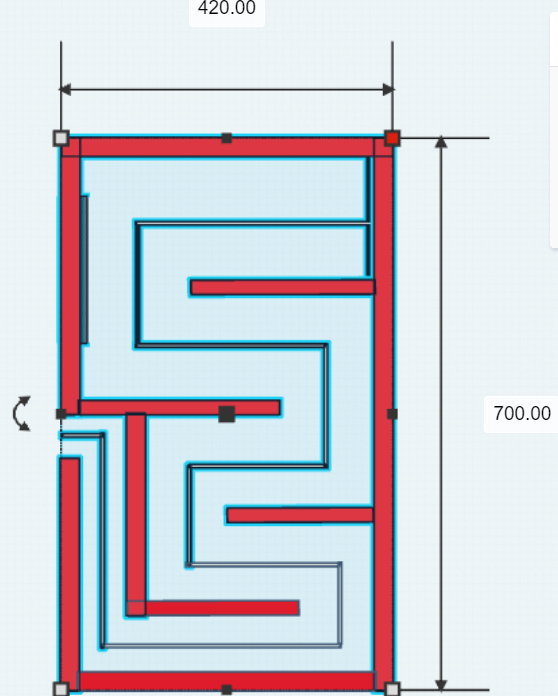

The difficulty is to fold it to the enclosure dimensions with driver on the upper half and the opening at the front.
So here are some attempts which are more or less having the desired geometry.
All my attemts are bases on an inner width of 25cm.
This one is 250cm long with an opening of 142cm² starting at 400cm².
The next one is more complex to build because of the no 90°angles.
This is 230cm long ending in 125cm²
This is a short one
190 long, 142cm² mouth

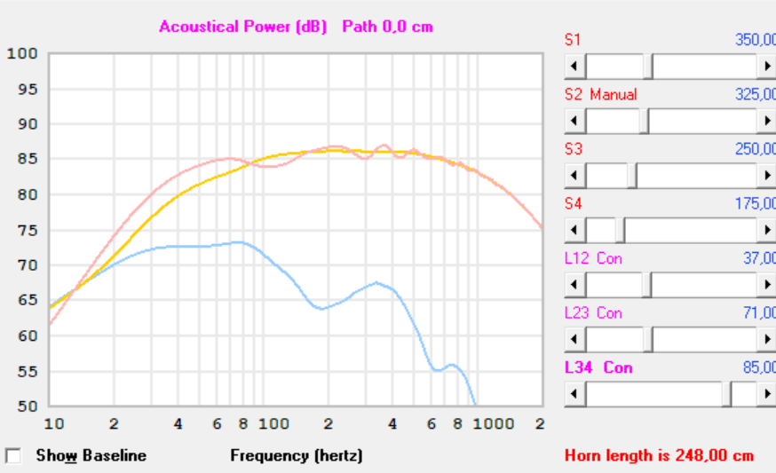

All these simulate in hornresp very similar.
The shorter one need some more stuffing to get the response more even.
At the end I think it makes not a big difference.
I will cross the tml at 1k-1.2 k to the horns actively with minidsp.

Hi, since you have a subwoofer the extra effort of building a pipe resonator isn't needed. But your sketches are good!

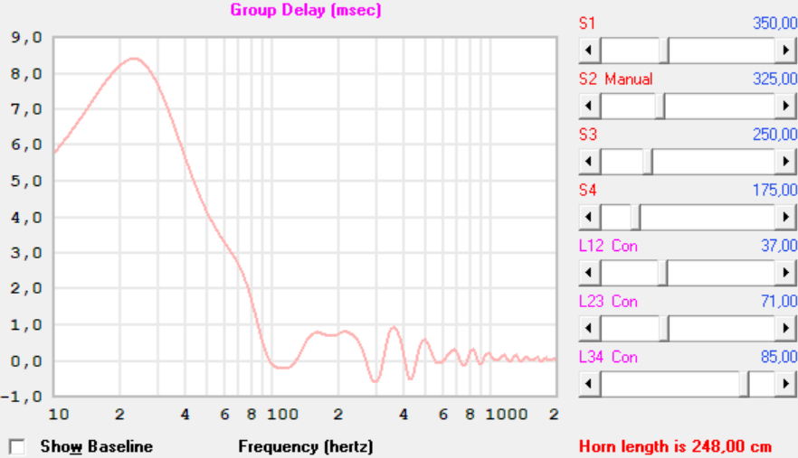

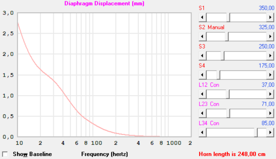

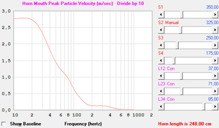

So this is an even taper from 350cm² to 138cm² at 248cm length.
Inner width 25 cm. Outer walls 22 thick, inner walls 16.

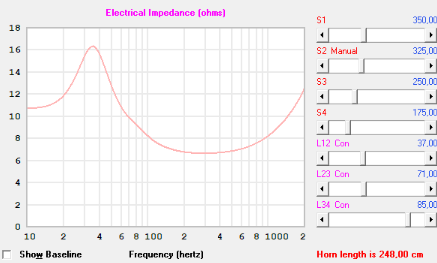

It’s odd that the predicted impedance doesn’t have a double peak with a dip in the middle characteristic of a vented alignment. The midpoint between the peaks is the cabinet TL Fs.
