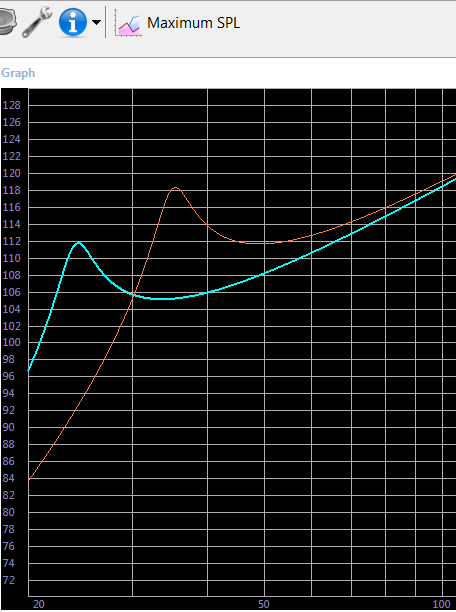

Your boxes are vented and tuned to 24 Hz. The song 'Sail' has got strong output at 42 Hz and some less strong at 35 Hz, which both are in the power dip region of the vented box. This dip is deep because the box appears to be a bit oversized and tuned lower than what would give a flat response. One way to increase mechanical power handling is by increasing the tuning frequency and adding a high pass filter. Then a separate subwoofer is required for frequencies below the new tuning frequency. The attached image shows excursion limited SPL for your current 24 Hz (blue) and a new 35 Hz (orange) tuning frequency. At 40 Hz sound output is 8 dB higher for the 35 Hz tuning, at 35 Hz it's 13 dB. Be aware that electrical power handling will be limiting, because power dissipation is high around the tuning frequency and excursion and therefore cooling is low.
Four high excursion 8" woofers will be expensive. What is your budget?

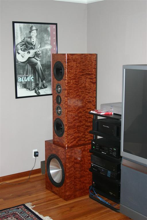

Here's an option that will require reducing the cabinet height a bit and sealing them. The cabinet drawing is on Curt's website.
The ones pictured were done by a good friend of mine back in 2008 and he still won't part with them.
The crossover from the RS225's to the mids is about 375 Hz. so the lowest midrange is shared by the RS225's. I assume you followed the passive crossover point with your active for the bass. A pair of 15" Ultimax with a 50-60 Hz. active crossover would work well for reinforcement when you want to get super loud. If you need more xmax than the Ultimax, get out your wallet because it will cost a lot of money.
HTH
Jim
HTH
Jim
