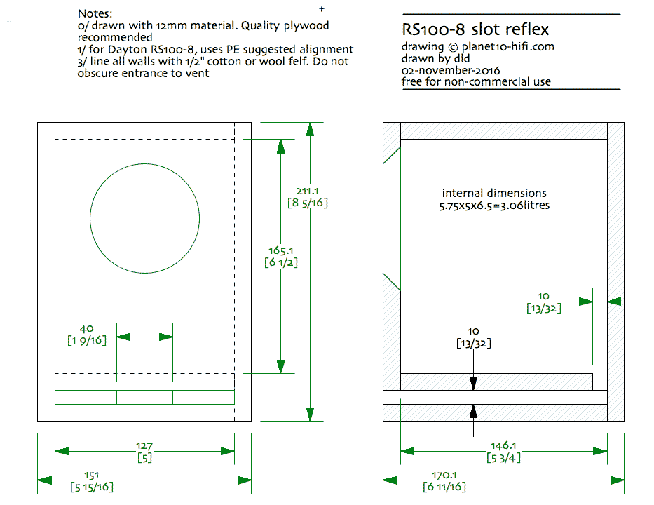

Do you have a recommendation for port slot port sizes? I have the box measuring 5.75"x8.25"x6.25"=296.5cu in. The calculator I used said port should have diameter of 1 inch and length of 2.33 inch this has area of 0.78 inches/ 4.9cm.
= 4.86 litre.
Those are internal dimensions? Hopefully not, because that is too much volume — you could always put a “brick” in the box to eat up some volume if it is.

Oh jeez yeah it is way too big. Didn't realize I was a whole liter off. I revised the measurements so it's 5.75x5x6=172.5 cubic in. That's 0.3 Cuin. off from 0.1 cuft. That seems close enough to me. Also thinking about a taller version that's 4.5x5.25x7.25=171.3cuin. When plugging in numbers for the dimensions, I gets widths of like 12cm but the height is 5mm which seems insanely high. If I make it less wide it screws it up a little bit right? What should I do
Changing 5.75x5x6 to 5.75x5x6.5 = 3.06 litres.
This is what i’d do — note that the vent spacer width is unknown, i had a power failure last nite and haven’t gone down to turn my modeling computer so can’t figure it yet. If it turns out to be too wide, i’ll shrink the vent height.
Uses 12mm ply, and all dimensions used, except the starting internal dimensions, are metric.

Note: drawing updated to reflect missing information

Thank you very much for all the help. I obviously needed it. How do I find the size of the vent spacer? And also would Home Depot or Lowes have the plywood? Again thank you so muchChanging 5.75x5x6 to 5.75x5x6.5 = 3.06 litres.
