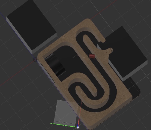

Just thought i'd post up some progress i'm having with a parametric design for small / micro Transmission Line speakers
I've knocked up a quick blog also at L̶a̶t̶e̶ ̶T̶h̶i̶r̶t̶i̶e̶s̶, Early Fourties, Tools, Electronics, Life – Been reading way too many maker blogs. Here's my contribution
The goal,
Make as small as possible a 3D printable Transmission Line enclosure for those speakers......and, as a 'side' project, make the enclosure totally parametric!

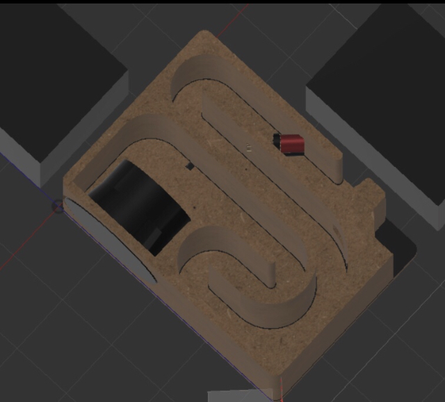

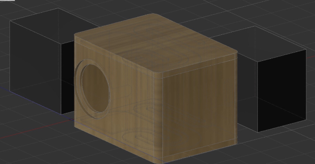

I've attached some pictures showing the different shapes the enclosure takes when you specify different parameters. The first photo is my chosen size of speaker....The enclosure is on its side in the pictures.
The black boxes are there for scale, they're the size of my existing bundled HT speakers that i'm replacing
The parameters
Speaker enclosure Width
- this sets the Width of the waveguide -
since the total speaker width is Wall thickness + waveguide width + wall thickness
SD - This sets the 'Height' of the waveguide....
we already know the total surface area needed, we know the speaker width so it's easy to find the waveguide height
Both the above set the size of the rectangular 'output' of the waveguide and therfore the entire waveguide size
Wall Thickness - just as it says, you can go from 1mm to whatever really depending on how sturdy you want the thing
Tolerance - currently 0.5mm - gives a bit of wiggle room each side for attaching the pieces together, i.e. the 'side' plate sits within th e middle part by a few mm...this part is shrunk by 0.5mm each side to allow the centre part to locate and lock on nicely. I'm intending to glue the lot together
Waveguide Correction - once you get the right looking size / shape of speaker, you'll need to 'tune' the length of the waveguide - this number basically moves the port up and down at the rear - when the port's at the top, the guide is about 70cm long, when it's at the bottom, it's about 82cm long...allowing a good tuning range of frequencies.
I'm working on changing this a little to add an extra waveguide 'fold' in
can't see any reason why I can't get a 12" sub into it along with a 2 meter waveguide....will be interesting printing it
you can also set the speaker sizes
It's a 3 piece print - Two sides and the centre wavy bit
I'm pretty much finished with the design now, just gotta measure accuratley the waveguide length
Question - where do you start measuring the waveguide length? - from the back of the speaker?

What waveguide? Do you mean the line / pipe (they aren't generally used as synonyms outside Bo$e's marketing department 😉 )? If so, axial length is generally taken as from the sealed end (aka 'throat') along the centreline to the terminus. This is in effect a ducted vent ported box though, so it's more or less from where the driver chamber exhausts into the duct.
Where did you get the chamber size and the pipe CSA and length from? Why the smooth curves? Note that smooth curves only have any significant acoustical impact in reducing losses of the [unwanted] higher frequencies; the LF wavelengths are too long to be affected. Pipe tuning is a function of axial length and taper (which creates acoustical length). The amount of gain you'll get (to a point) is a function of bulk, viz. pipe cross section. End-loading, i.e. placing the driver at or in extreme proximity to the throat provides maximum excitation of the fundamental and all relevant (odd) harmonics.

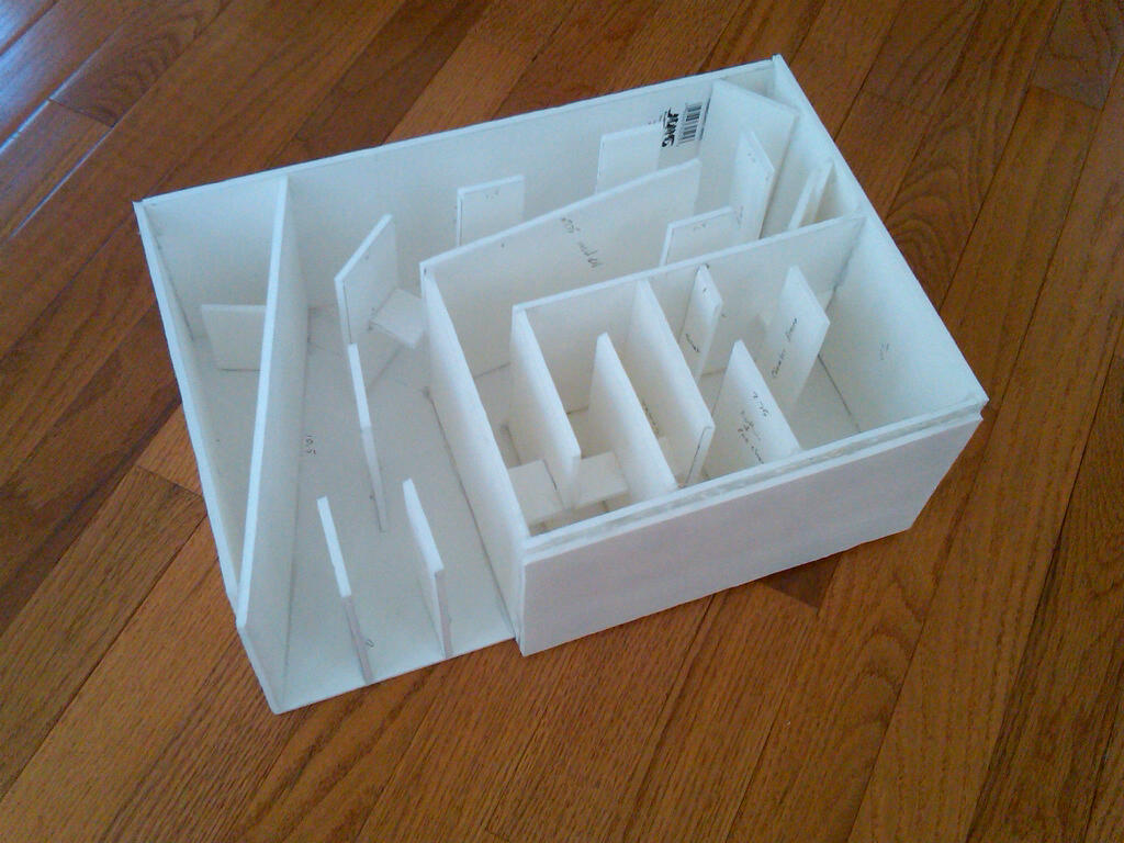

You might play around with foam core first to get a feel of how the TL will sound before committing to wood. It would be easy enough to gin up something like this in an hour with foam core and hot melt glue for $2. No harm done. I built something like this as one of my first BLH's with a TC9FD - without any modeling or simulation. It sounded a bit unbalanced - but I now realize probably what I needed was baffle step correction.
