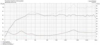

Got a few more measurements tonight after dinner. In all cases, the bass boost on the receiver was set to +4 and the 3.5mH/8.2Ohm filter was in place. Pay no attention to the actual SPL levels as again I adjusted volume between tests - the high-end of the driver overpowered the mic after I had already completed the port measurements and didn't want to redo them.
Port output @1in, impulse measurement:
Port output @1in, spectrum analyzer:
Driver output @1ft, impulse measurement:
I tried a much closer measurement of the driver, but saw a huge dip around 5kHz which went away with an increase in mic->driver distance.
The speaker actually measured much flatter than I thought it would, including the up tilt in the bottom octaves. I think my ears are used to much more bass output from the 21" OB woofers...
I may still play around with the filter some, including maybe a slight notch at around 3.5kHz and seeing if anything can be done about the output above 10kHz - but still pretty happy for now.
Also: Taking away the +4 boost, lowers the output below ~250-300Hz by a pretty accurate 4dB - still a bit above the remainder of the range.

Ben,
Very nice measurements - the bass extension and smoothness of the frequency response look great. Do you have HD plots to show? Also do you have more listening impressions of the sound? As you know, there are very builds with this driver and even fewer with measurements.

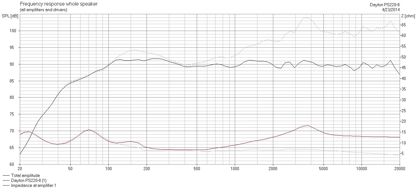

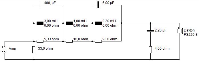

Finalizing
Sorry it's taken so long folks.
I got very acquainted with Boxsim about a week ago and decided to throw the Dayton's through the program to see what I could come up with. I padded the top end down, brought down the peak at around 3.7k, and took the baffle step down quite a bit - maybe a bit too much, but nothing I can't play with.
I built the circuit today and must say that I really like what I hear. Obviously much efficiency was lost, but as it was all in the top end, I feel that they were never that efficient to begin with. They have very adequate bass response now and they still have that little bit of sparkle at the top end. The mids are much improved as well and not as drowned out.
I'm a happy camper 😉
