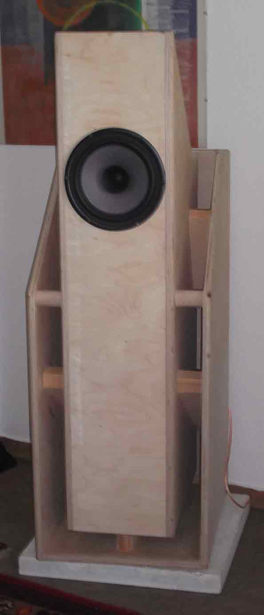

I believe Greg B's "Karlsonator8" would work (there's a larger version of the plan in his stupidhifitricks Google folder)
https://lh6.googleusercontent.com/-...0g/hi5Qd7SIw6Q/w878-h690-no/Karlsonator-8.png
here's the first build of that cabinet (the aperture could be extended higher)
https://www.facebook.com/media/set/?set=a.645456515500837.1073741837.601735219872967&type=3
also, PS220 should work in a classic Karlson K12. It would work in some MLTL - amplifier output impedance should be figured into its parameters.

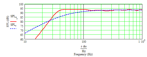

FWIW, here's the somewhat 'fat' 35 Hz MLTL I simmed for myself using measuring specs awhile back, but haven't been able to build it yet:
L = 60"
CSA = 164.5"^2 [suggest 16.312” W x 10.09” D]
zdriver = 22.63"
zport = 51.43"
dport = 5"
lport = 0.75"
All dims inside [i.d.] and approximate and simmed with minimal damping.

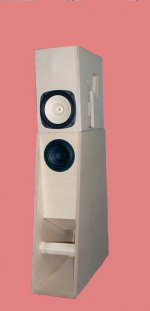

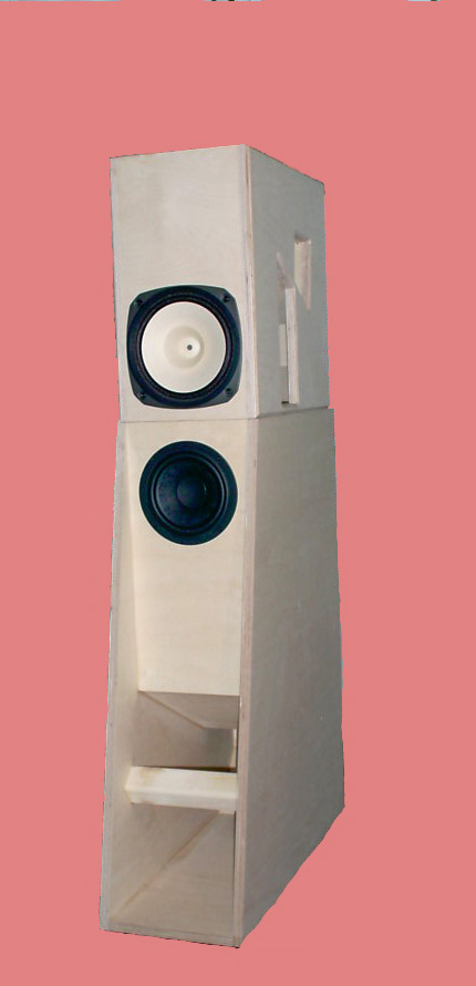

dayton 8"

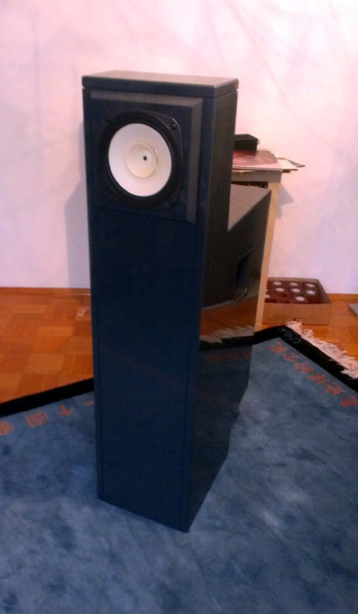

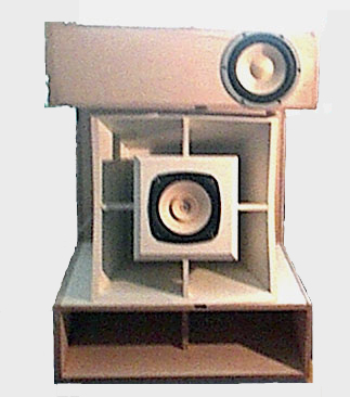

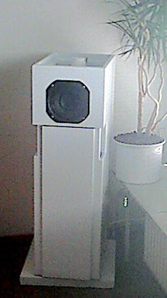

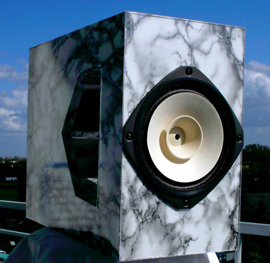

my suggestion would be my satellite horns
Schalmei, Trumpet, Horn
or the double horns
Saxophon, RDH20, Posaune XL

Is this for the PS220 diver? If i am interpreting it correctly
the Length is to be 60"
is the CSA the cabinet width and depth? Can they be interchanged to get a slimmer cabinet or the dimensions important for the MLTL?
The zdriver and the zport are the position of the driver and port o nthe 60" lenght? and the dport and lport are the port dimensions. So for 3/4 mdf, just a 5 inch hole would do for a port?
Thanks and Regards
Ani
Correct.
Correct.
CSA = cross sectional area, i.e. width x depth. Yes, though some [more] baffle step correction [BSC] may be required due to the very narrow baffle width. More padding may be required on the rear panel behind the driver due to the increased distance also.
Correct, both measured from the inside top.
Correct, though I normally use a ¾” long ‘insert’ of PVC or heavy duty cardboard tubing that can be slid out if I want to tune the cab a little higher [no insert] or tune it lower [longer insert, which often happens]; just make sure it has a good seal using Blu-Tack or = to ensure proper ¼ WL pipe and vent tube loading. BTW, no need to slide it in all the way in for testing, so leave enough hanging out to allow easy sealing, removal.
In retrospect though, you may prefer a higher tuning to get a nice bass ‘bloom’. If so, then start with a 6” dia. vent [or metric =] to experiment with and for reference, at ~2.75” long it should have the same tuning as the 5” dia. x ¾” long vent.
You’re welcome! If you build it, please let us know how it turned out; good, bad or indifferent and what tuning, ‘refinement’, if any, was required.
