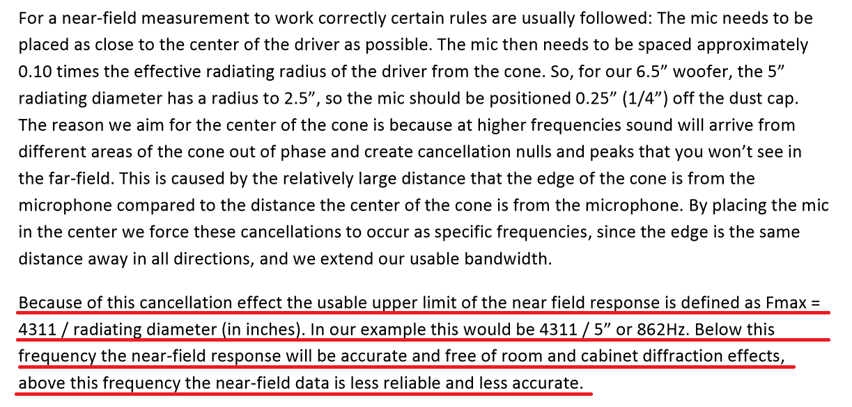

What was the baffle measures the driver was measured on, if there was any? You could be looking nasty diffraction artifacts. The measurements are most embelished in an infinite baffle.
Ok yes good point,
These measure were done close mic about 1 inch, then move mic around cone and at 5 inch and 10 inch positions to see if the artifact is still there.
Ive been doing this for a while now on a bunch of drivers, 10 inch AL cone, polyprop mid, some ribbons and planer magnetics.
Basically I find I can see the energy storage issues better with close mic and short gate. Perhaps Im missing something big here ? This technique seems to have worked well in past.

Thanks Lojzek
I do understand what that article is saying. Because I am involved in development of ribbons and planers I have often used the close mic method to "see" what the diaphragm is doing and where. This means really close mic like less than an inch often at maybe just 1/4 inch. It has its issues for sure BUT what I do is just move around to a bunch of places and distances using various baffles etc etc until I get some confidence that what im seeing is actual diaphragm issue and not a diffraction etc issue.
I have some 10 inch AL cones that show none of this behavior as well as some others cones. I could be doing something wrong I suppose but damn that tail in the CSD is a whooper. Starts from the first slice and doesnt hit the ground till about 7-10 ms out

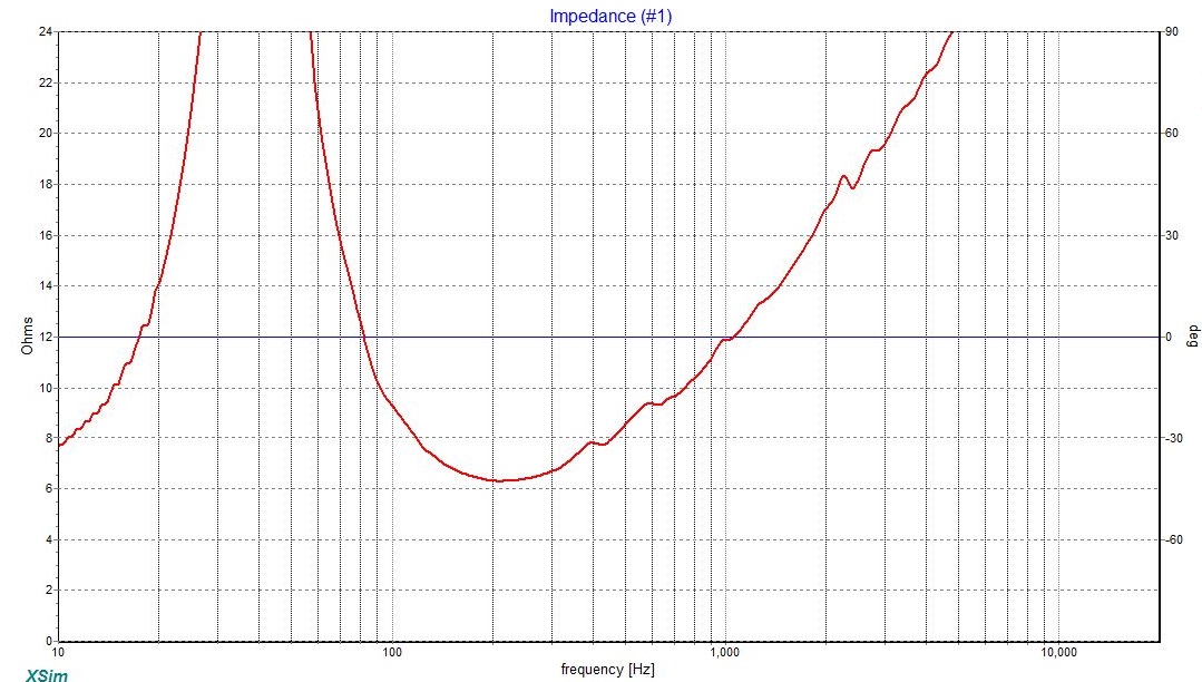

Ok, if you are confident you have done everything right then the resonance does exist. If you were to measure impedance in free air, the noteworthy resonance should be there as well.
edit: Dayton's zma shows a couple of wiggles
Yes that Z plot shows the wiggles close where I see the issues.
BTW more investigation suggests, as John pointed out, that the surround is responsible for the energy store around 6-800 hz.
Also interesting to note, I ran driver at 50hz sine wave at full Xmax for about 2 hrs. There was a change in the 6-800 bump. The wiggle in FR is down a bit and the tail in the CSD is better, not eliminated but its at least down into the foot hills now.
We will see what happens over time
