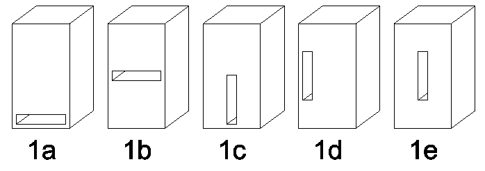

So after cutting and gluing the box ended up having an internal volume of 7'. (Empty)
Am I correct in thinking that If I wanted to do a Extended Bass Shelf or "Super Sub" it's too small. 🙁
So ideally a tune of 32Hz with a 1db hump is the final consensus?
I'm hoping to get the slot vent cut into the bottom of the front baffle and then I'll post a pic.

I took a temporary shortcut by using a pair of Cerwin Vega enclosures I had.
The enclosures are 3.55 cubic ft. They have a full width slot about 2 1/2" slot along the bottom in the rear. The top of the slot in the back is enclosed to about 2 1/2" from the baffle.
These enclosures are too big as PE recommends 1.55 cubic ft for a vented enclosure.

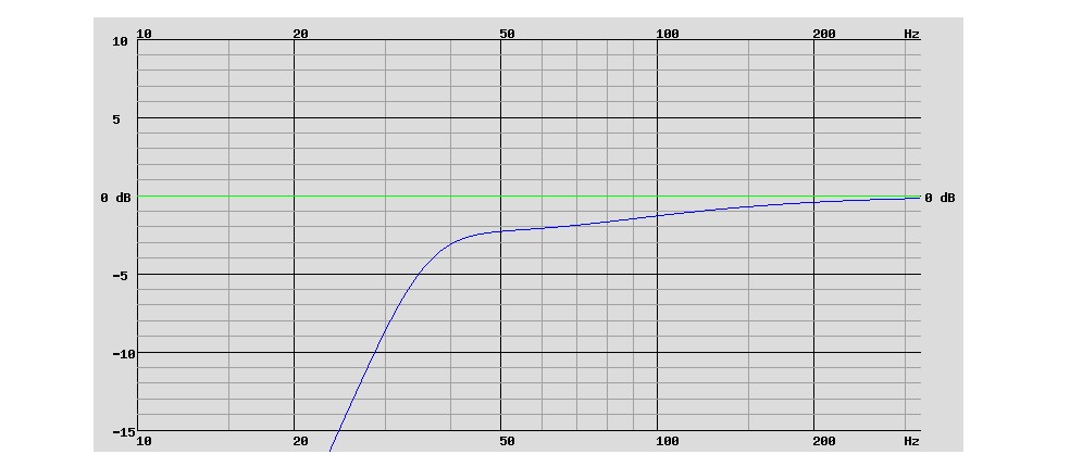

So let's look at (one of) the alignment(s), net/v, ports and power for this setup project.
DAYTON PA380-8 v2015, VB = 100.0 L, FB = 35.0 Hz
(data from link)
P=210.00 W (~V=42.00) @Xmax for the dimensioning of ports.
Ports: (1x) rectangular 2.5"x8.00", length 8.5"
For larger ports (c/s area) meaning longer lengths.
Note: You need to add the volume of the port(s) to the speaker net volume (internal) if the 100L/3.53ft³ together with the volume of the driver (displacement 15 inch - 4.0 liters) and bracing approx. 4.5L= 0.160ft³ for the final extra volume of the enclosure (internal).
Probably not very interesting as a sub, no extension. Maybe more interesting as a multi-way type woofer ~95.4 dB/2.83V/m. This is the Multi-Way forum anyway. Have fun.
