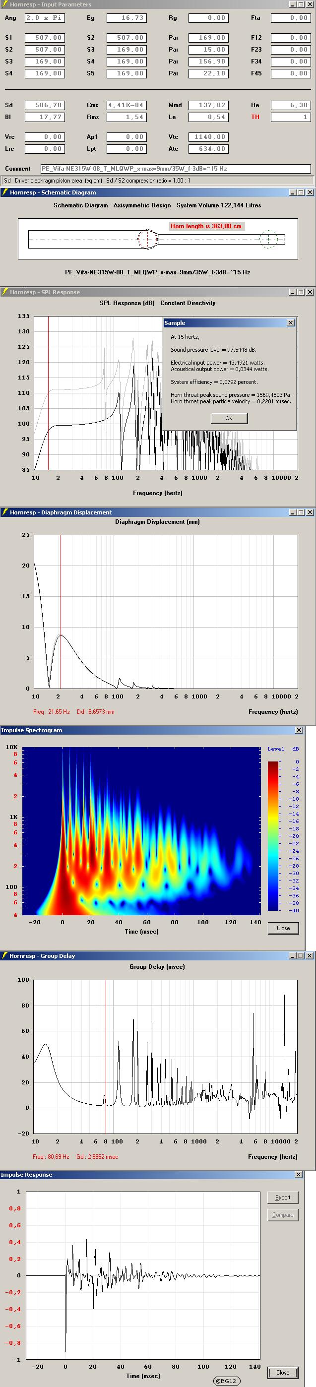

B bjorno R.I.P. Joined 2005 2012-03-27 5:43 pm #21 2012-03-27 5:43 pm #21 Hi, FYI: A suggestion using the IMO very good Vifa-NE315W (from PE) as stand's or stand-alone 'musical' T-MLQWP ( Tapped-Mass-Loaded-Quarter-Wave- Pipe) multi-folded sub's: b🙂 Attachments PE_Vifa-NE315W-08_T_MLQWP.JPG 253 KB · Views: 643
