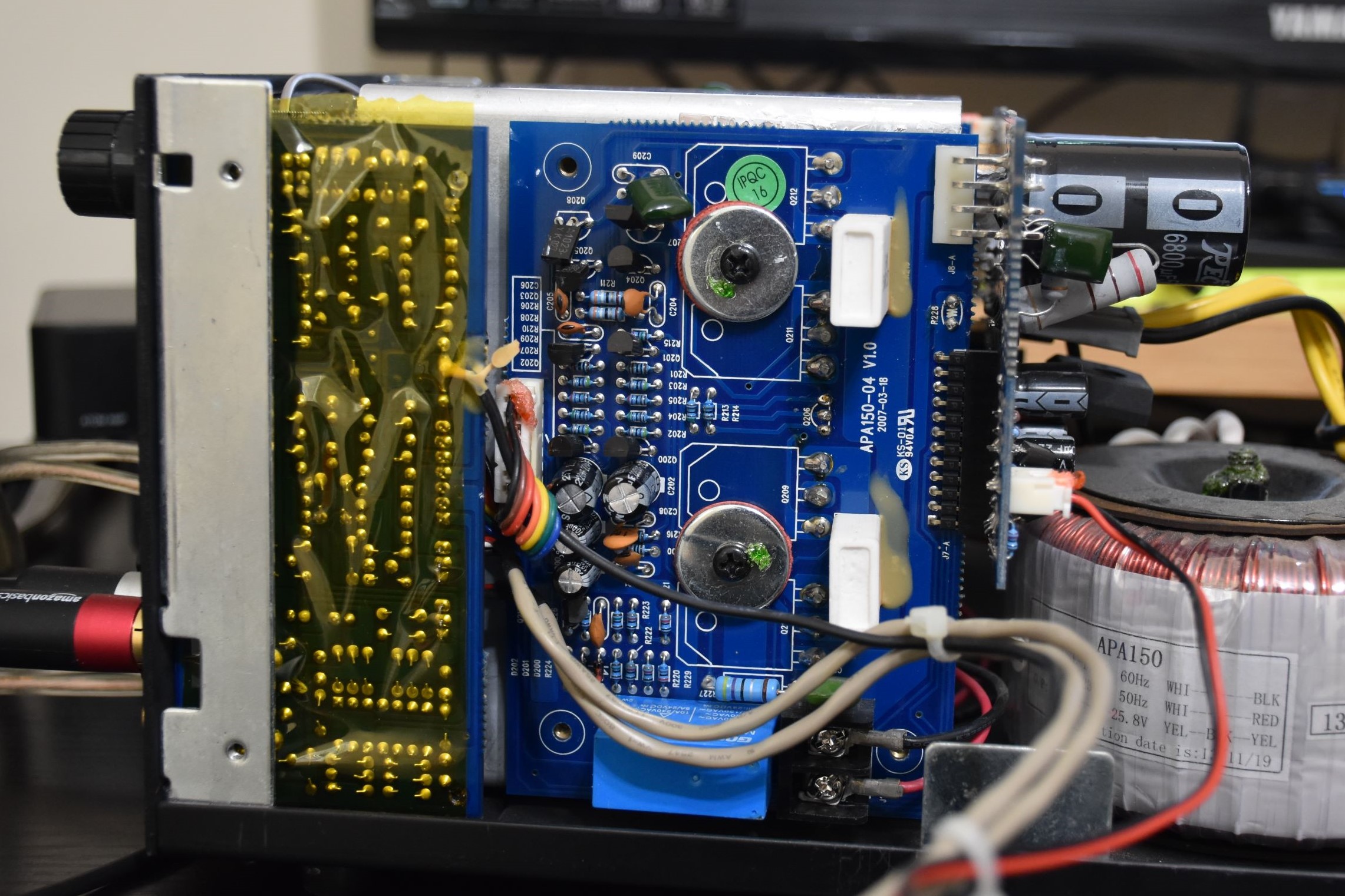

Alright so the stereo amp I have been using to power a pair of bookshelf speakers connected to my PC have recently starting shutting down on me. I can get it kicked into ON mode if I heat it up with a dryer, however, if the room gets too cold, I again have to take out the dryer.
I made a very lengthy post over at the EEVblog asking for help and even replaced what we thought might be bad diode to no avail, same problem persists. I will leave a link so you may view my post and pictures. OPA150 Stereo AMP issues, only turns on when I physically heat it up w/ a dryer! - Page 1
I guess what I'm now trying to do is pretty much Frankenstein this thing and that's where I could use some help. Unless someone can review the above post and knows a way around to keeping the amp on constantly, that'd be awesome.

My guess why it won’t work based on the requirement to heat it with hair dryer: there is a bad thermal cutoff switch inside that is used as last resort to prevent the amp from melting in case the fan fails.
There is a temperature sensor on the heatsink. Either it is bad, or the circuit it has a connected to is bad. You may have a mechanical thermal switch like used on coffee maker. Round aluminum covered button with two spade connectors. It might be bad. Those are replaceable.
Sounds like a dry joint.

I've gone over all three baords and re-flowed most every joint I could get to, same issue.

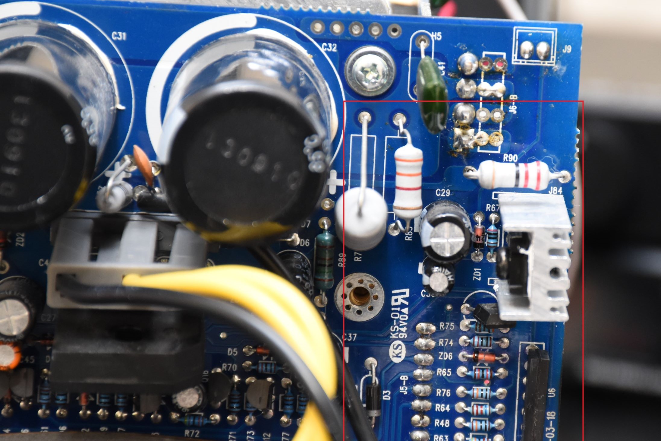

One more thing on existing problem. In the last picture you'll see I've drawn a red rectangle around few resistors and a diode. This area specifically when heated keeps the amp on (Relays switch on). I've replaced all these parts and to my surprise, same problem with needing heat in same area. So either there is a microfracture somewhere in that area on the board or the heat changes the resistor values enough that it kicks it on.
Thing to note is that the voltage across that ZD6 diode is dropping, when I warm it, it gets to 10.2V, but over time it drops and once it gets below 9.75V, the relays click off. I have to keep the heat trapped in the amp for it to stay on longer. The colder the room, the faster it'll shut off. I don't even know where to start to keep the thing on constantly.

Did you try replacing the ZD6 diode? I assume that’s a 6v zener diode. If you detect a temperature varying voltage there maybe it’s a bad thermistor or NTC somewhere in the circuit. It would be good to see a schematic. Can Dayton provide you with that?

Yes, I've replaced the diode in question, no luck, same problem needing heat to turn on. It's a 12V (C12) Diode. And I think the transformer is center tapped. it's output is 28v-0-28v, can it be wired in parallel?

Bad solder joint on R90 and Q208?
hmm I'll try reflowing it but it's all through-hole components and backside where leads come out is soldered pretty well.
There's actually a few components where they are soldered well on the backside but the hole looks "empty" when viewed from top (component side). Not the greatest soldering as the solder should flow through even if only soldering on the backside. I'll reflow it thoroughly and see if it helps. Thanks, will keep you posted.
Did you ever get this problem resolved? I'm having similar problems on (2) APA150s. Like you, I suspect it's one or both of the thermistors, or the circuit before the thermistors. I've spoken to Parts Express and Dayton audio, both say they've never heard of this. My units shut off from what I believe is heat. But the heat sink never gets hot. When you disassembled your amp, did you remove the large heatsink. It looks like there is a thermistor thermal pasted it to the heatsink on each channel card. Did you try to heat the thermistor itself?
Resolved: If you own an APA150 and it randomly shuts off, the problem is likely a loose connection. A strong indicator is if the fan doesn't come on before shut down. When I disassembled my 2nd failed APA150, I noticed that the speaker spade connected at the PCB was loose. This was causing a fault, the amp would shut down, and the fan turn on. After I checked and tightened all screws on in the amp, the problem was solved. I've seen this problem before on a Yamaha DSP3090 receiver. It would shut down randomly until chassis screws were tightened. For the APA150, the indicator is the cooling fan not coming on until shutdown. When resolved, the fan will come on in high load situations, but will cycle off when system is cooler. I hope this helps other with similar problems.
