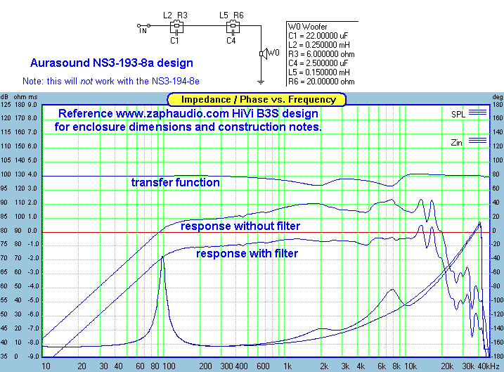

No way can such a small driver handle 50W without being c/o to a sub.
The ND90 is a rebadged Aura NS3, see Zaph|Audio
A 1.5 way might be an idea for power handling and baffle step,
the TS parameters indicate around 3 or 4 litres sealed for two,
and that vented is not a good idea,though its possible with an
unusual alignment.
Having said that for near field with one driver a 2L box tuned to 70Hz
(with some sort of low bass filter for ~ 50Hz and below) would give
around 3dB of baffle step compensation, peaking around 150Hz
and could work quite well if the driver is unequalised.
Use 2L boxes and try 70Hz tuning or settle for sealed.
rgds, sreten.
unusual alignment.
rgds, sreten.

They will be fine sealed. Porting I don't recommend but is possible.
With two boxes do a binary search comparing the two boxes to find
the amount of stuffing that gives the best bass, too much will kill
bass so its a much as possible that works.
rgds, sreten.
Try checking NS3 / ND3 differences at Zaphaudio.
