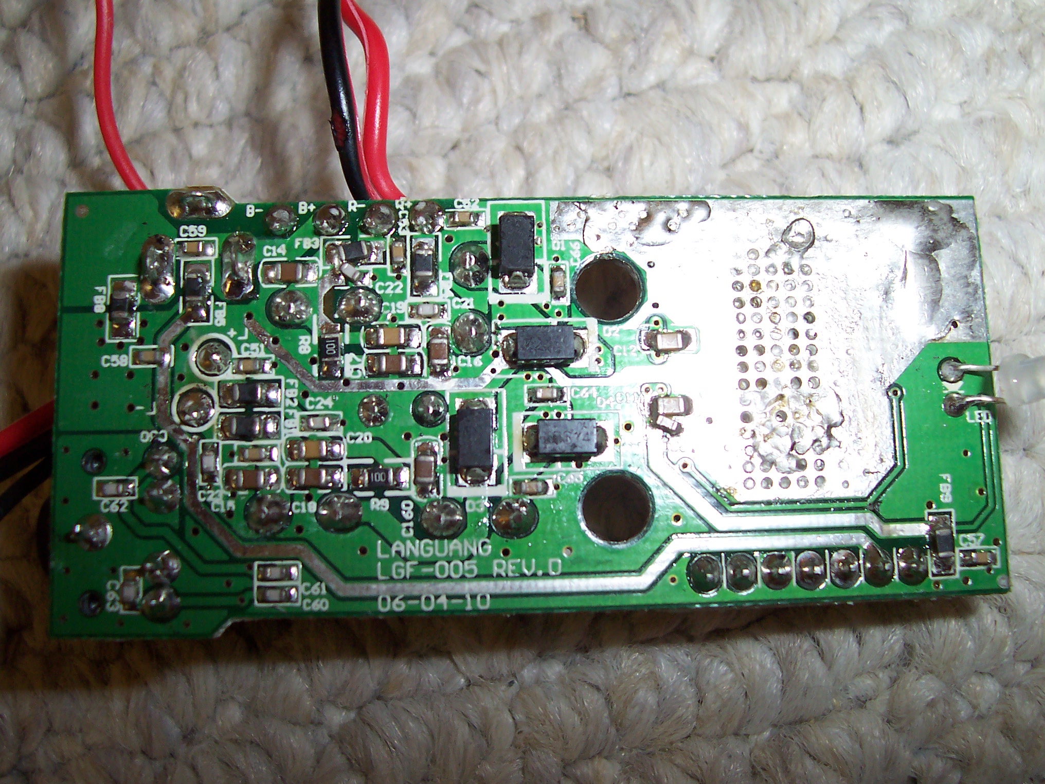

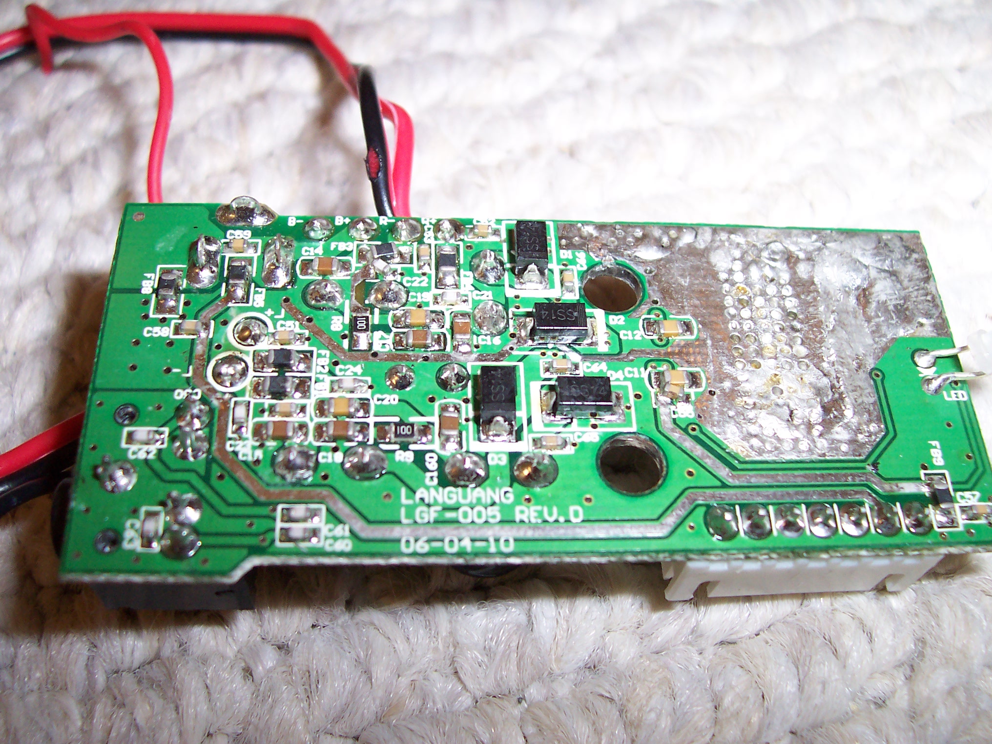

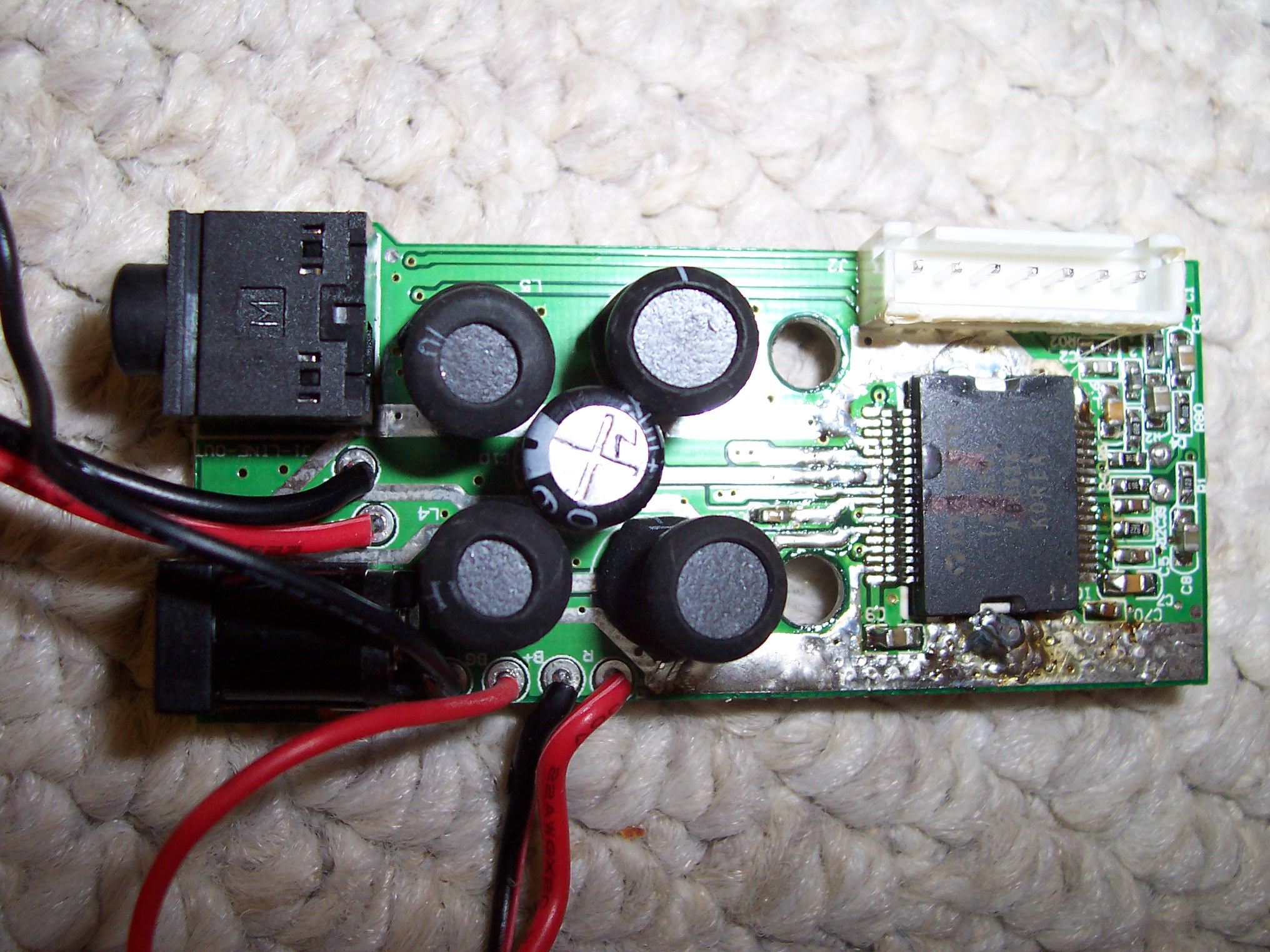

Well I got my Dayton DTA-1 Sonic T-Amp look a like.
I'm very happy to report that that it's almost identical on the outside as well as on the inside to the original.
What I'm trying to say is that if you are a fan of the stealth mod listed here: http://www.michael.mardis.com/sonic/start.html
you won't be disappointed.
It's the same Tripath 2024, same circuit board, same everthing.
The only difference I noticed at first glance is that the speaker wires come out of the top of the board, not the bottom.
Otherwise it's the same.

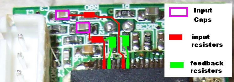

I just got my Dayton DTA-1.
I know next to nothing about electronics. But I was going to wet my feet and attempt the "just the caps maam" mod anyway.
Well this board is different than the ones pictured all over the internet for the SI t-amp.
Now I don't know what to do. I think I can handle all the case modding (pot, switch, inputs, output, etc). But I don't know enough to figure out which caps are the inputs.

Hi Patrick, this is what appears to be the input path for the signal.
Hope it helps
Lee
Hope it helps
Lee
Thanks! Though that makes the soldering job a little tougher for me. I assumed the input caps where the caps just behind the mini jack input. Changing those would have been way easier for me, oh well.
