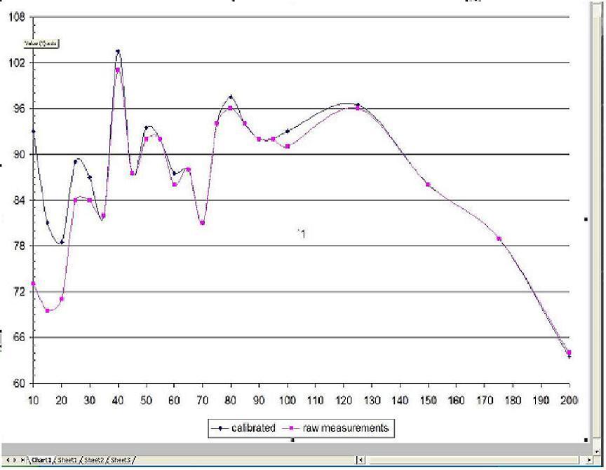

The one is being use as my sub w/o eq. and is in a 22" U-frame, no fill and still needs to be braced. I was curious how much panel flex there would be in a U-frame so I left it as 3/4" mdf for testing (1.5"baffle-17"X17"). FYI, OB/Dipole may behave as a velocity source in a room, but the box experiences very high pressures and the panel vibrations are easily visible from 3-4 ft away.
So with that build info and with the fact that it is just placed in the room and no experimenting has been done to find the best spot for it here is the graph using a Radio shack meter and manual calibration at about 2m:
