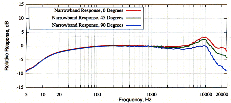

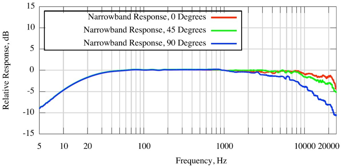

The Dayton EMM-6 measurement mic is a great deal at $50 but the calibration files they are supplying are very inaccurate. I had the mic calibration verified by a third party and the Parts Express calibration measurement is way off. Don't use it. The extreme wiggles are measurement artifacts and the flatness of the extension at the frequency extremes is completely incorrect. The first attachment is the PE measurement. The second is the third party calibration.

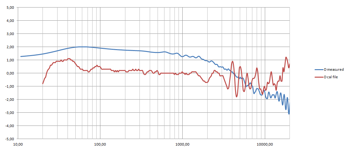

A friend and I both purchased a 'calibrated' Dayton EMM-6 from PE. My friend noticed he was measuring the same narrow-band deviations with different kinds of speakers and suspected it was the calibration file. So we decided to do a comparison measurement with both mics.
FYI, we've plotted the measured difference between both microphones (so no cal used) and the difference between the calibration files. Both plots should be identical, but there's not even a hint of similarity... Measured result is accurate above 200 Hz (gating).

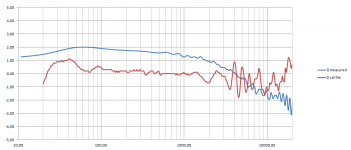

I've heard that P.E. has fixed this and the new calibration files are much better. But I don't have confirmation of that.
Looking at Sendler's third party calibration, I'm suspicious. I've never see a mic that flat without EQ. There should be a HF bump on axis related to the size of the capsule. We see it in Dave's plot from the same source, that's what you would expect from a mic of that size and type. Wonder what's up?
We ordered our mics in November of 2010 (serials 888 + 889). Any idea when they supposedly fixed it?

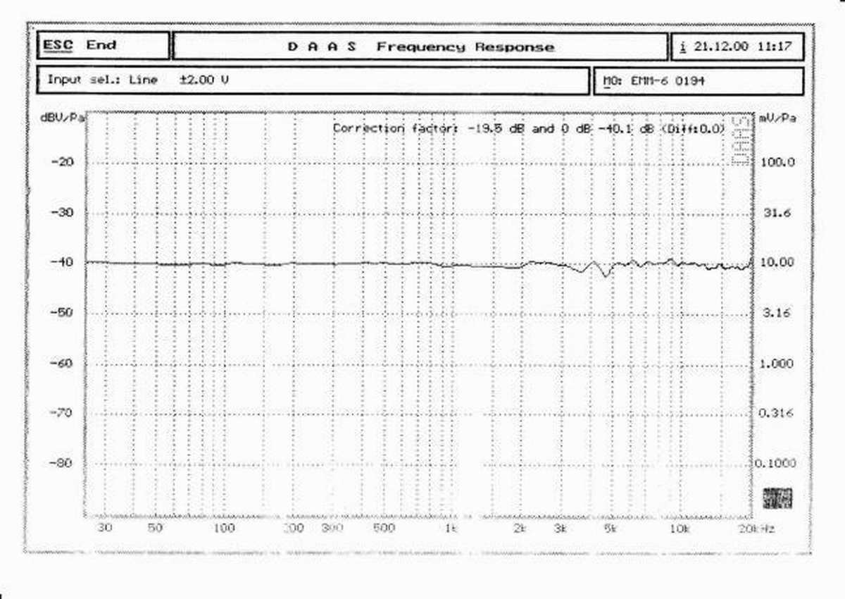

The ECM8000 and EMM6 both look identical including the carrying case and accessories. However the impedance between pins 2 and 3 is 600 ohms for the ECM 8000 and 200 ohms for the EMM6. Sensitivity for the EMM6 is given as 10mV/Pa ( -40dBV ) . The ECM8000 just says -60dB. WRT to what ?
