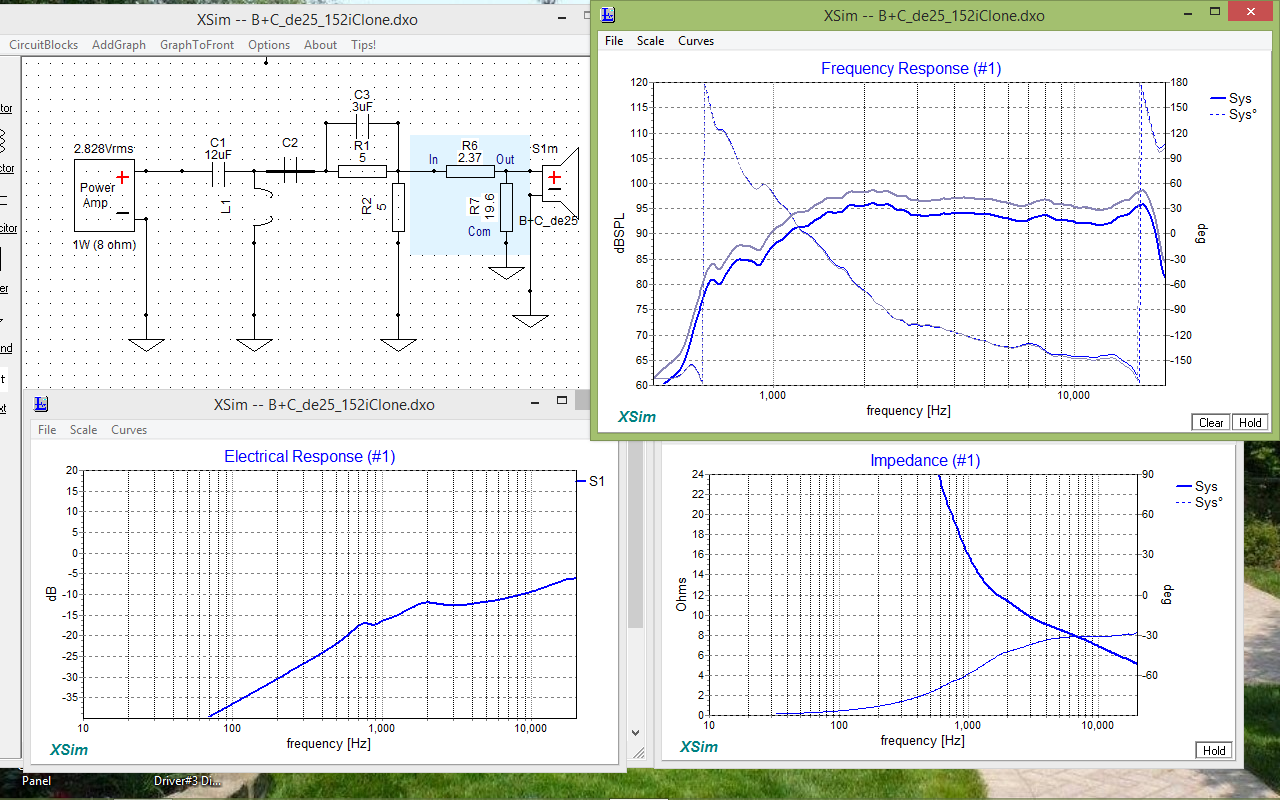

yeah - guess keep it simple - forget the Econowave/Pi spiel from me. I need to order pads -100 watt rated ones are pretty tough. What starting value would you suggest for DE25 with a QSC waveguide to work with ~95dB - 99dB woofer?
freddi,
I can post a network schematic tomorrow if you like ( for that driver/horn combo ).
- I still need to create a .zma file for the de25/152iClone combo.

that would be very nice to see. I think I have one DE25 bolted to a QSC WG - was hoping to use it in conjunction with either a 15tbx40 or 15pzb40 (those might make nice tapped pipe/horn ~30-35Hz subs)
Thanks EarlK! Connected several different cap values this morning. This definitely works! A heaviness was lifted from vocalists and the sound is ligh, airy and detailed. Started with 4uf (too bright) and worked my way down to 1.33uf on the QSC WG. This will help tremendously in fine tuning the sound of the various horns I bought. Awesome!

Here's a network for the de25/152iClone combo. ( C2 & L1 aren't in the circuit ).
The two traces ( in the FR window ) show the difference between dialing in 3db of attenuation from the variable Lpad ( R6 + R7 in the schematic ).
Changing C3 from 3uF to 6uF will essentially flatten the trace.

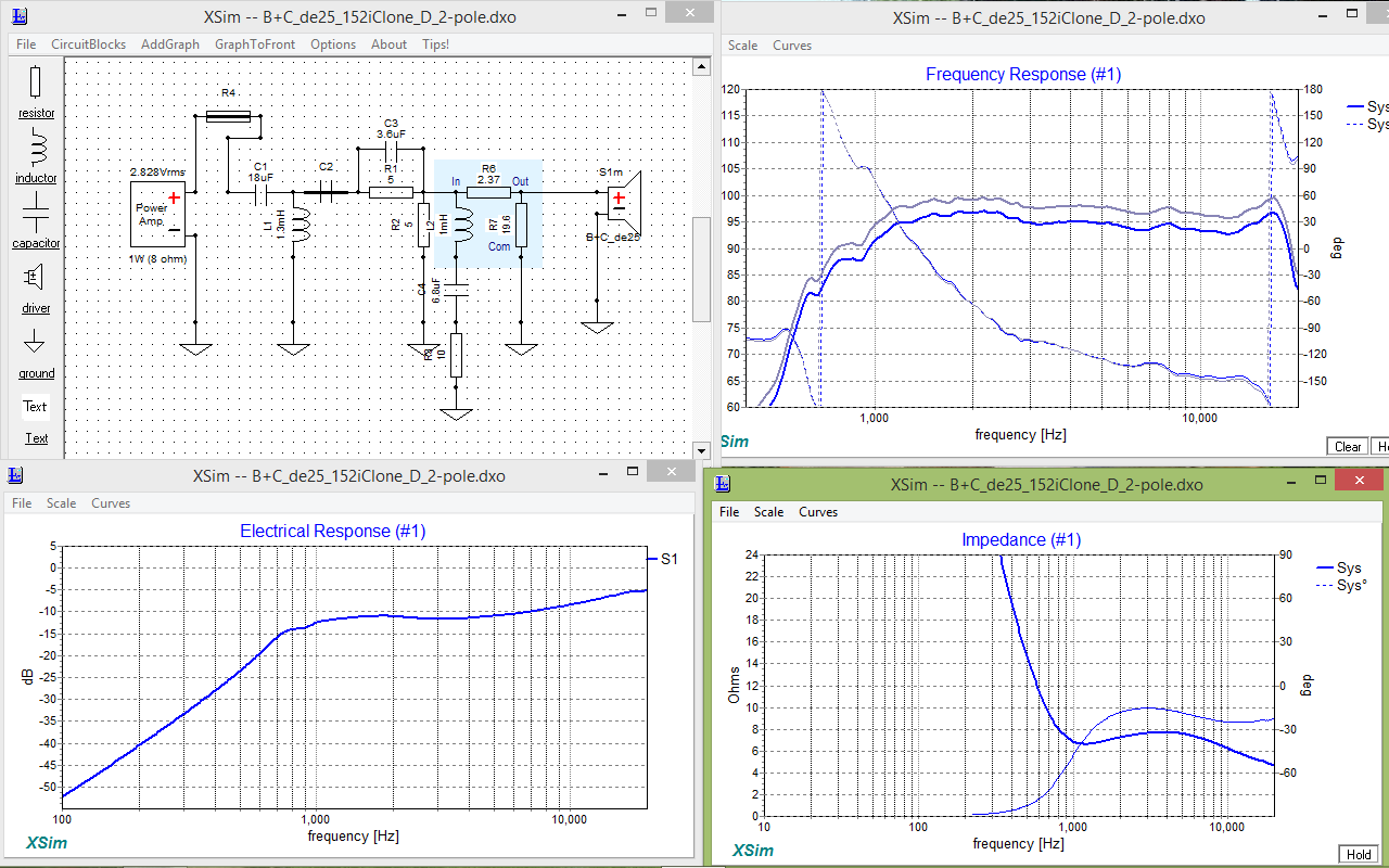

Here's a 3-pole variant ( with the 3-pole Hi-Pass also acting as a bump circuit > ie; boost EQ ) designed to push the driver down to a lower X-over point ( while still keeping the general sensitivity up ) .
This H-Pass would be harder to actually implement due to the 4 ohm dip seen at around 1.050K ( as well as a largish group delay figure around 1050 hz ).
- Adding some fractional load resistance (at R4 ) would address some of these concerns .

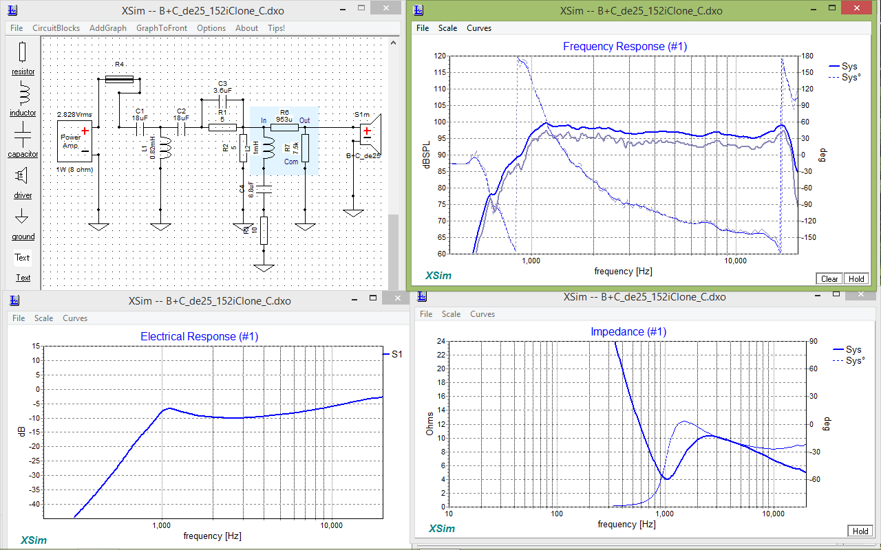

And here's a 2-pole variant.
I'd be inclined to start with this & then see if it could be massaged to work with a 4-pole low-pass.
R4 & C2 are short-circuited ( straight pieces of wire ).

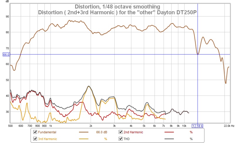

The two earlier plots were not accurate because I was using the crossovers in the PIONEER FH-X731BT.
These new measurements are without the Pioneer. Sweep signal to power amplifier. Amp direct to comp drv. Sweep is with BASS REMOVED to protect drv.
This is the Selenium D220Ti with the Dayton H812 horn.
And here is the Dayton D250P with the H812.
ORANGE trace is 2nd Harmonic
VIOLET trace is 3rd Harmonic
Quite high distortion in the Dayton D250P.

Not really. Look at the response from 9k+, IMO, it is unacceptable.The D220Ti measures much better than it sounds!
I believe Omnimic distortion measurement stop @ 10k.True, some nasty ringing
Does break up not usually show up in distortion measurments?

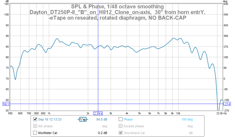

Hi Michael
With a tiny bit of effort I'm quite confident that you can get rid of that (5db) 2-3K suck-out and at the same time improve the distortion spec.( on your D250P drivers) .
I had this raw response ( DT250P on a H6512 ) with an almost identical suck-out ( note "relaxed" vertical scale ) ;
and was able to manage this ( driver now on a H812 horn )( note "critical-viewing" vertical scale ) ;
- The distortion went down to negligible levels after rotating the diaphragm 180deg in the gap ( and ensuring it was re-centered ).
My drivers were eventually sent back due to the back-caps being warped ( & therefore not suitable for SR work when placed inside a cabinet ).
