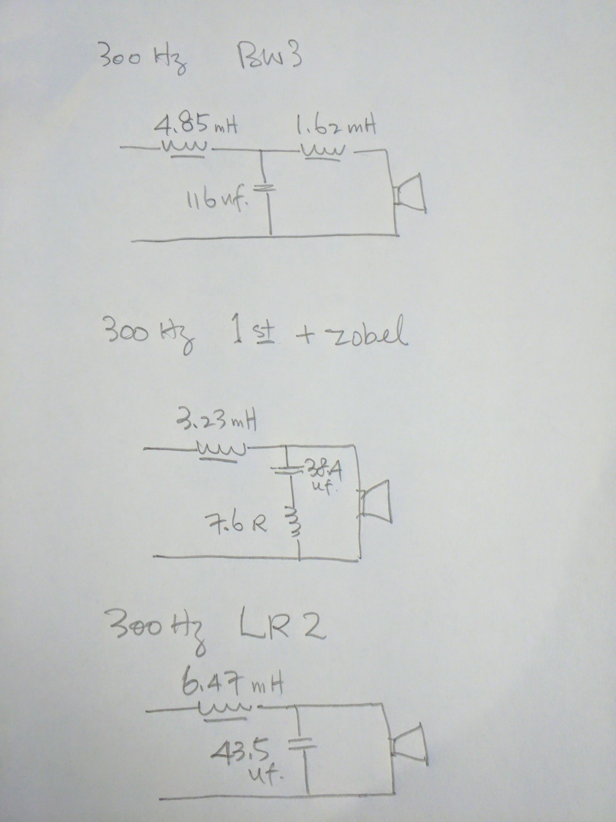

Thanks LineSource,
The size you provide is 3.3cu.ft. I like big box but can I use 4" port for I have that handy. I'm working on the crossover at 300hz with BW3 which actually is your design that I posted couple pages back. I think I am going to change some numbers to suit. Don't know it works or not but I'll post it for your comment.
Regards

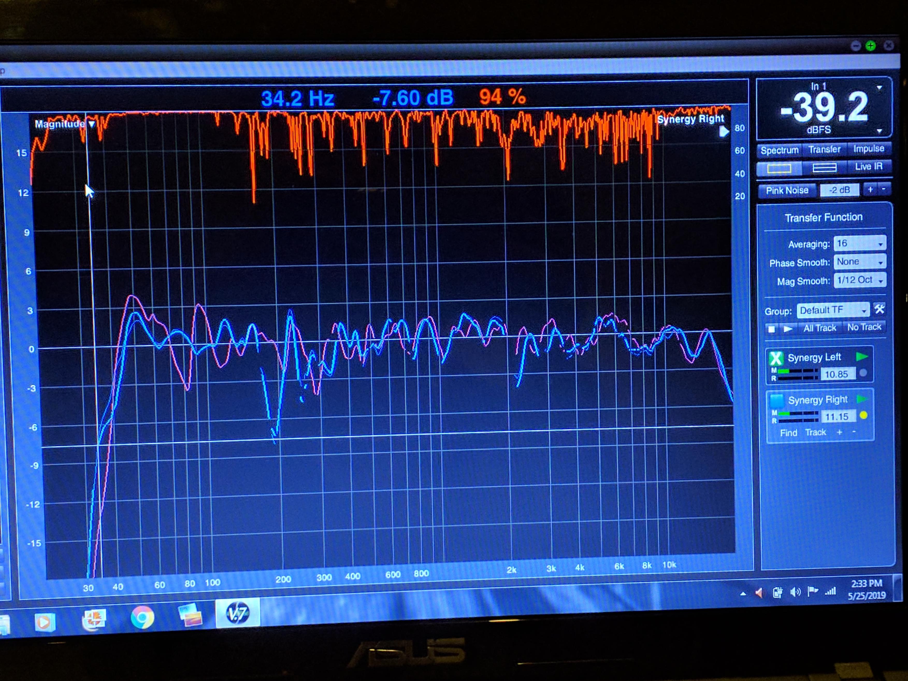

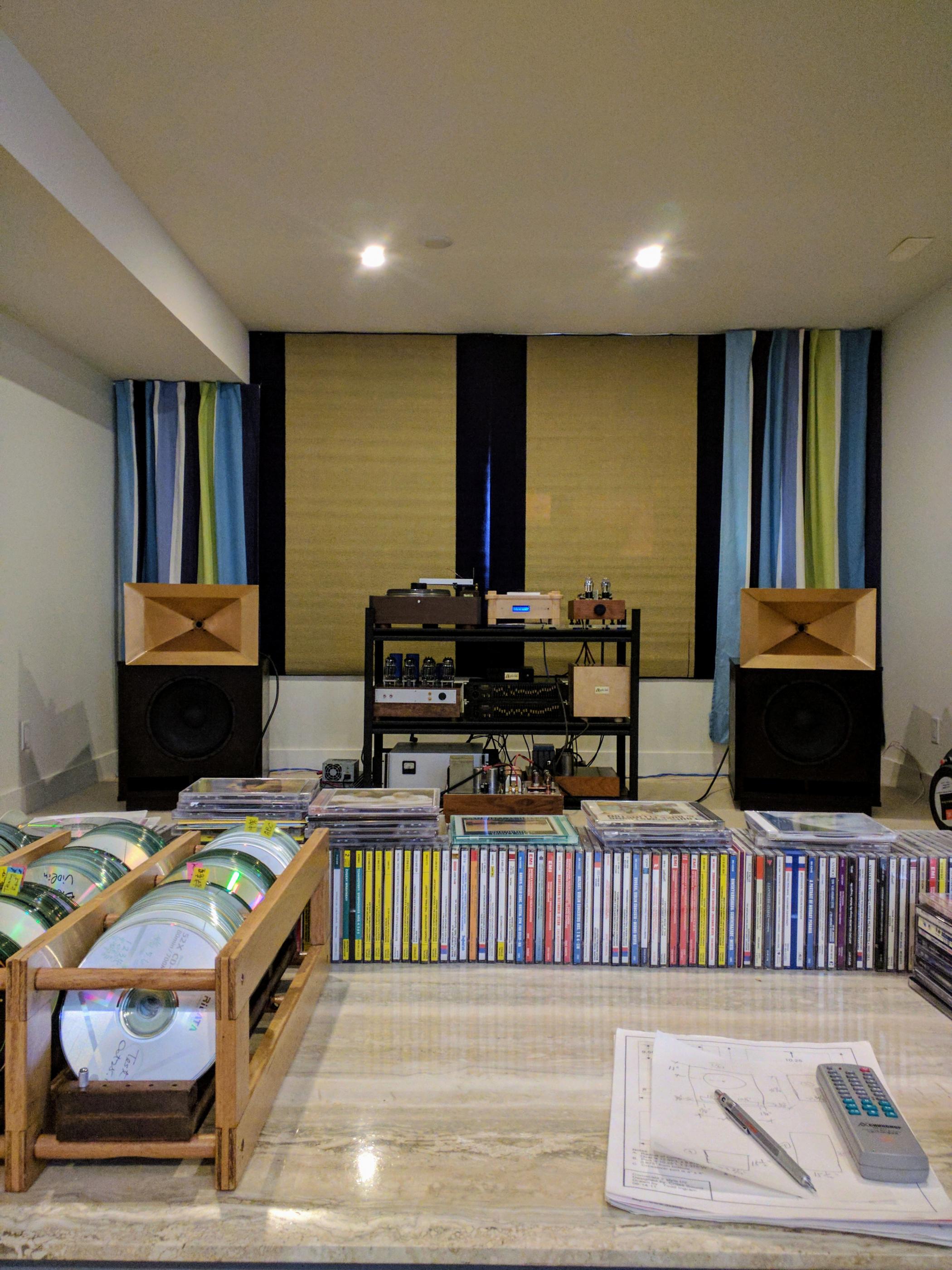

4p1L PSE which I have just finished.
Sorry I forgot the picture
