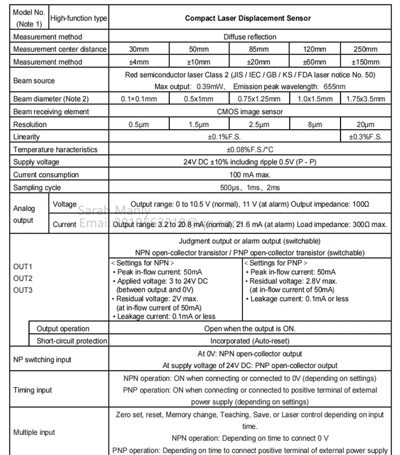

Laser distance sensors with 1-2k samples are in the range of 1000 to 1500 €.
From time to time you can find a useable laser for half the price on ebay (pay attention to the distance range).

I got a 2kHz sampling sensor for about 350 euro on AliExpress.
There's absolutely a ton of these.

One of the things to look out for is the full-scale linearity (% F.S.).
The "full scale" part here can already be tricky. In general, this means the total "reach" of the sensor.
But I have seen some manufacturers cheating by defining this in a slightly different way.
So if we take the ±60 mm as an example: 60 mm in both directions = 120 mm full scale.
With 0.1%, this would mean that the linearity is (0.1/100) * 120 mm = 0.12 mm.
For the ±20 mm version, this is 0.04 mm.
The ±10 mm → 0.02 mm.
Resolution only says something about what the display can show
(it's the same pitfall with digital calipers).
In practice, I don't really see the need to go for more than ±15-20 mm.
However, this is not even the full story.
I have to dig up some papers again when I have a bit more time, but the non-linearity increases as a function of the distance as well as sample rate.
This doesn't even include temp drift and averaging.
Most manufacturers define this linearity with some kind of averaging.
A lot of those LDS devices have averaging on by default, which can really mess up the measurements.
As a very rough rule of thumb, the averaging just lowers the sampling rate.
So if we have 2k samples/s, and apply 2 averages, this means we end up with 1000.
