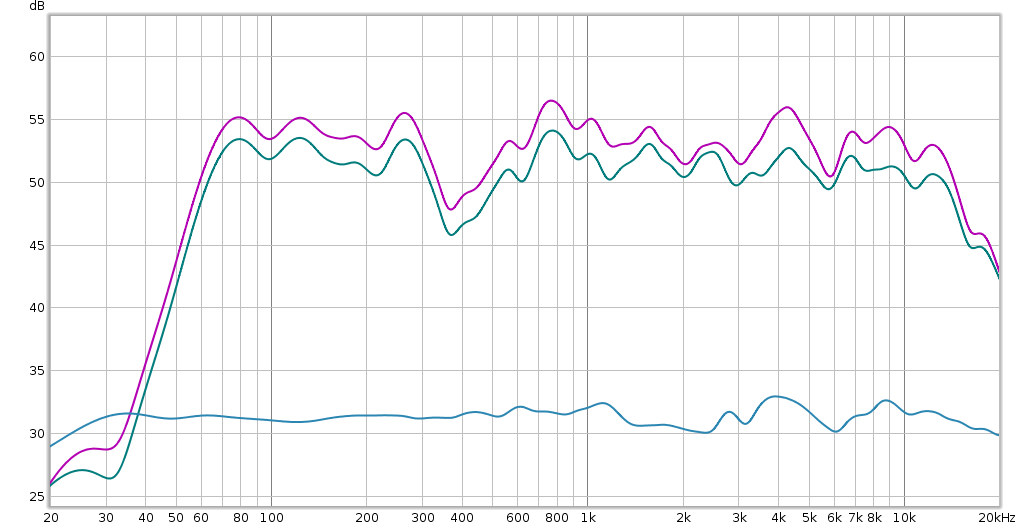

I did the second speaker. Traces from top to bottom are first speaker, second speaker, and the difference. Traces separated for clarity.
Not exactly sure why the second speaker turned out so much better (audibly so). Maybe it has something to do with the way I stuffed the cabinet.
I constructed the crossover differently in each box but they both still buzz at the same frequencies and volumes, so I think I was just hitting the SPL limit for these speakers.
As for the 6KHz notch, it seems to have gone away on it's own...

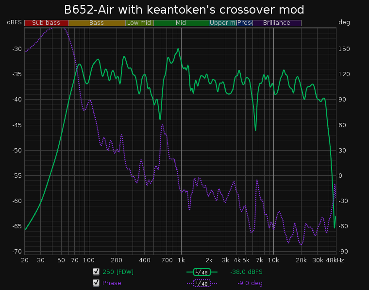

It might just be part of the music. This tweeter works up to 40KHz and is boosted from stock to begin with, so details like that can jump out. I often hear electronic clicks or speaker clicks that were recorded and used in the music and they sound like it's my speaker. It's not, it's just that the tweeter reproduces them so well it sounds like something is wrong.
If there is a problem I would check that the nonpolar electrolytic capacitor in series with the tweeter is not shorted, as that could allow bass content to thrash the tweeter. My crossover uses a much smaller tweeter capacitor, so if it is a feature of the stock speaker the mod will probably reduce it. I listen to these at extra power due to quirks of my listening setup.
Since I actually measured it a few days ago, here is my B652 frequency response. You can see it goes to 40KHz. But the 6KHz notch is back... I really have no idea what it up with that. Note that this is just a measurement at the optimal listening angle which tilts the speaker up a bit to better time align the tweeter and woofer.
