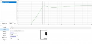

I added WinISD graph.

3. MK402 with the same woofer is half the size of my project. With smaller enclosure this woofer gives more flatter response curve, but my graph shows that it's nothing terrible, that mild hump at 40hz shouldn't affect the sound much? Or would it?
