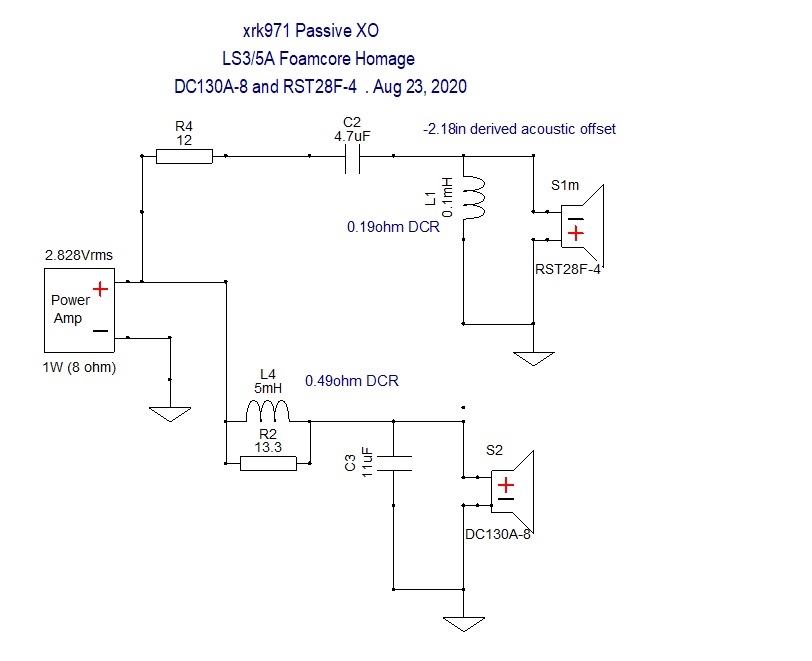

Ill be ordering the drivers and crossover parts tomorrow and as i dont have access to a local shop that sells these crossover components i am looking for final thoughts on crossover.

Guys the parts are finally here!!!!
Couldnt wait and went straight to soldering the crossover and connected one set of woofer and tweeter to the amp with crossover in between.
Well the vocals are as clear as a hot summer day in India and mids are punchy bass is lacking but that is expected as these are not inside an enclosure yet.
I have attached a picture of first test run here and will keep you guys updated as the build progresses.
