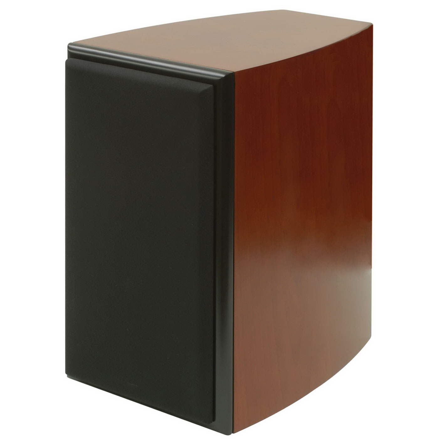

I am itching to build a 2-way with 5.25" woofer, TBD. The tweeter is ScanSpeak Revelator D2902/9900-00 1" dome. I am looking for a pre-finished cabinet for a sealed box. I remember the Dayton Audio Hi-Fi series cabinet sold at Parts Express. To my surprise, PE is no longer carrying them. I went to the Dayton Audio site and they are not there either.
Are there alternate source for them? I found a few cabinet at AliExpress, but they are too expensive and do not fit my project.

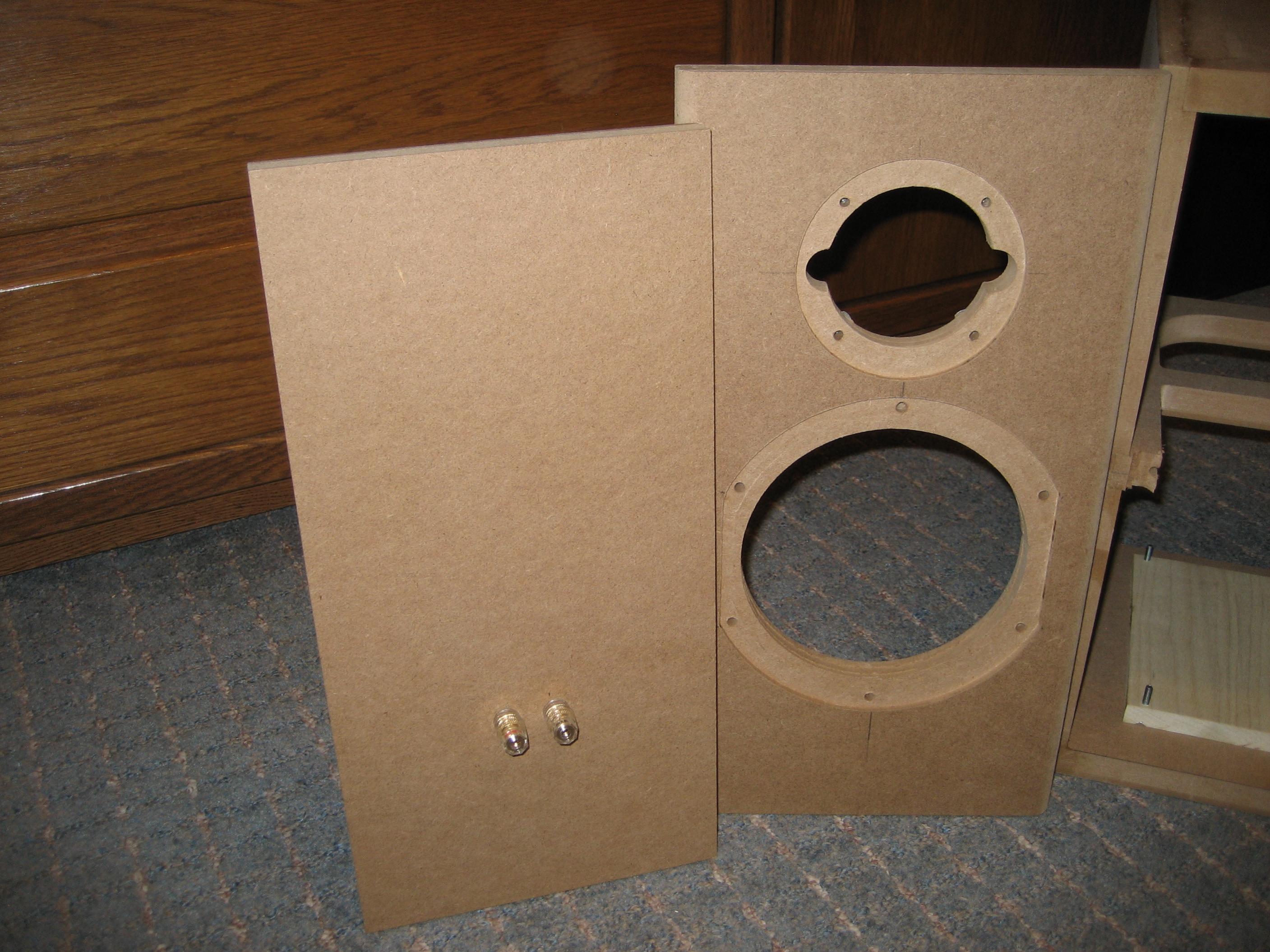

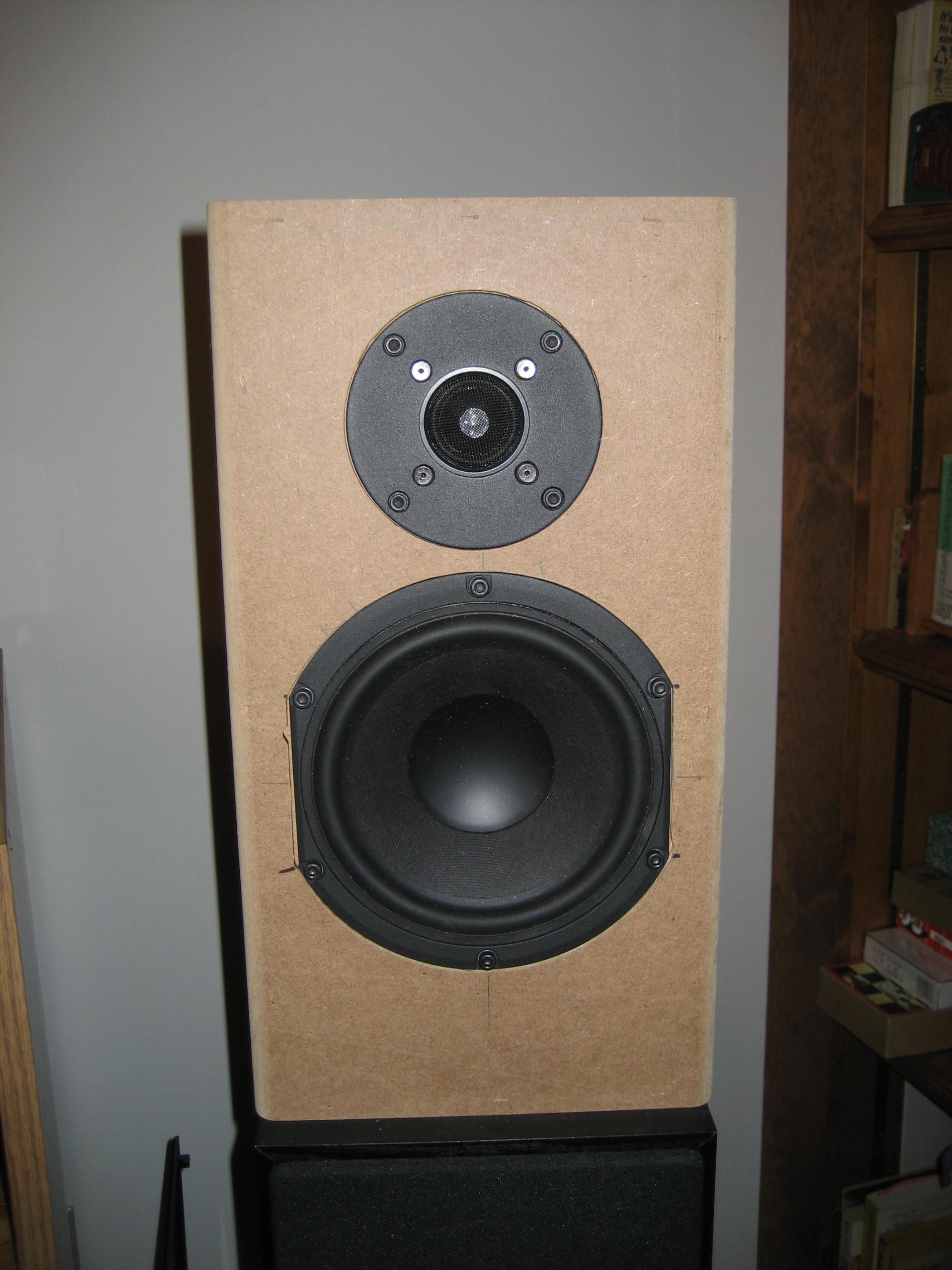

Building the cabinet out of MDF is easy. Getting the right finish is the difficult part. I built 4 6.5" bookshelf with piano black finish. The result is, should I say, less than satisfactory. I followed the process I described in my bookshelf speaker post. They look ok with nice, smooth finish, but the paint chips easily.

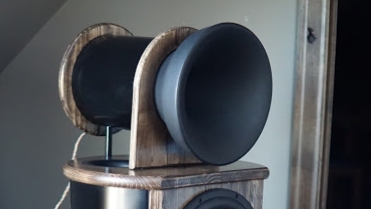

I know this is very uncoventional, but for my next cabinets I think I'll use the same concept I used for the compression driver shroud you see in the photo. The front baffle and rear baffle will be from solid wood circles (very easy to finish solid wood) probably 2" thick to allow huge roundover/chamfer to combat diffraction, and the cabinet walls are sonotube. The beauty of the technique is that the sonotube can be wrapped with either cabinet vinyl (I buy from a local cabinet shop), or my favorite, prefinished aluminum coil (beautiful finish and very durable). Put the seam on the bottom where you won't see it. The tube drops into a groove you route into the end caps. You need to stuff the enclosure to combat standing waves, and devise a stand to hold it. But it is a very easy way to make a nice looking cab.

To the OP's question: Does anyone supply pre-finished cabinets like the ones PE used to sell? I too was disappointed to see that they do not sell them anymore. CSS that used to be in Canada, is a completed different company now and, ALSO doesn't sell them anymore.
I am also bummed out that Parts Express isn't selling those cabinets anymore. They were cheap and nice for making speakers. Not world beater cabinets but for like $100 per enclosure, they were some seriously high value choices.
Sheldon
Sheldon
Has anyone found out why they stopped selling there speaker cabinets? I cannot imagine that these didn't sell .I was hoping to get the MTM but no hope .
Anyway love to find out why they stopped
