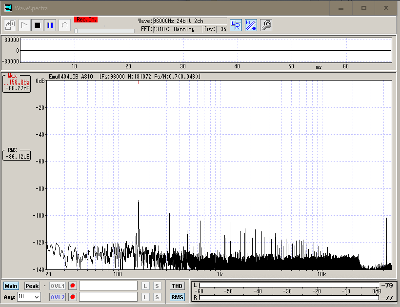

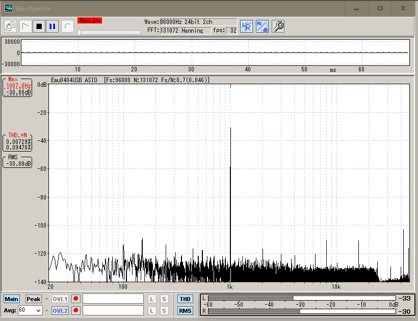

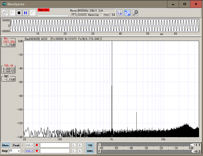

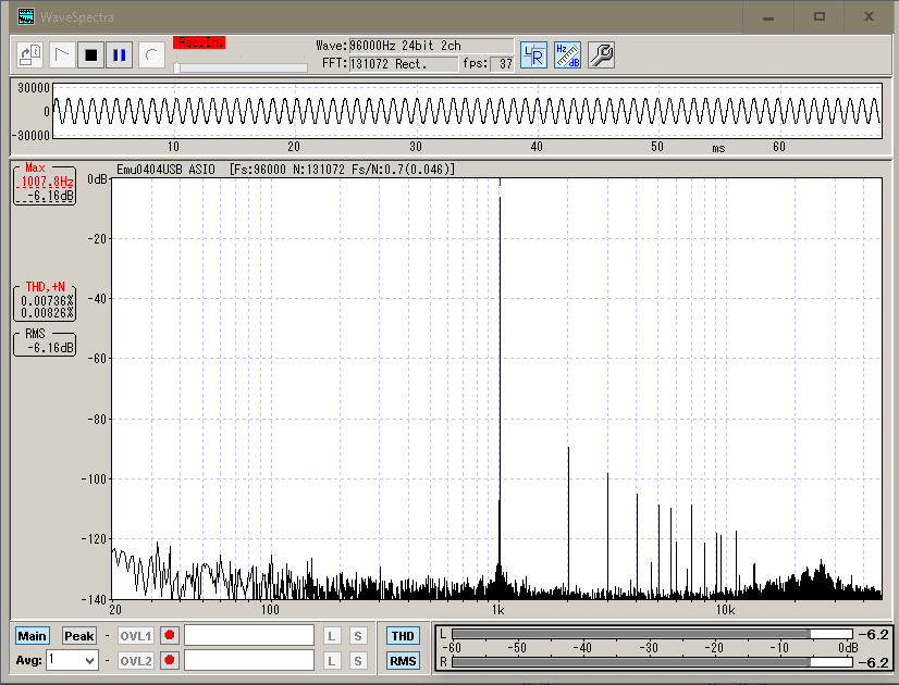

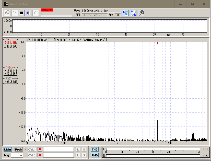

ReMeasured DSP408
Hi Gill.T-San,
I changed my USB-Audio I/F form Roland Quad-Capture to very old Emu0404USB. This is old I/F unit and I made some improving modifications.
First figure is Emu 0404USB DAC to ADC through performance.
The 2nd figure is DSP408 -30dBV Input Distortion performance. 3rd figure is DSP408 Remain Noise Spectrum without Wired Remote. 4th figure is DSP408 connected with Wired Remote.
- Full level input increases distortion more than -30dBV input.
- Wired remote connection increases some harmonic noise.
I hope this information will help to use the DSP408.

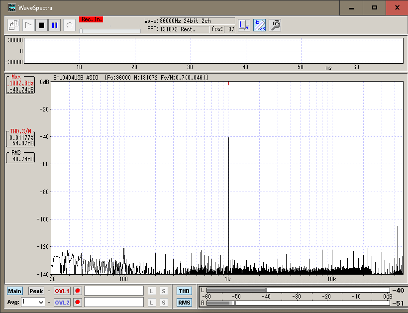

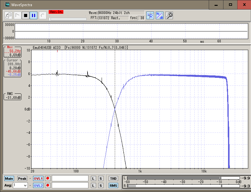

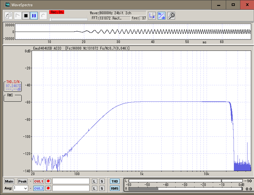

Actual Linkwitz-Reiley 24dB/oct @400Hz Distortion Performance
Hi Gill.t-San,
I guess, you are concerning the actual sound quality of crossover dividing network application.
Attached figures are DSP408 LR24dB/oct @400Hz Crossover Performance
1. 1kHz Distortion (-40dBV, Defeat Through)
2. 1kHz Distortion (-40dBV, HPF@400Hz)
3. HPF Output Frequency Response
4. Crossover Point
(Note)
Figure-4 contains some sags, this is depend on my measurement system, not contained in DSP408 sound output.
I can say, there are very small damage in processing 24dB/oct crossover processing. But the large signal input distortion (above -30dBv) should be consider when using DSP-408 system mean level settings.

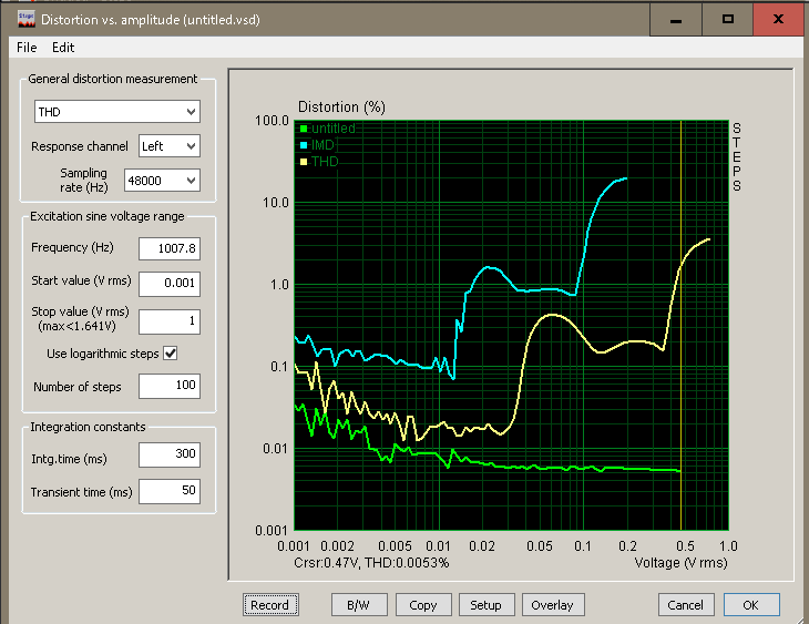

DSP408 Level vs. Distortion
Attched Additional measurement of DSP408 distortions.
THD/IMD vs. Input Level attached.
Untitled green trace is Emu0404USB itself performance.

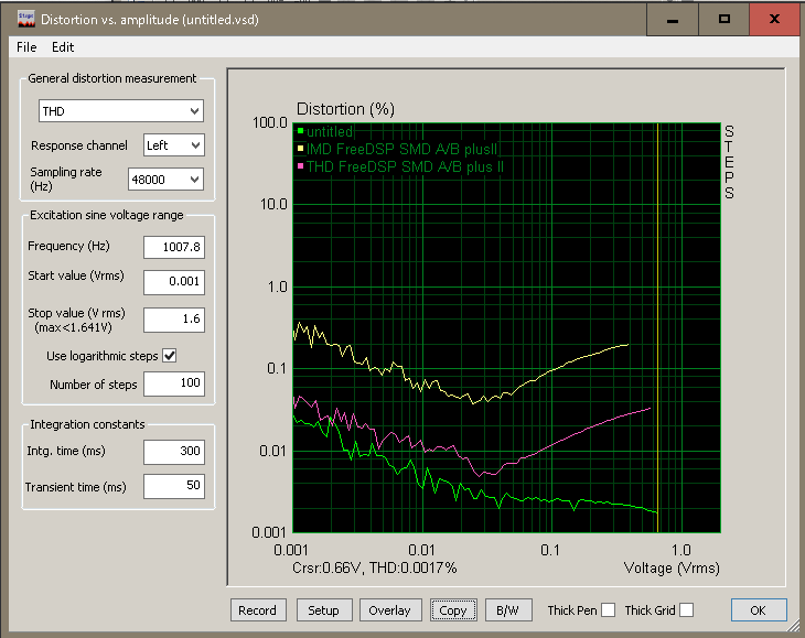

FYI: FreeDSP Classic SMD A/B plus-II performance
To know the ADAU1701 device's audio performance and it's characteristics, I measured my FreeDSP Classic SMD A/B plus II. (Crossover 24dB/oct@400Hz HPF output)
1st figure is IMD/THD vs. Input Level. (Green trace is 0404USB it's self)
2nd figure is 1kHz Sin-wave 1.8V input distortion performance.
3rd figure is Remain Noise Spectrum.
Comparing this measured result and DSP408's result shows, there might be some room to improve the Large level signal input distortion performance of DSP408.😉
