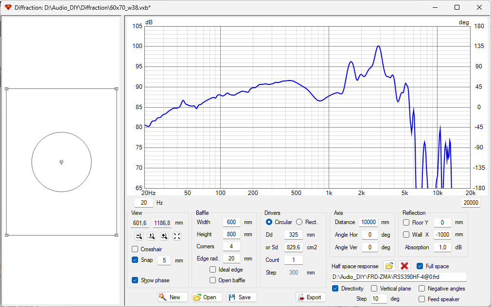

Dayton Audio 3-way Speaker 90dB with RSS390HF 15" in VituixCAD
Drivers:
ND25FA-4 1" Soft Dome Neodymium Tweeter 4Ohm 90dB fs=1350Hz
Crossover 3000Hz
SIG180-4 6-1/2" Signature Series Woofer 4Ohm 91dB fs=40.5Hz
Crossover 200Hz
RSS390HF-4 15" Reference HF Subwoofer 4Ohm 91.2dB fs=19.5Hz
Links:
https://www.daytonaudio.com/product/1196/nd25fa-4-1-soft-dome-neodymium-tweeter-4-ohm
https://www.daytonaudio.com/product/1916/sig180-4-6-5-signature-series-woofer-80w-driver-4-ohm
https://www.daytonaudio.com/product/126/rss390hf-4-15-reference-hf-subwoofer-4-ohm
Sealed Box Qtc=0.707 Qts=0.43 Vas=212liter
Vb=124liter
Fb=32Hz

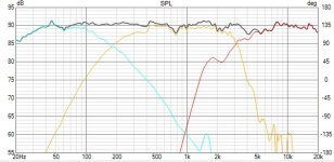

SPL in VituixCAD:
Drivers:
Crossover 3000Hz
Crossover 200Hz

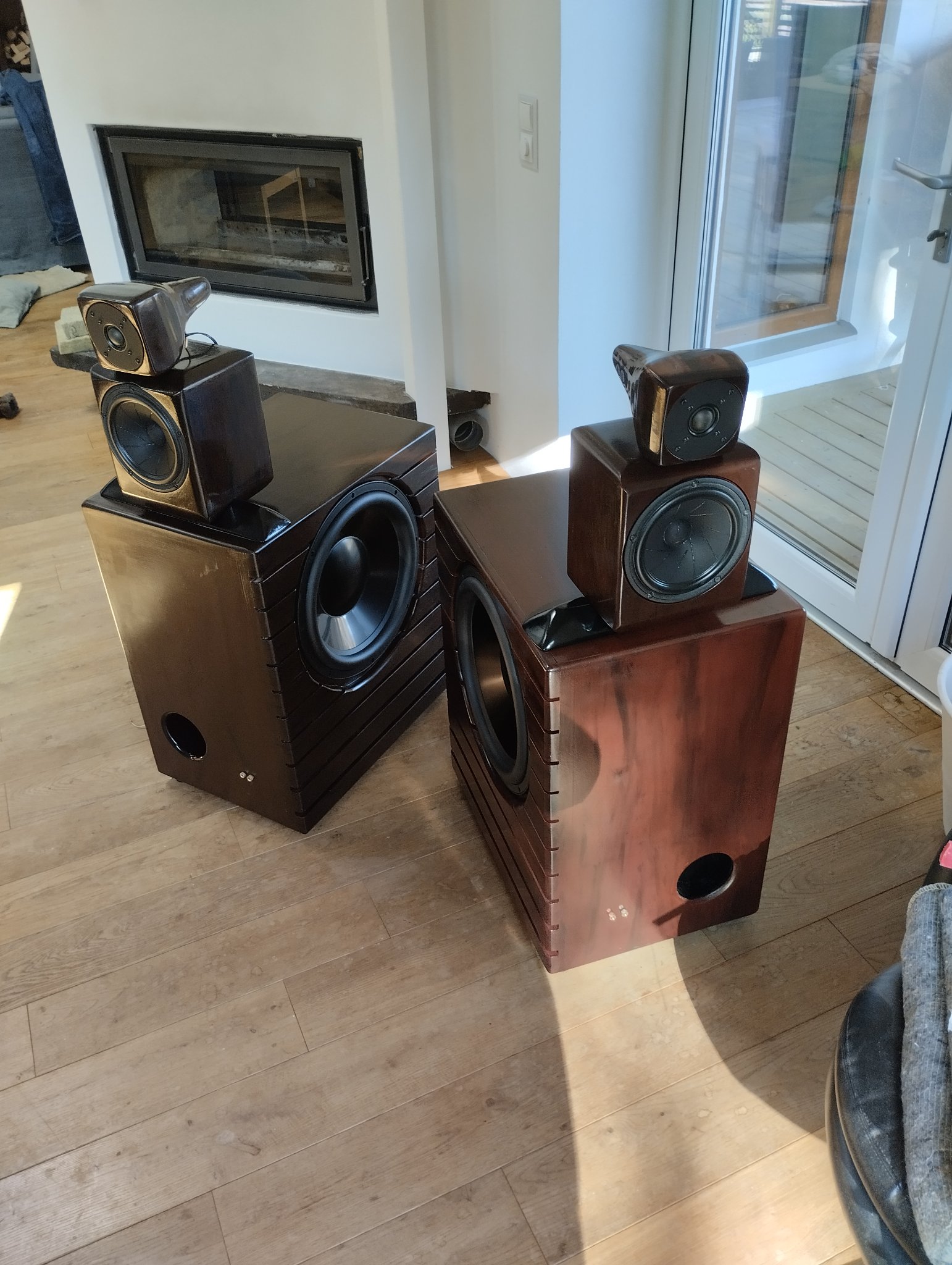

Your drivers is quite like my last diy.
Used the RSS390Ho-4 15", the SS 18M 4634t00 and a SS 9300 tweeter.
The RSS390Ho-4 in 100 liter ported, tuned to ca 22-23 hz
xover att ca 240 and 2600 hz (tried RSS390Ho-4 playing sideways, but little more ump playing forwards)
It´s a real nice combo!
For "near" lifelike experience on good recordings, from 2,9 meter listeningdistance.
Drumsolo kicks your chest 😀

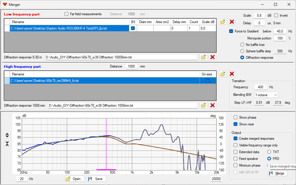

Can somebody create a SPL curve with RSS390HF and SIG180 with the diffractions.
The sealed enclosure is 124liter and for SIG180 9.4liter.
The baffle is 450x1000mm and the crossover is 200Hz LR12.
I have tried everything but can not get it to work.
I don't know how accurate you think a sim is without actually measuring. If you build it, you would need to measure each driver, and go from there. If you are just looking for a starting point, you can try what I suggested in post #8. Plan for the response above 1k to be 86dB. Then adjust the woofer low-pass, and mid high-pass for a gradual transition from 86dB at 1k, to 90dB at 100hz. The real speaker response will have baffle step, so the bass at 100hz will be lower than what it looks like in the sim.
