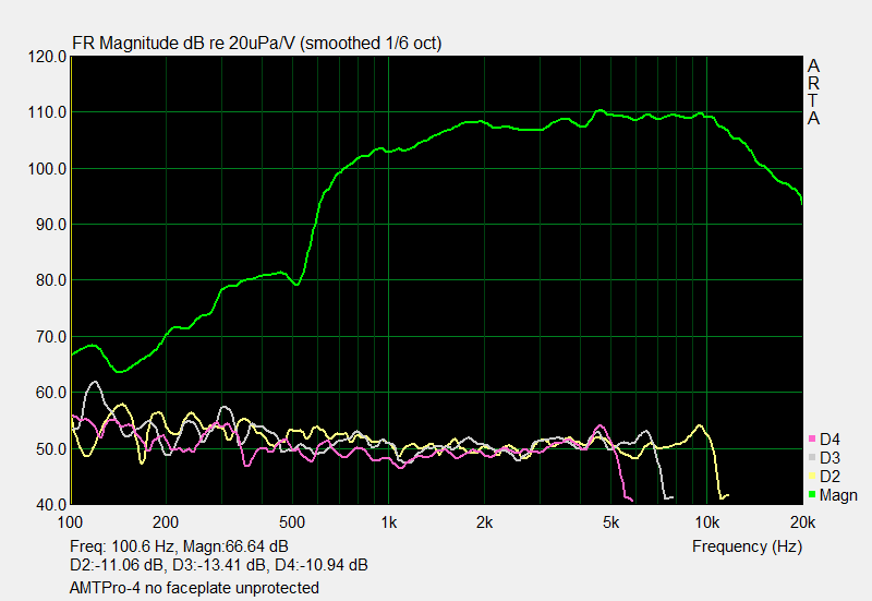

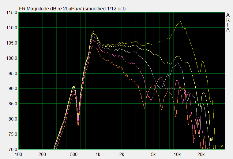

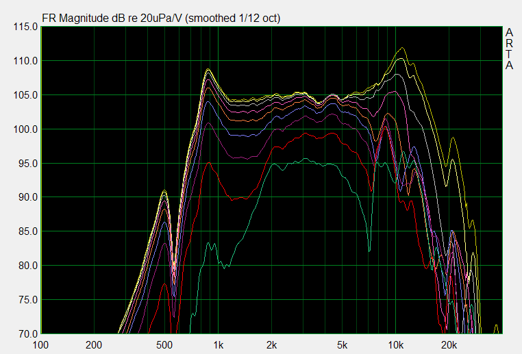

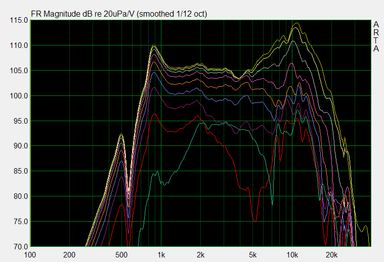

OK, here are my measurements on the AMTPRO-4. I collected all this data by suspending the driver in free air and using gated impulse measurements. I was able to get about 50Hz frequency resolution using this approach. For the HD and IMD measurements I did not check the level but I would estimate that it was at least 90dB@1m with the "10dB louder" HD measurement increased by that amount.
Conclusions:
This is a unique driver in that the front and rear frequency responses are similar, and the rear response is without peaks or nulls above 2kHz (this is often a problem with a cone driver because of the magnet and backet). Because of the length of the diaphragm the vertical response is already starting to narrow around 2k-3k Hz but this is about the only shortcoming of the driver when used in this way. The distortion is pretty low between 1kHz and 8kHz and this distortion profile remains about the same when you increase the SPL another 10dB. IMD also looks good. Based on the harmonic distortion plot I think one could use this driver down to 1.5kHz if crossed steeply. Where to cross over to a tweeter depends on how close you want to get to the high end distortion rise, narrowing response pattern and diverging response between front and rear.
NOTE: to figure out which plot is which, hover the mouse pointer over the attachment thumbnail and then look for the name at the bottom of the browser window.

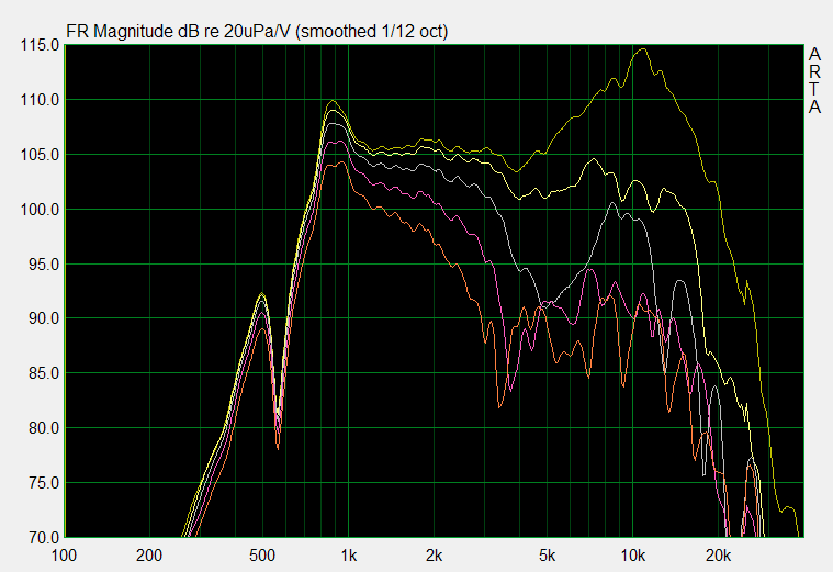

- Horizontal FR at 0deg and about every 11 degrees off axis until 90 deg, taken in FRONT of the driver at a distance of 16inches (0.4m)
- Horizontal FR at 0deg and about every 11 degrees off axis until 90 deg, taken in BACK of the driver at a distance of 16inches (0.4m)
- Vertical FR at 0deg and about every 11 degrees off axis until 90 deg, taken in FRONT of the driver at a distance of 16inches (0.4m)
- Vertical FR at 0deg and about every 11 degrees off axis until 90 deg, taken in BACK of the driver at a distance of 16inches (0.4m)

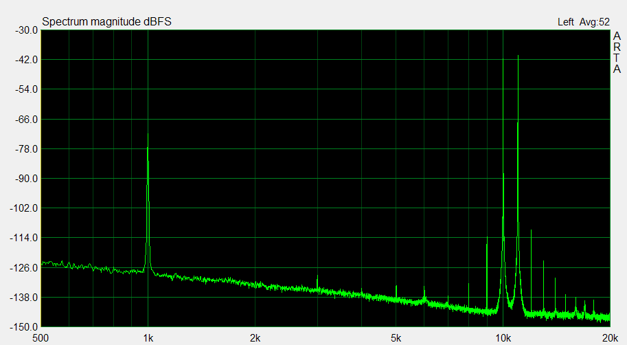

- Harmonic Distortion vs frequency on axis in front at 16inches (0.4m)
- Harmonic Distortion vs frequency on axis in front at 16inches (0.4m), with level increased by 10dB
- IMD (using 10kHz and 11kHz tones) on axis in front at 16inches (0.4m)
Conclusions:
Dayton AMTPRO-4 0-11-22-33-44-55-67-78-90deg 16in front.PNG41.3 KB · Views: 1,895
Dayton AMTPRO-4 0-11-22-33-44-55-67-78-90deg 16in rear.PNG43.3 KB · Views: 1,840
Dayton AMTPRO-4 0-11-22-33-45deg 16in front vertical.PNG35.8 KB · Views: 1,895

CharlieLaub's horizontal polar plots (1st attachment in post 5) of the AMTPRO-4 are pretty odd in the 1-5kHz range. A waveguide might improve this.
...so my plan is to try both of these ideas. I can rig a crude test horn up from cardboard (or maybe just angled "wings"), so it won't cost me anything to try it.

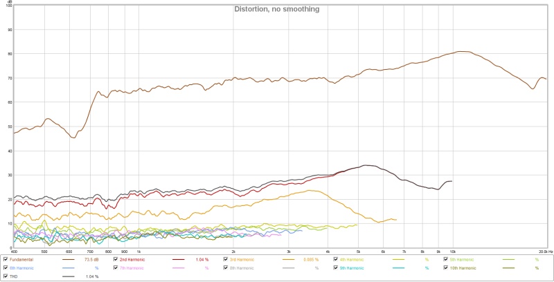

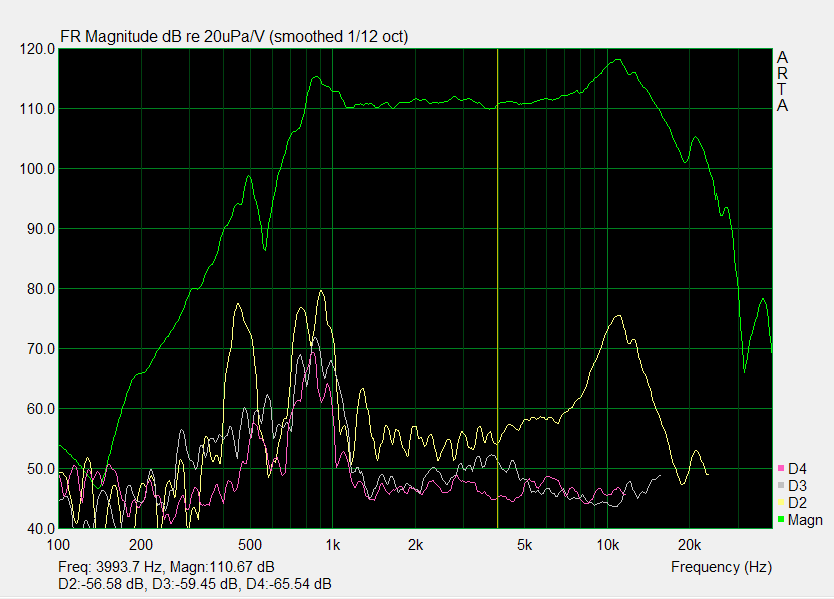

I dug my drivers out of storage, and gave this a go. For the LF and distortion, I measure roughly similar results to these:
AMT tweeters - explored by Critofur -
Techtalk Speaker Building, Audio, Video Discussion Forum
...but for HF, I got the same hump centred at 10kHz that CharlieLaub measured.
Taping over some of the slots (to make the radiating area less symmetric) smoothed the response and partially flattened that 10kHz hump.
Using foam to mask the driver ends extended the HF, but only a little (about 1.5kHz).
I then used ~4dB of digital EQ to cut the remnants of the bump. The result of the 3 tweaks was flat from 800Hz to 16kHz.
Huge caveat:
This was true only for a close (50cm) on-axis mic.
For actual listening from a couple of metres away, the tweaks seemed to do nothing for dispersion. I got one configuration to sound quite good, but only when right on axis.

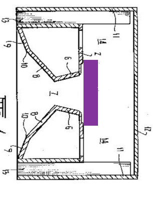

an interesting construction/frame around it that seems to be open to the front and back
That appears to be just for attaching grill cloth to (cosmetic only).
a waveguide [...] maybe the best way
Probably something like this. To make them usable (for me), it'd need some type of horn that improves the dispersion.
i.e. one that has a diffraction slot to spray the HF around a bit, like in this picture I hacked together.

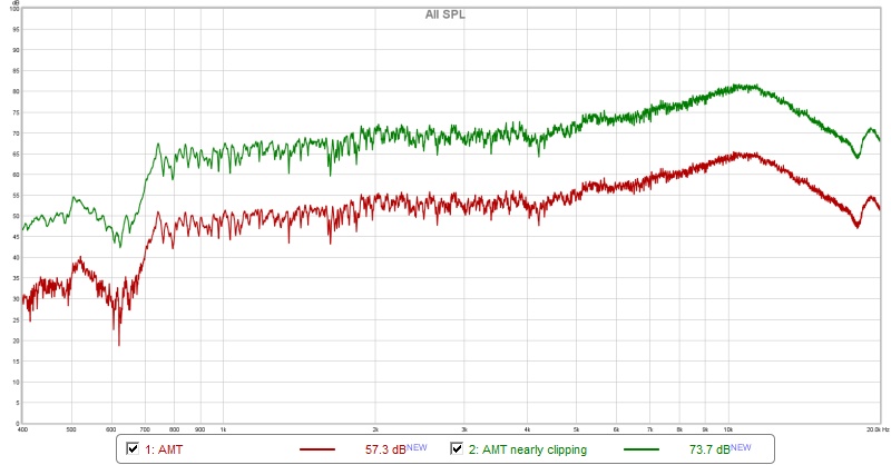

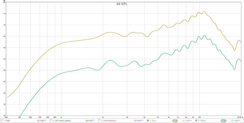

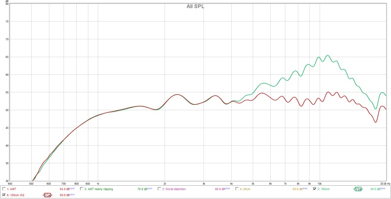

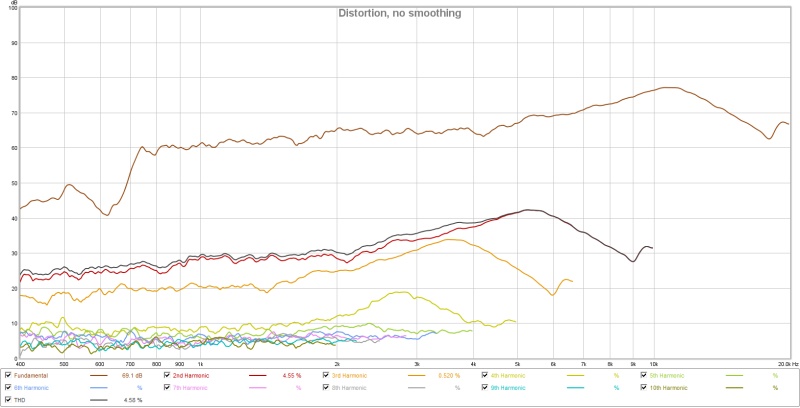

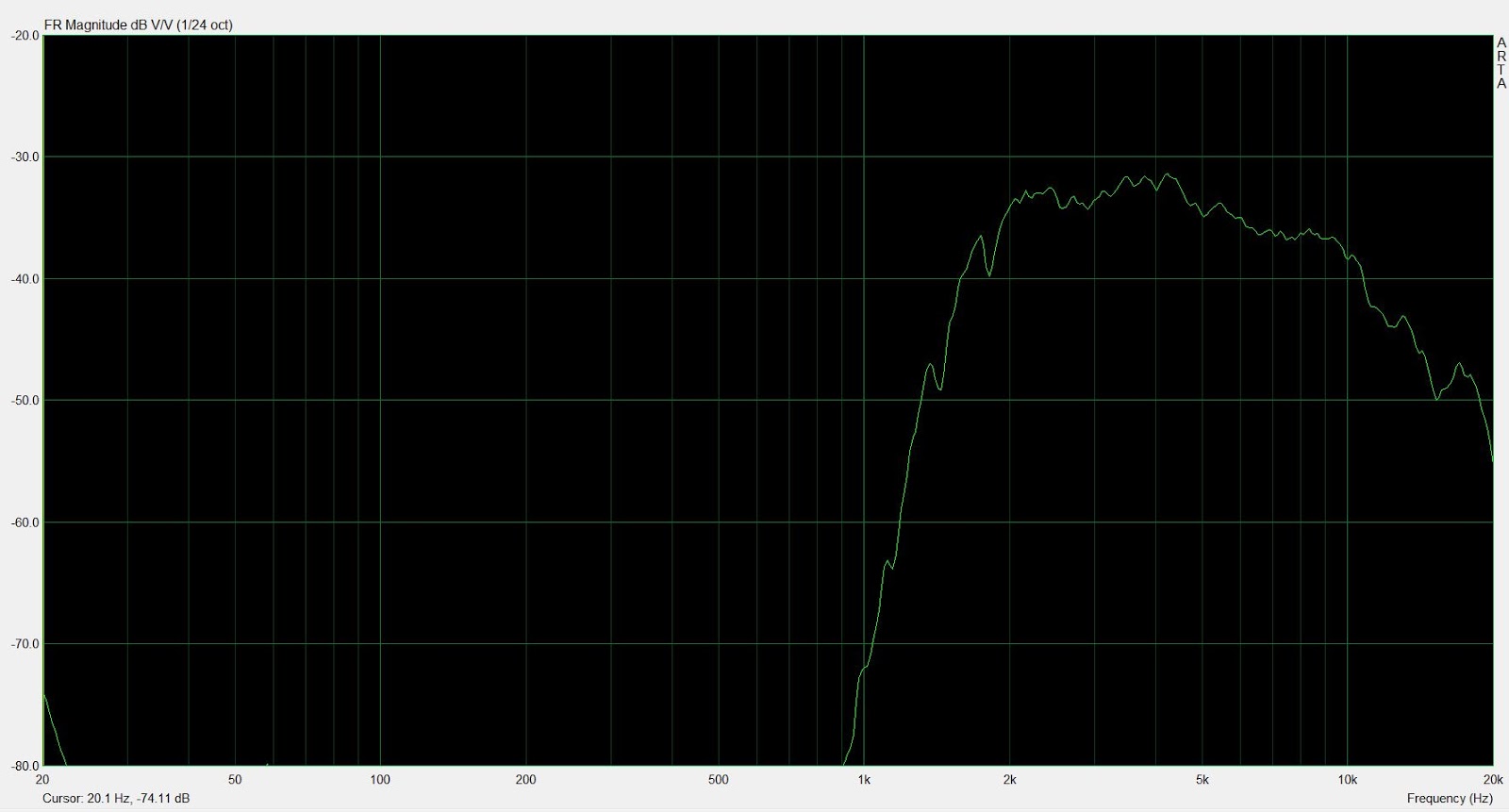

I just made some more measurements, all but the last are on axis.
They were done under hillbilly test conditions - mic tripod on a stack of milk crates in a cluttered room, SPL not calibrated. Bare driver (no face plate) perched on a stack of objects.
1) direct unsmoothed SPL plots @ about 35cm.
Red line is with about 15dB headroom, green with 1.4dB headroom (almost clipping).
This is not bad.

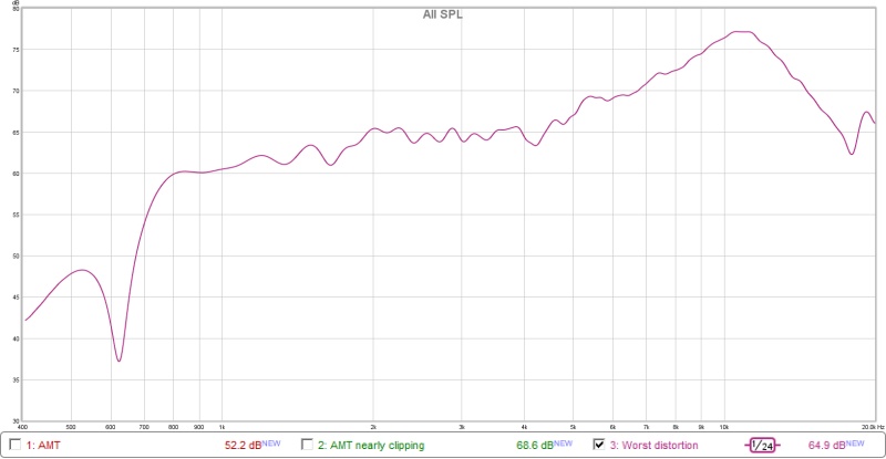

2) Distortion under the above loud condition (almost clipping).
This is not bad.
PC fans and other ambient noise mean my noise floor is pretty high.
3) Distortion as above, but with bad gain structure: I turned REW down by 25dB, and turned the amp up by about 20dB.
The minor bulges you could see on (2) are now about four times as bad... so the distortion appears to be largely an artifact of my PC + amp.
4) The SPL plot of the last test (bad gain structure), with windowing / smoothing to. I also zoomed in here - the grid is 5dB divisions, rather than 10dB.
It is very non-flat, but looks easy to fix / EQ.
5) 20cm vs 1m SPL plot, with windowing / smoothing and same amp settings.
6) The same 1m SPL plot, as above, before and after applying EQ (-6dB centred at 10kHz).
It is indeed easy to EQ flat.
7) as above, mic on axis compared to mic raised by 30cm.
TL;DR:
The driver is well behaved, but only on-axis. As soon as you go off the vertical axis, the HF dies.
I assume this flaw / feature would be ~the same for any planer driver of these dimensions.
AMT SPL plots 15dB from clipping and 1.4dB from clipping no smoothing no filter no nothing.jpg86.6 KB · Views: 392
