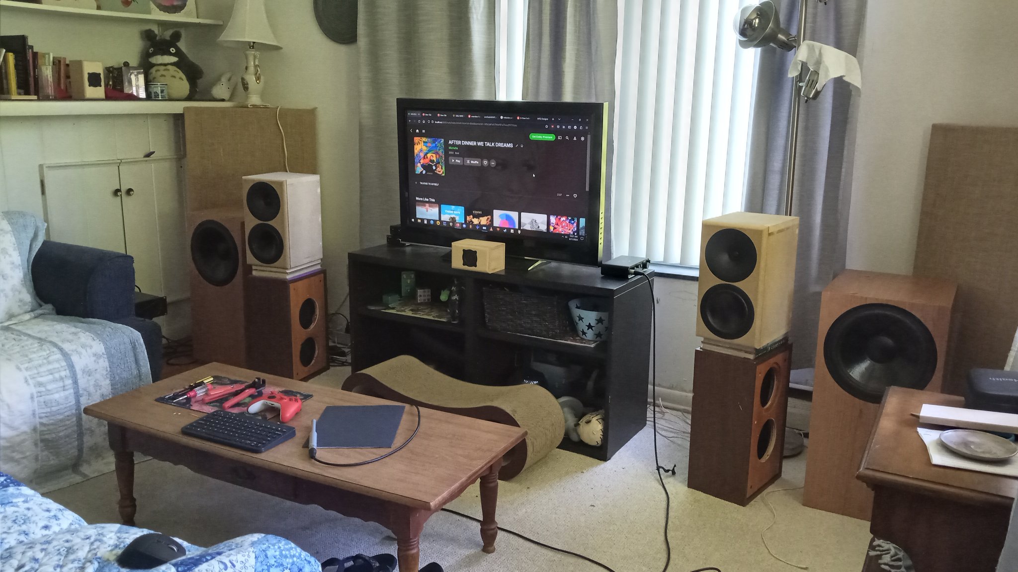

Curious what you did with the base cabinets. Judging by the size, looks like you went ported? Where are the ports? passive radiators? How are they tuned? How do you like the low-end?
They're just big sealed boxes, can make them ported in the future if I want but sealed is simple. My rooms somewhere like 16x25ft, but the back opens into some hallways and a kitchen so not sure how long it really is acoustically, but I appear to get extension down to 20hz. Iphone niosh app says we top out at like 85db at the LP about 6-7ft away, any louder and I get fatigued pretty quick. Bass is a bit uneven due to the room but I have two 10" subs to my rear I can turn on that evens the low end response throughout the room really well.

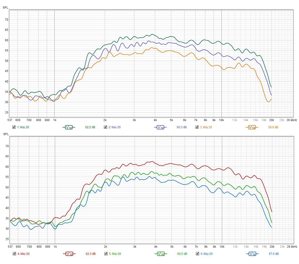

That kind of minimal shallow waveguide doesn't beam too much. Your hor-polars show there's wide dispersion around 4kHz and more directivity between 1-2kHz in mid's upper range. Typical for quite large mids. I have used 5" mid crossed 3500Hz to non-wg tweeter and get same kind of changes but just at a bit higher F. https://www.diyaudio.com/community/threads/avalanche-as1-modernization.321711/post-7235489

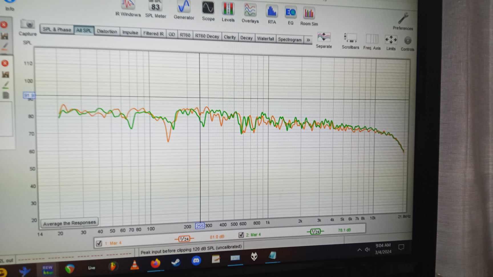

Really smooth room response, do you have a very large padded room or did you use lots of low end room-eq?

Haven't shared any info with the bigger waveguide, all that other data is with smaller nd25fw.
Not much in the way of treatment in here, just some curtains on one side, some triangle shaped 4ft tall bass traps in the corners and a rug. I have just two filters on the the left woofer and three on the right. The shot is a 10db scale so probably looks a little better than it is. Room is pretty mismatched, right wall is bricked and drywall with a big window, left is a fireplace and a really weak wall that rattles that I need to figure out how to secure. House was built in the 60's for my gf's grandparents and they were pretty unhappy with the construction. I've found several places where there's just no studs behind the wall making treatment mounting tough.

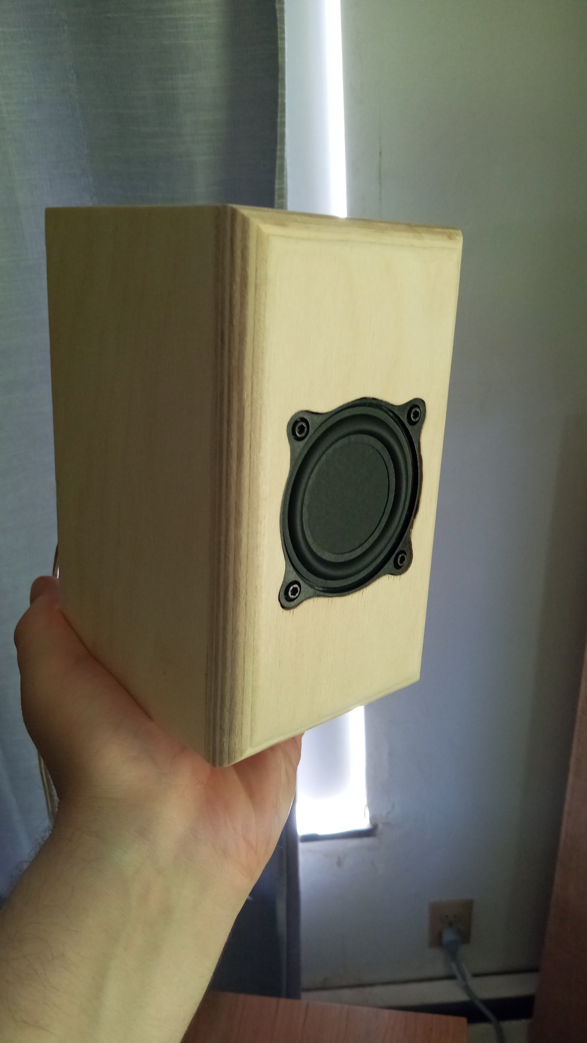

I was bored the other day, always wanted to try the BMR drivers I have. What are these things?! I just slapped them on top of the woofer box with a high pass and my word, what impressive sound from a single driver. These guys are really giving me the mid range width I feel more familiar with. The wg300 is amazing, but again it just doesn't make the sound expand outwards enough. I'm definitely nit picking here.
I've mostly moved the woofer boxes to the side to act as subs, as I felt anything I stacked on top of them was too high, felt like the speakers towered over you and I don't care for that. Had to many rattle issues with boxes sitting on top of each other.
