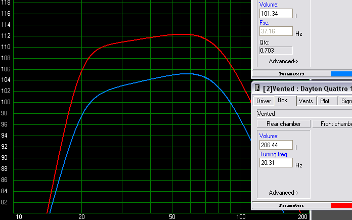

For interest I modelled the 15" quattro in WinISD pro. I did two options - sealed and vented.
Sealed box - 100L - max SPL 103db @ 25 Hz ... 111 @ 40 Hz
Vented box - 205L - max SPL 112db @ 25 Hz ... 113 @ 40 Hz
tuned at 20 Hz
For double the volume, the vented box offers little more for music as most music is above 40 Hz (at which point the 2db difference in max output is barely audible).
With this driver in either of these boxes, the 250w plate amp should have enough power. Xmax is reached in the vented box at just over 200w @ 30 Hz. Xmax is reached in the sealed box at 160w @ 20 Hz but 300w is needed at 40 Hz.
The chart shown compares vented vs sealed. The sealed box has a linkwitz transform to match the extension of the vented box. The output shown is for an amount of power supplied to each that will not exceed xmax above 20 Hz (*note: shown at 3m distance, not the usual 1m ... add 9db for output at 1m). This makes the vented sub look louder than it may in fact be. For music, the sealed sub will handle much more, but is SPL limited when it needs to get down to 20 Hz - so this shows the kind of output you will get if used for HT. For music, the extension and output will be barely any different.
You will notice a downward slope of the response. This is a good thing as it will probably match room gain, resulting in an inroom response to below 20 Hz.
Unless you want both loud and low (HT LFE use), then I'd go with the sealed box. The Quattro is a value for money sub and I doubt you could buy anything comparable.

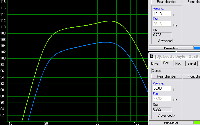

If you are using a sealed box with a Linkwitz transform, then you can easily make it half that volume - 50L. Here is another chart which shows 100L sealed box with LT (blue) vs a smaller 50L box with LT (green). The smaller box has more power applied so that xmax would be exceeded below 40 Hz.
A 50L box such as this would be approx a 420mm cube, allowing for 18mm MDF walls, some bracing and some volume for the plate amp and driver. Ideally you would make it a little bigger and build the plate amp into its own chamber - this saves any hassles with air leaks where the plate amp is mounted on the box. Speaker cables can be conntected through screws through the internal wall.

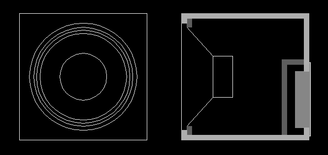

Here is how I'd build it. 450 x 450 x 450 mm looks about right and gets a good volume - with sealed you don't have to be too fussy. A separate chamber is shown for the plate amp in the back.
Bracing is not shown. Ideally you should have 3 intersecting planes of bracing, so that each sheet will touch 4 sides of the box. You will of course have to cut them around the driver and the amp chamber. You will also have to cut holes in them so the woofer "sees" the whole air volume behind it.
hi paul, that looks good to me. i guess on the amp chamber, it just needs large enough with a little clearance and centered on back of box? i've downloaded WinISD alpha but, some of the paramaters it wants, i couldn't find in the parts express pdf specs but, i'll keep trying to learn to use the program and maybe i'll figure it out he he. thanks again, crippledchicken 🙂
I'd put it towards the bottom as it's simpler that way as shown in the diagram section.
