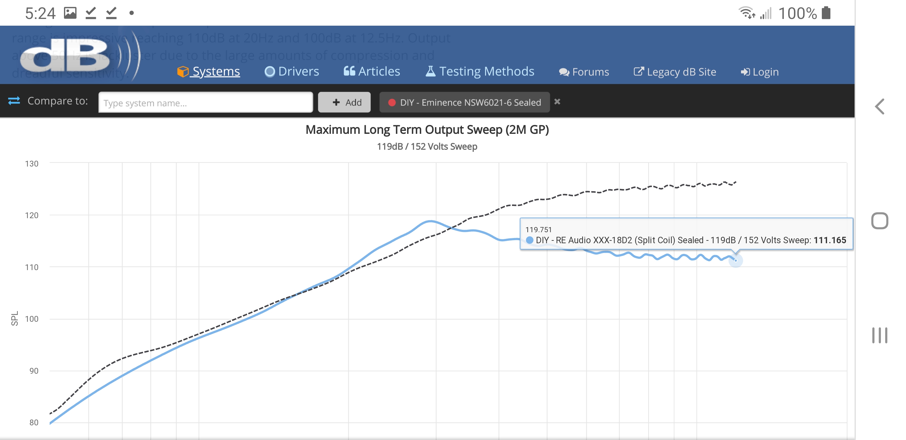

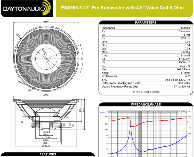

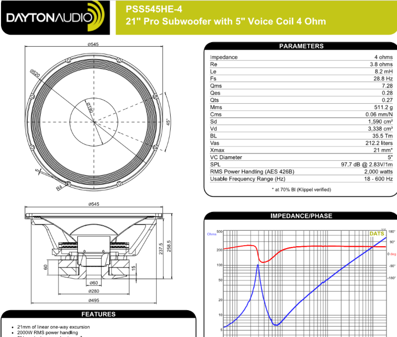

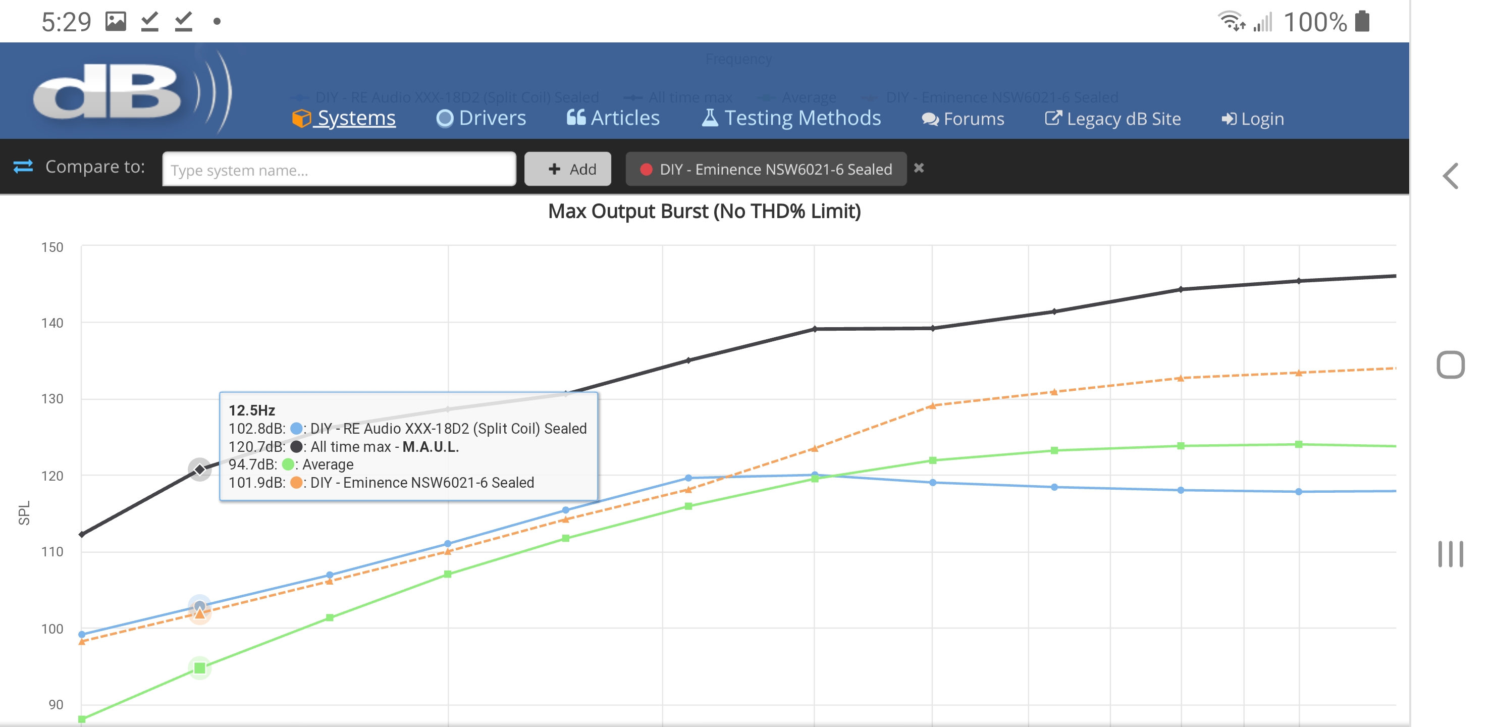

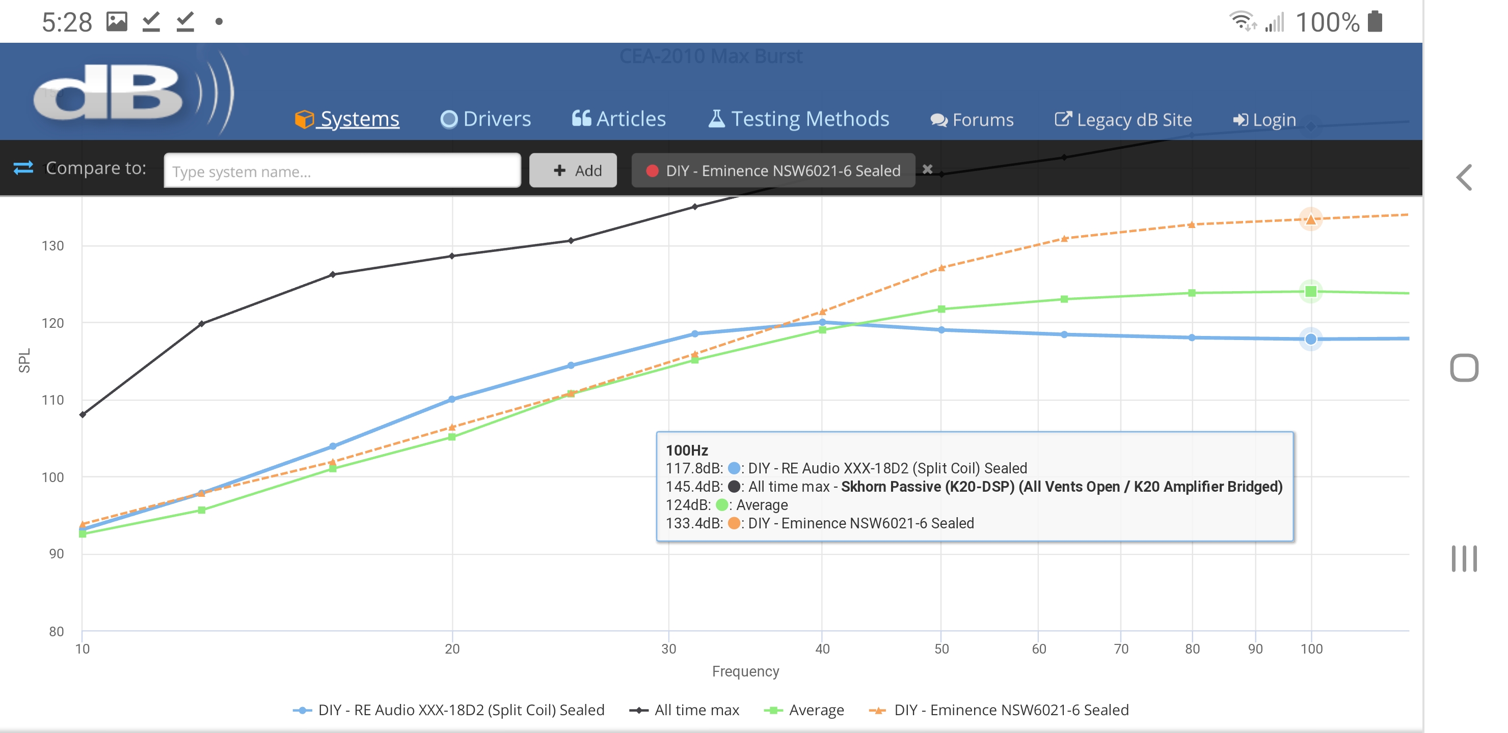

It's an interesting driver.

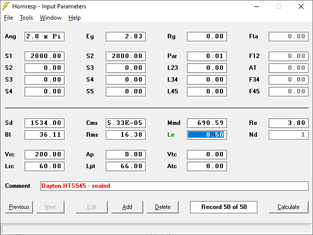

Don't expect it to be useful above 60 Hz, at least that's what the sims say.
Indeed!
Looks OK higher up in an offset driver ~236 L 2:1 CR pipe, otherwise end loaded does too.
GM
Don't forget to include the semi-inductance parameters in your sims. They can make a significant difference in the response curve for high Le drivers like this one.
