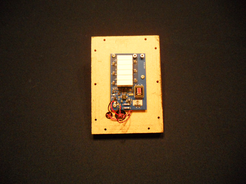

When you measure your Bias voltage make sure that it is a very high resistance probe as most are anyhow.
I have found in the past that if the resistance is too low the supply may not be able to supply enough current and give you a false reading as much as 20% lower or more.
The one I designed uses 30 X 10meg resistors and uses a opamp buffer to isolate the meters impedance.
It can be used without the buffer as well.
I individually measured each resistance and added a trimmer for precision adjustments but this is not necessary to just find out an average reading of the bias supply.

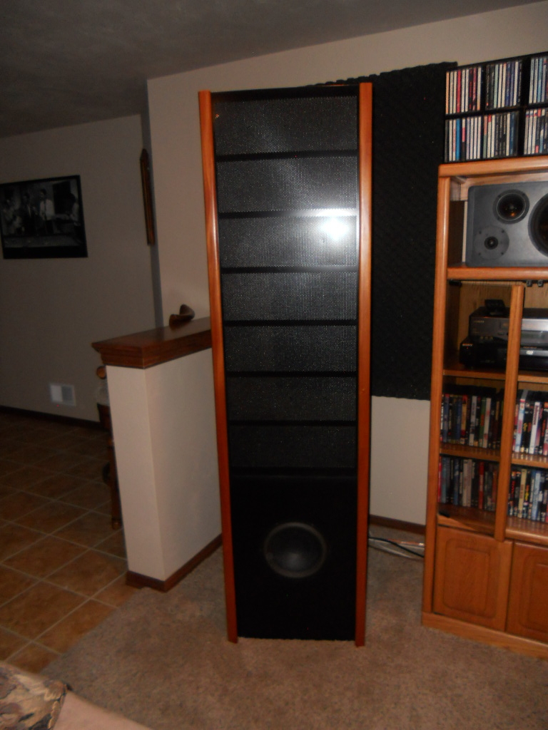

The Lincane (gold-anodized aluminum) was sprayed with one coat of Rustoleum (hey, I'm still learning...) A thicker coating might be a good idea, but I don't have the capability to use automotive sprays or powder coats. Will have to investigate what I can do about that. Also, I think the perf pattern is too small. I remember reading somewhere that Lincane is 40% (ratio of holes to metal) and that isn't good from what I've read in this forum. I will definitely switch to other perf panels such as those used by Jazzman.
I expected a narrow sweet spot with these ESLs and tried to compensate by building four panels, which helped. Haven't tried rotating the panels vertically...might give that a shot.
Merry Christmas everyone!
Your (4) 2'x3' panels provide over twice the surface area of my (2) 1'x4' panels-- and my panels can play pretty loud so I figure either 1) your panels use lower bias voltage or the diaphragm coatings are weak or 2) your concept of "loud" is louder than mine. Judging by the apparent thin coating on your stators and 1/16 d/s spacing, it seems to me you'd be getting a whole lot of arcing if those power supplies were putting out anywhere near the 10KV advertised.
Since flat panels are so directional and yours are relatively short and low to the ground, I wasn't surprised by your comment that you needed to sit on the floor in front of them to realize their full impact. Also, that transformer core size does not appear adequate for good bass output so you may be saturating the transformer before reaching the desired volume, especially if you are running all (4) panels with just those two small transformers.
One advantage to a tall panel is that it approximates a line-source at ear level to a normal seated listening position; whereas your shorter panels more approximate a beaming point source positioned below ear level, and the perceived volume drop with distance from a line source is only half that of a point source. Thus, even a smaller-area tall panel could actually sound louder than a larger panel positioned below optimal ear level.
Even so, ESL's may not be the best choice for really loud rock and roll, where volume may trump clarity.
How much stator open area is best is debatable for sure, but I should point out since you mentioned it that my panels shown on Jazzman's ESL Page (BTW, I am Jazzman) are actually now 40% open perf (although some of the photos show earlier panels which were 51% open). Going from 51% open to 40% open, I didn't notice much if any difference in output but I think the 40% open perf actually provides a bit of acoustic impedance which helps dampen diaphragm resonances. Some commercial speakers use a felt or cloth backing on the rear stator for that very purpose and some say lower open area (40%) is preferable for damping, and more metal equates to more charge area, which may also compensate for any volume drop resulting from lower open area. Just my thoughts on it...
I suspect you would perceive a LOT MORE SLAM if you were to stack the two panels vertically as you suggested, and I would also change to a bi-amp'd hybrid setup with conventional woofers providing the bass-- that would unload those transformers and let those panels really sing. If you decide to build new speakers using toroids, go with four of them per panel as Jer suggested. When I changed from EI-core trannies to the toroids driving my panels, the treble got a whole lot better.

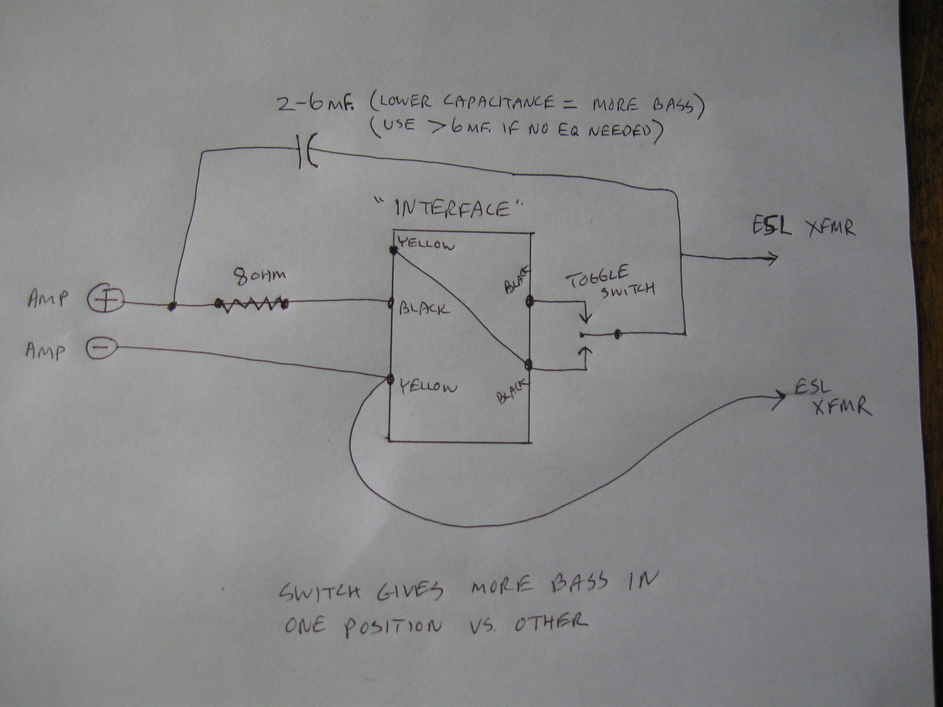

Congratulations on cracking the mystery of the Lucas "Interface," the potted "old work electrical" blue box that he sold claiming it "equalized" the response of his ESLs. I've always wanted to put it in an oven and melt the potting compound to see exactly what he did, but frankly the interfaces worked pretty well with the Lucas designed ESLs, so I left them alone and continue to use them with the Jazzman (copyright Charlie Mimbs) ESLs that I built.The interface allows the user to select either of two outputs, one which increases the bass response, the other decreases it. I still use the Lucas EI transformers but expect to replace them with toroids recommended by Charlie very soon. I used the Lucas flat panel ESLs and they worked without a problem for 16 years (although they never sounded so good until i stopped using them full-range and rolled them off at 330 hz. with an electronic crossover per Charlie.) Thanks for your input!
I got curious and tore apart one of the potted EQ units, which is, in fact, a potted Radio Shack 273-151B transformer, 120V, 60 Hz in and 12.6V-0-12.6V center tapped secondary (2 black wires on one side of Luca box are the 120V primaries, and 2 yellow/1 black wires on other side are the center tapped secondaries, with CT black), so it was a EQ choke of sorts, any one chime in at what Lucas was doing, but I assume it was to counteract the normal 3db/octave rise inherent in an esl panel.
Can you post a schematic, or describe how the wires from the RS 273-151B transformer were connected to the step-up transformer(and any other crossover parts)? That might give us a clue as to what Lucas was trying to achieve.

Here is a schematic I drew up of the Lucas "Interface." Lucas claimed this circuit allowed the amp to see an 8 ohm load constantly, and by adjusting the capacitor value you could "adjust the EQ for more or less bass." The toggle switch also allowed for "more or less bass," but you had to determine which setting was "better" by listening. Lucas wasn't specific. Hope this helps, and any info re: how/if the circuit works would be most informative.

Here is a schematic I drew up of the Lucas "Interface." ...Hope this helps, and any info re: how/if the circuit works would be most informative.
The schematic is most informative and is what I had suspected....one Lucas "mystery" solved 😉
It is the patented Audiostatic Mirror drive circuit which provides a +6dB or more bass boost for equalizing the dipole roll-off of full rang dipole ESLs.
Audiostatic used a large AT(autotransformer) with a center tap, Lucas is using the center-tapped 12volt secondary for the same purpose but with less power handling capability. With the switch in the down position the boost would be +6dB. The results with the switch in the up position would depend on the phasing of windings...either more or less boost.
Basically it works by sending high frequencies directly to the step up transformer thru the coupling capacitor connected to the top of the AT winding, but sends low frequencies to the center tap of the AT which then doubles the voltage at the top of the winding. This creates a shelving network with LF boost of +6dB.
For further details, see the attached Peters US patent.

Just confirming that the Lucas EQ unit that I discovered was a Radio Shack 25.2 volt center-tapped power transformer, is wired as the group has surmised: the yellow/black/yellow wires on one side of the unit are the transformer's center tapped secondary, and the two black wires coming out of the unit are the 120V primary wires. The xfmr was potted by inserting it into blue electrical box and filling with white sand, then potting with about 1/2" of white potting compound on top of that, so digging one out is no problem at all.
