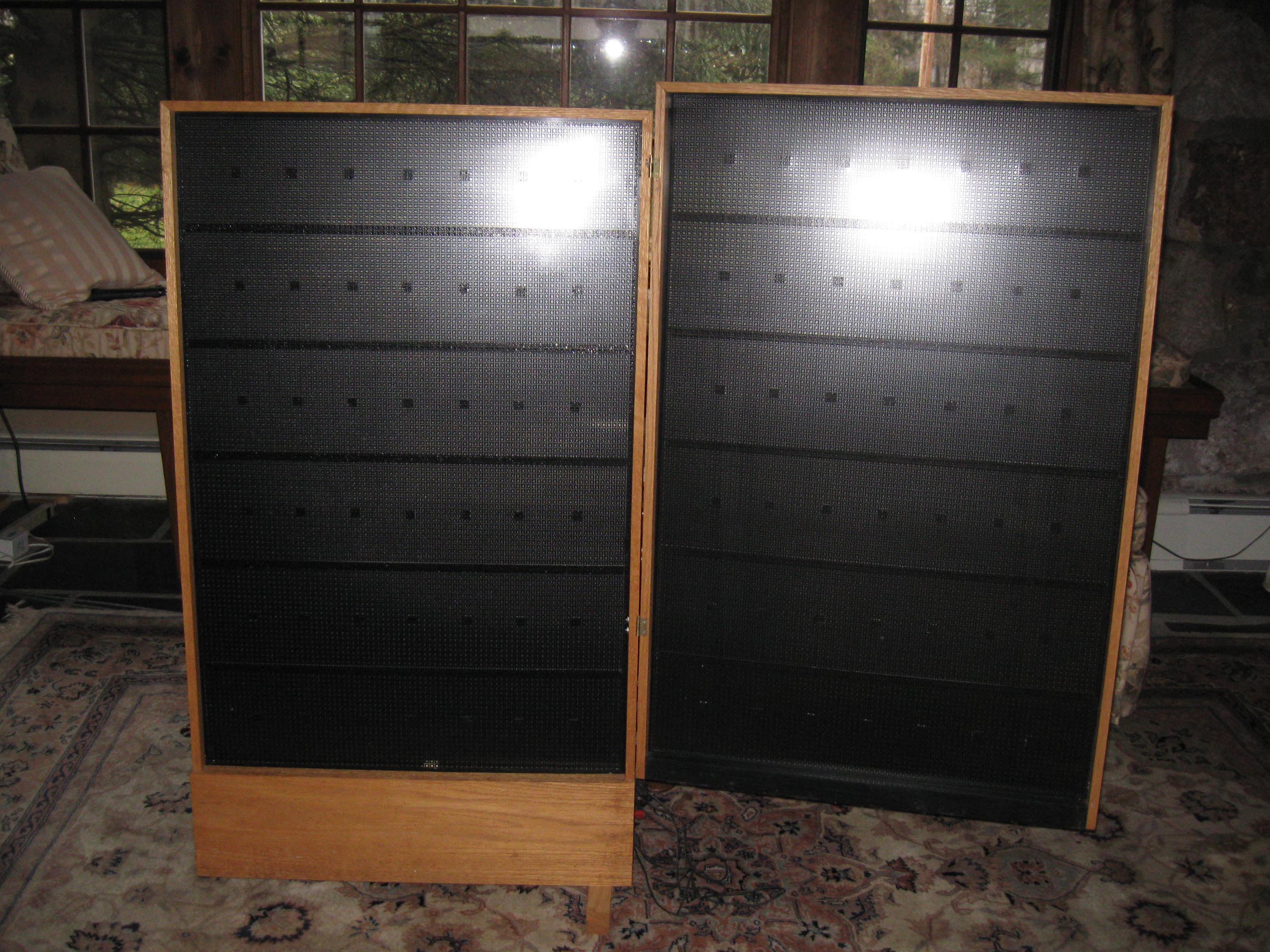

I'll work on posting some pix of my Lucas flat panels. Lucas plans called for using "Lincane" perf aluminum (like you see on home radiator covers), a graphite coated Mylar membrane heat shrinked with a paint remover heat gun. 1/16" double sided Foam tape (3M?) was used for the segments and spacer dots and the kits came with aluminum foil tape and a clear conductor substance that was used to stick the aluminum tape to the membrane and stators. Don't know the design of the electronics used because the bias supply (running off speaker inputs) and an arc-limiting circuit he supplied are in potting material (can it be melted so I can reverse engineer the circuits?). My biggest gripe is they aren't very loud compared to my other systems and you have to sit right in front of them for the best sweet spot, problems I know are inherent with ESLs. But, they have lasted ten+ years.
The sub-woofer ESL is made up of six panels of differing sizes stacked one behind the other. Two channels are arranged in a V configuration. I believe the panels are wired in parallel, but the sub itself is supposed to be wired in series with other mid/high range speakers (whether ESL or conventional speakers, I don't know.) I haven't built these subs so I can't pontificate on sound issues. I have the plans for the subs, flat panels, and curved panels if anybody wants them.

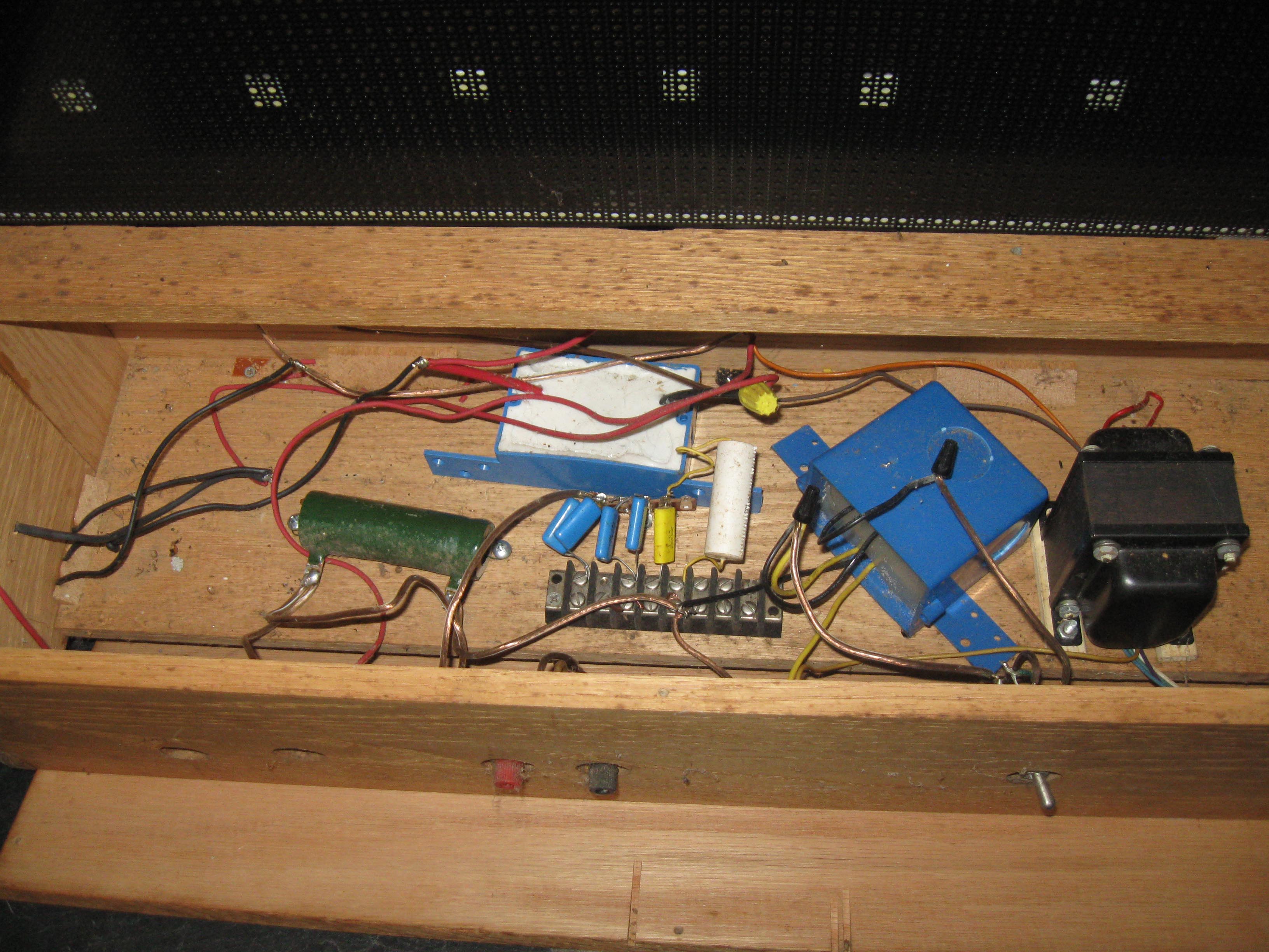

It is very cool to see a finished David Lucas setup !!!
I you can easily make a resistor divider network to measure the output of the bias supply.
I have my doubts that it is actually 10kv though.
How thick is the stator coating what type is it.
I have found that you need at least 8 mil of thickness in order to insulate 10Kv with common spray clear acyrlic enamel and red primer.
I have had 10 mil or so be able to sustain 13.6 Kv without any issues.

I have always wanted to try building some out of lincan.
Have you tried setting them up so that the 6" segments are vertical?
This would help to widen the horizontal dispersion of the higher frequency's a bit.
You should be able to be getting some decent bass out of that much surface area.
If you were to stack them and add a smaller tweeter panel of say about 3" or 2" wide segments might make a very nice addition to them such as Charlie's panels.

The panels were marketed by Lucas as full-range.But, with his "interface" added in the circuit, there may be some bass cut-off. There is a switch that allows choosing "low" or "high" bass, and my panels are set on "high." Don't know what the cut-offs or slopes are: Lucas never revealed that info. I have to admit I am reluctant to play them really loud because I don't want to burn up them up, so I am always riding the volume.Maybe I should get over that?
I have a high-voltage probe and will take a reading as I am curious about variable bias being a problem.
The Lincane (gold-anodized aluminum) was sprayed with one coat of Rustoleum (hey, I'm still learning...) A thicker coating might be a good idea, but I don't have the capability to use automotive sprays or powder coats. Will have to investigate what I can do about that. Also, I think the perf pattern is too small. I remember reading somewhere that Lincane is 40% (ratio of holes to metal) and that isn't good from what I've read in this forum. I will definitely switch to other perf panels such as those used by Jazzman.
I expected a narrow sweetspot with these ESLs and tried to compensate by building four panels, which helped. Haven't tried rotating the panels vertically...might give that a shot.
