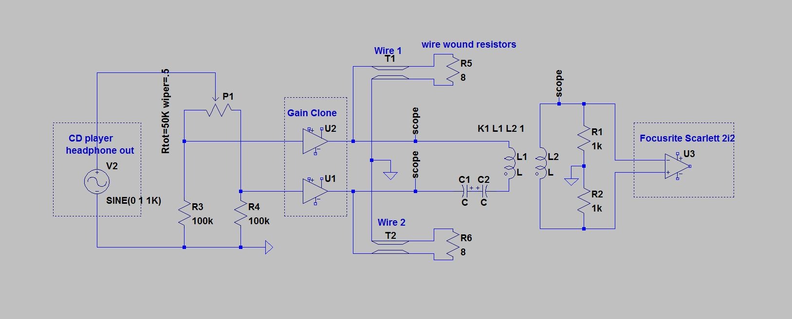

I know this topic has been done already.... but here I go. Originally dissatisfied by my understanding of how I think the Ethan Winer null test works,
(please accept my apologies if I have got the wrong end of the stick, I respect the effort put in to this), and intrigued by the interesting work by Max Townsend.
I hypothesize: to tell the difference between two wires the amplifier has to be part of the system. A year or two ago I did a null comparing interconnects using the left and right channels of a preamplifier one wire as a control and one EUT, and I could see a difference using a square wave and nulling on a scope.
Once upon a time I heard a clearly audible difference between a QED79 style cable and a Goertz low capacitance style cable. I imagined that it must be able to pick up this difference with a null. So apropo of nothing, but to avoid getting on with another project, I set up a circuit similar to below. I am using the 2i2 because of its balanced input to monitor with headphones.
My transformer is an output isolating transformer from a piece of old pro audio. I can't get the perfect null, but my initial result are interesting. Having made sure the gainclones are not clipping etc, with no speaker wires plugged in, apart from noise and buzz I get a fairly clean sounding rendition with some high and low boost. But when I plug in either wire, noticeable horrible grungy distortion. The distortion is probably different and the high capacitance wire is probably worse. I am a bit surprised, but am encouraged by this result. I have long suspected that a lot of the unpleasant sound associated with SS is its inability to drive cables without getting upset. Will try a tube amp next...
Please bring on the constructive criticism, I may have missed some one doing the same thing.

It is good practise in comparing something to try to isolate everthing in the setup that is not part of the something. By including an amplifier, you introduce a factor that has nothing to do with the cables you want to compare. For instance, the capacitance differences between cables can cause differences in the amplifier stability. That means you are not only comparing cables.I hypothesize: to tell the difference between two wires the amplifier has to be part of the system.
I understand your setup and it is quite ingenious, well thought out. But there are many factors introduced that can make a difference and with this setup it will be extremely hard to convince sceptics that the difference you hear is the cables.
As just one factor, the transformer will introduce a lot of non-linearities and will pick up stuff that can even differe with lead dress.
The use of music is also probably the worst signal you can use as it is unpredictable and extremely hard to measure difference with sufficient accuracy and resolution.
The CD player, the pot to balance the signal and the reliance on the two amps to be identical in performance is also weakening the case.
Take just a single signal generator, swap cables and measure, and be sure to equalize the signal generator load in the two cases. For instance, if one cable has lower capacitance, add the difference to the generator output to get identical loads. Etc.

There are several valid points hat Jan brings forward, but some of those points can be easily neutralized.
Here are a few tips.
1) What signal to be used.
IMO white noise would be the most neutral and repeatable signal.
This has to be checked with an FFT over at least a 200msec recording, giving frequency bins of 5Hz, somehow corresponding to the the auditory sensitivity of humans.
This FFT, averaged over multiple spectra will show the used spectrum after the two gain clones and should be absolutely identical.
2) Transformer.
It would be easy to feed the transformer on both sided from one gain clone, and again measure the spectrum on the secondary side.
This will show the CMRR against frequency of the setup with transformer
3) Noise
The secondary noise in test 2 will be a measure how deep we will be able to discriminate distortion from the input signal.
This should be well below -100dB.
4) Load
I don't know in how far the circuit diagram in #1 is representative, but for testing interlinks as in the video, 8R is way too low and should be at least 10K or higher.
Suppose you make a short circuit with interlinks, then this setup will tell that the cables don't add anything.
Anyhow, the load should be as neutral as possible and not become part of the test. So the should be non inductive, having a very low voltage coefficient and absolutely no wire wound resistor should be used.
5) Gain Clone neutrality
It will be easy to test what happens when one gain clone is loaded with resp 1nF, 10nF and 100nF.
This will show in howfar the Gain clones can be regarded as being insensitive to a capacitive load.
Just my two cents,
Hans

Agreed Hans.
And the simplest way to exclude the gainclones from the equation is to use one and the same with both cables. Just switch the cables.
My biggest issue with the proposed system is that there's so much stuff in there that is not under control that can easily sway any results.
Whatever the results are, anybody that sees the setup will never accept the result because it cannot be trusted to be only dependent on the cables.
Jan
Jan

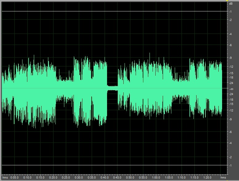

Has anyone been able to listen to the audio mp3 zip file. I feel a bit uncomfortable posting it, I should probably find some YouTube royalty free music? and burn it on to a CD, if I can find my burner.....

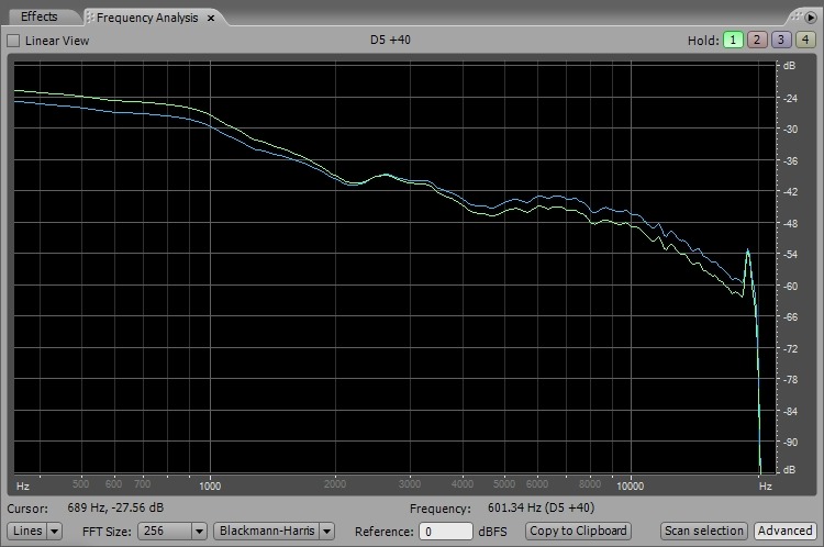

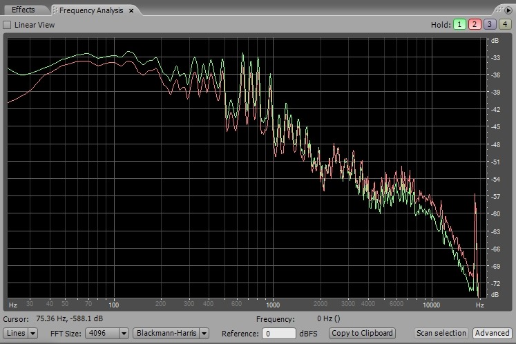

Both sample are quite different, both audible and visible. I removed the first 13 seconds of the first sample to have a more equal view of both.Has anyone been able to listen to the audio mp3 zip file
Green = sample 1, red = sample 2. They only match at 2.5kHz.
Hugo

It was CD, Jacob Collier Djesse Vol. 2 track 3 or 4, 2:50 to 3:40 iircYou have the link to the original YouTube song?
Hugo
Interesting plot,
Introducing (unintentional) bias, is the least thing you want to do.But I suspect I am looking for some complex inter modulation by-products, and I know what it sounds like, So I use music.
So measurements first where you know you can rely on.
Intermodulation is extremely easy to see and value when measuring pure sine waves.
Our own listening isn't reliable tool at all.
Mostly because we don't just only objectively listen, but our brain and other senses WILL mess with it.
Like I said before, get a objective baseline first, move from there.
Any other approach makes the whole test very quickly invalid.
The only exception is doing double blind tests. These tests can be very troublesome by themselves (also practically speaking), they also don't give proof of the hypothesis. They are only there to exclude variables and/or show us potential differences and hooks to work with.
From a statistical point of view they can be a big can of worms sometimes as well.
Also, I would advise doing some literature study first.
Knowing the orders of magnitude we are talking about, your average sine wave generator isn't gonna cut it.
A YT rip with already compression in it, is also not the way to go.
- Dave's attempt at a Null test
