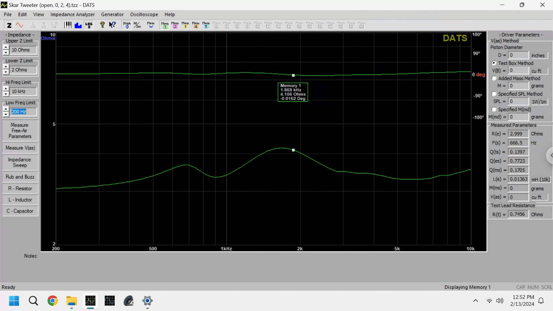

Hi! I'm an enthusiastic amateur with almost no electrical/physics background, but I have a DATS V3 and a pile of speakers. When I run sweeps on tweeters, I get strange/unrepeatable results. This is a 4-ohm car audio speaker with no filter between the DATS and the driver. The manupackager says "frequency response 1.6-20KHz" so I have that as a guide, but I have a lot of undocumented drivers I want to test, too.
First of all, running 4 sweeps gets 3 different results; they look the same on the chart, but the Fs wobbles, sometimes 2-3 octaves low. On this run, the software reports Fs at 666.5Hz. SOMETHING is happening there, but the highest impedance is at about 1.7K, and the phase flops at 1860Hz. Can I limit the sweep parameters and get saner/more consistent readings?

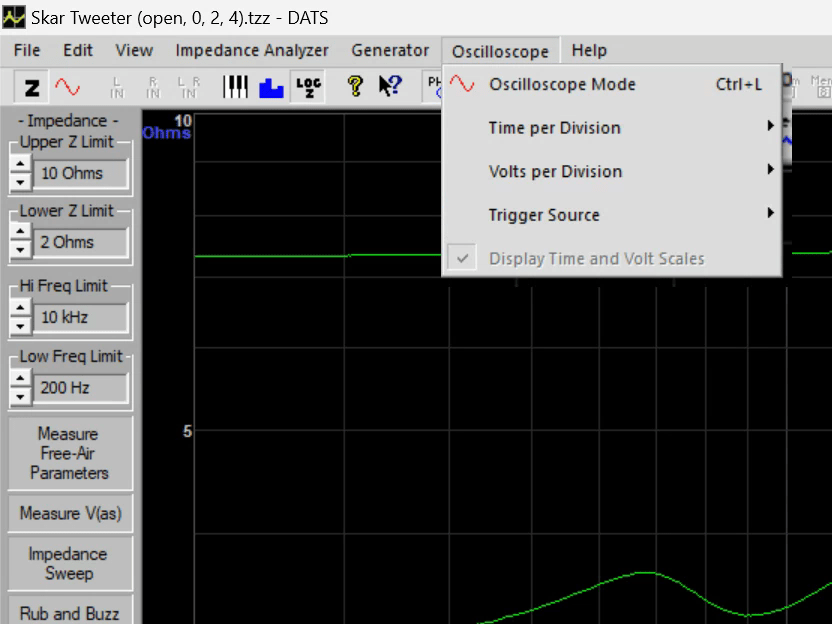

— DATS V3 Brochure, pp.8The DATS Signal Generator and Oscilloscope Monitor:
The DATS oscilloscope shows you the input audio waveform with amplitude on the vertical scale versus time on the horizontal scale. The dual-trace oscilloscope displays the input signals in several different modes. The voltage range can be adjusted from 5 V per division down to .001 V per division. The time base ranges from 200 ms/division down to 0.05 ms/division. The traces can be triggered from either the left or right inputs.
They were really sneaky about it though, and hid it in its own menu.
It's not a GREAT oscilloscope; I wouldn't use it for testing ICs and crystals, but since you can use the mic input on your phone (with an app) as a scope, it's not a surprise. It even has two channels of input on the scope screen; I assume you can just set the DATS software to use another interface, but I haven't tested it. Yet.
If it's a tweeter, the impedance response is really only interesting for designing passive crossovers. Often you need to compensate the impedance to make it flat for a few octaves where the crossover is so the filters will work properly. If you use active or digital crossovers it doesn't matter at all. The resonance looks to be the center of the upper hump at around 1,500 Hz. As there are two peaks the software likely can't decide which is the one to display. That two hump impedance response is often associated with a ported cabinet where the frequency of the saddle between the humps is the port resonance. It could be the tweeter chamber has some resonance at that frequency or something.

Yeah, I'm working the passive crossover angle, and the first, tallest impedance spike is usually the Fs. Just frustrating that the software is guessing poorly, and you're probably right about the enclosure/cup interfering.
