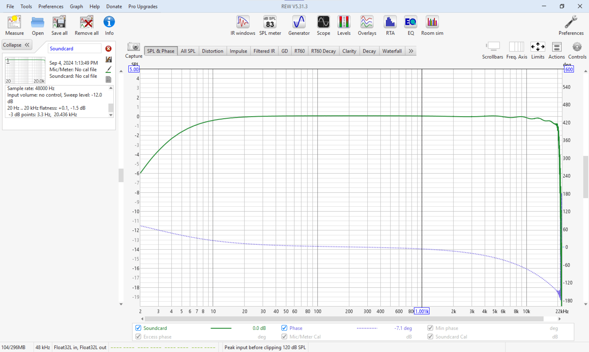

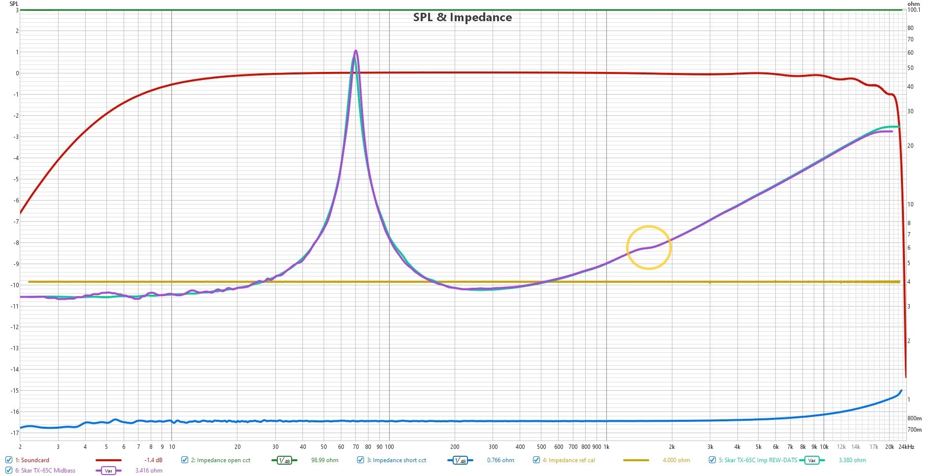

Folks, I'm over the moon. I followed olen's guide on my Windows machine (DATS was already attached, so why not?), "calibrated" R-ref against a more or less random 100w 4-ohm resistor I use for amplifier loading, and I went for broke. No smoke, no fire, so I attached it to a bare driver that's on my desk, and told REW to tell me about it through the DATS interface. Then I pulled up an old impedance measurement from the same speaker using the DATS software calibrated against its own 1k resistor, and...they're quite close enough to be useful. REW even rendered that weird little 6.0-ohm wobble at 1.5KHz that I always thought was DATS being strange. Maybe it's still the DATS hardware being strange, but it's not a difference in the software!
The wiggle at 1.5kHz is probably a mechanical resonance, that’s pretty low for a cone breakup mode, it could be due to how your driver is resting/mounted. It should be easy enough to retest it so that it’s not resting on the magnet and see if anything changes.

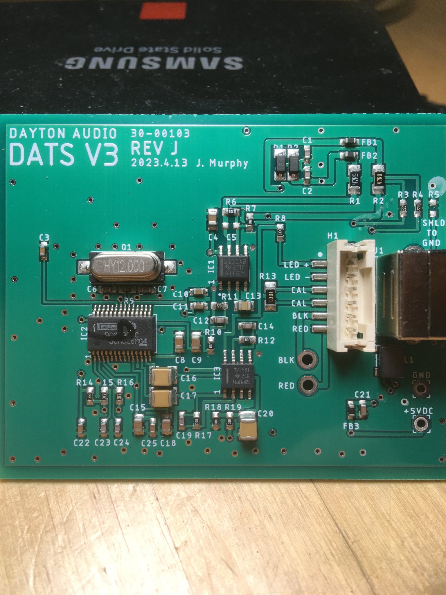

I’ve opened a bought DATS v3 case few days ago and looked at the board.My Dats is from 2023 (See picture below).It also has the 1000 ohm calibraton resister built in. It's quite different from the one olen has.
Linux Manjaro runs on my laptop.Wine is installed. Wine was used to install the Dats software.Rew linux version 5.31.3 running.
My Dats differs from the v3 showed in the manual (DATSv3 on a Mac) posted on diyaudio by Olen. @olen , Thanks for that! It made me confident to try out the DATS hardware with REW.
There is only one LMV358 opamp) on my version.The 10kΩ series output resistor i can not locate. If someone has a clue how to measure the series output resistance or can point it out on the board I show here, that would be great.

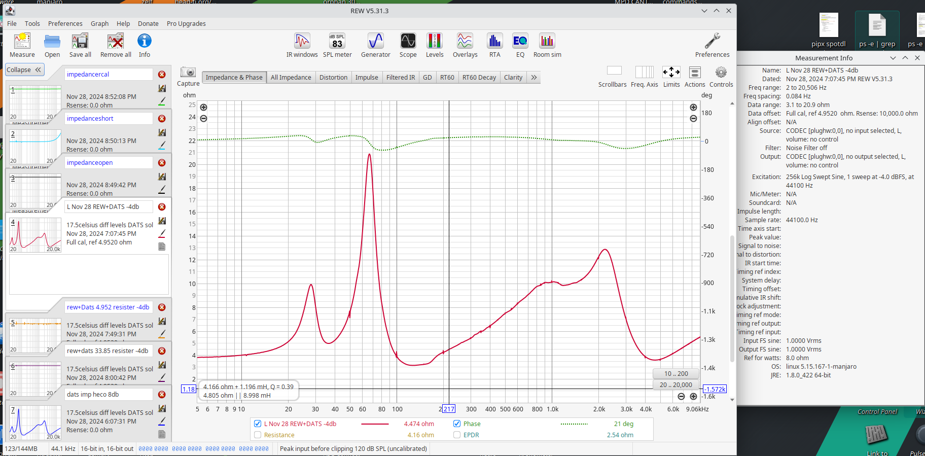

I used these values with the help of olen's manual...exept for the leads value:
In REW with Dats usb AUDIO CODEC chosen..impedance calibration setup:
10kΩ for the Rsense value. (based on the value of output resistor) Don’t know my Dats R value.
Set Rsense = 10kΩ
100kΩ for Rin
10mΩ for Rleads. I used 0.7399 Ohm Messured earlier with dats sofware.
For the reference cal I used a 4.952 ohm resistor.
For the reference cal value i took a precision resistor of 100Ω earlier which seem to work as value and gave simelar results. Later i used the 4.952Ω closer to the minimum impedance speakers as recommended.. It was not a reference resister but measured it with Dats earlier. My cheap multimeter shows same value.

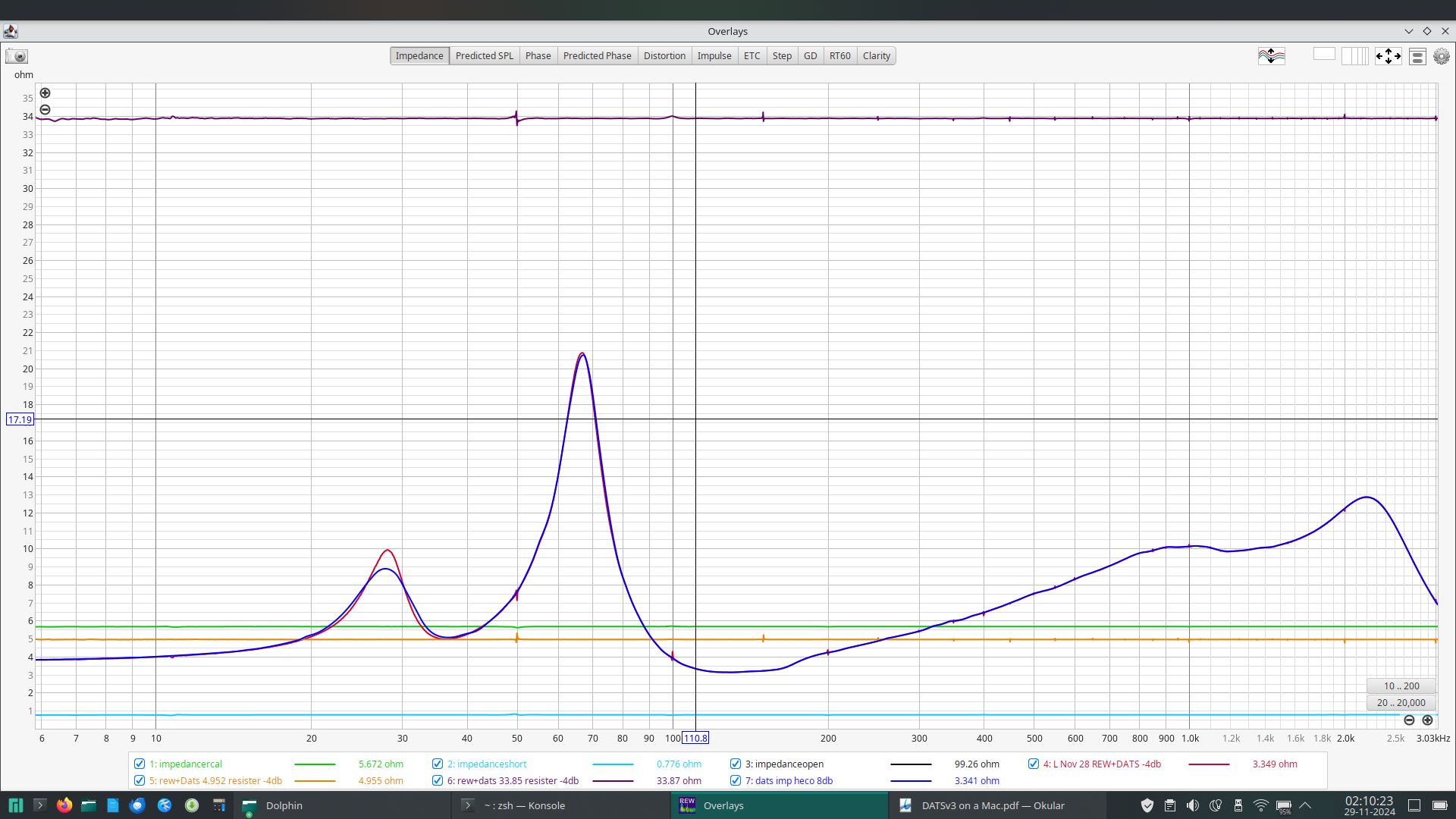

1) REW+Dats vs Dats resisters measurement shows fairly accurate down to 0.2% 0.4%.
2) REW + Dats is more noisy then dats-only. There are ways to improve that. But even like this its usable in my oppinion.
3) In Rew's the impedance peaks (Most clearly the left one) shows 1 ohm higher then what dats is measuring.
Not shure if this is a problematic large difference or not....

Comparison measurements Dats vs REW+Dats, shown here were done at 17.5 celsius.

D) I would appreciate if someone could look at the differences in the graphs, especially at the first peak, and if they indicate wrong input values in REW for my Dats. All measurements are consistent with very little varations.BIGGEST DEVIATION..Dats vs REW+Dats differ about 1.2db at the first peak.

below: 2.5 way speaker impedance measurement including crossover...+ impedance cal
dats= purple
Rew+dats =red 1.1db difference at 28hz The rest of the plot almost identical.
again rew+dats+ phase
dats= purple

I have the same rev "J" hardware while the casing says "H" . The circuit seems significantly streamlined compared to rev "H" pcb and does not carry the trimpot. I opened mine because i was wondering why three DATS3 that we have between friends show black+red test cable resistance to be 0.31, 0.53, and 0.74 Ohm, respectively (alligator clips firmly joined). Putting a blob of solder near the white 6-pin connector (across tabs "RED" and "BLK") brings down the resistance display in DATS v 3.1.6 from 0.53 Ohm to 0.47 -- so the root cause seems on the board or in the software. The internal 1k resistor is calibrated to be 1002 Ohm
