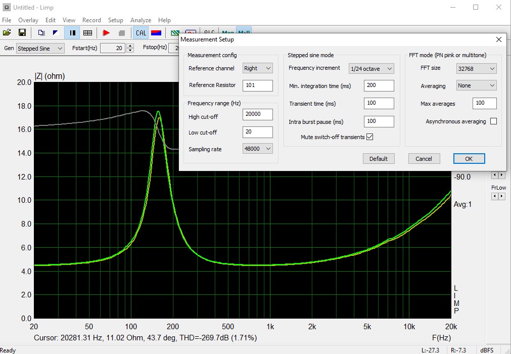

A Aucosticraft Member Joined 2009 2018-09-09 8:34 am #1 2018-09-09 8:34 am #1 How to configure Arta (LIMP) to use with Dayton's DATS hardware? What would be the value of Reference resistor? Art Benjamin Member Joined 2016 2019-09-13 6:03 pm #2 2019-09-13 6:03 pm #2 I'm wondering the same thing about using the DATS with LIMP and SoundEasy. E ergo Member Joined 2001 2020-09-05 7:45 pm #3 2020-09-05 7:45 pm #3 One can use DATS v3 successfully with LIMP. Yellow curve is measured with a sweep on DATS software and green curve with stepped sine on LIMP with reference resistor set to 101 ohm. Attachments DATS_v3+ARTA.jpg 150.5 KB · Views: 150 You must log in or register to reply here. Share: Facebook X (Twitter) LinkedIn Reddit Pinterest Tumblr WhatsApp Email Link
