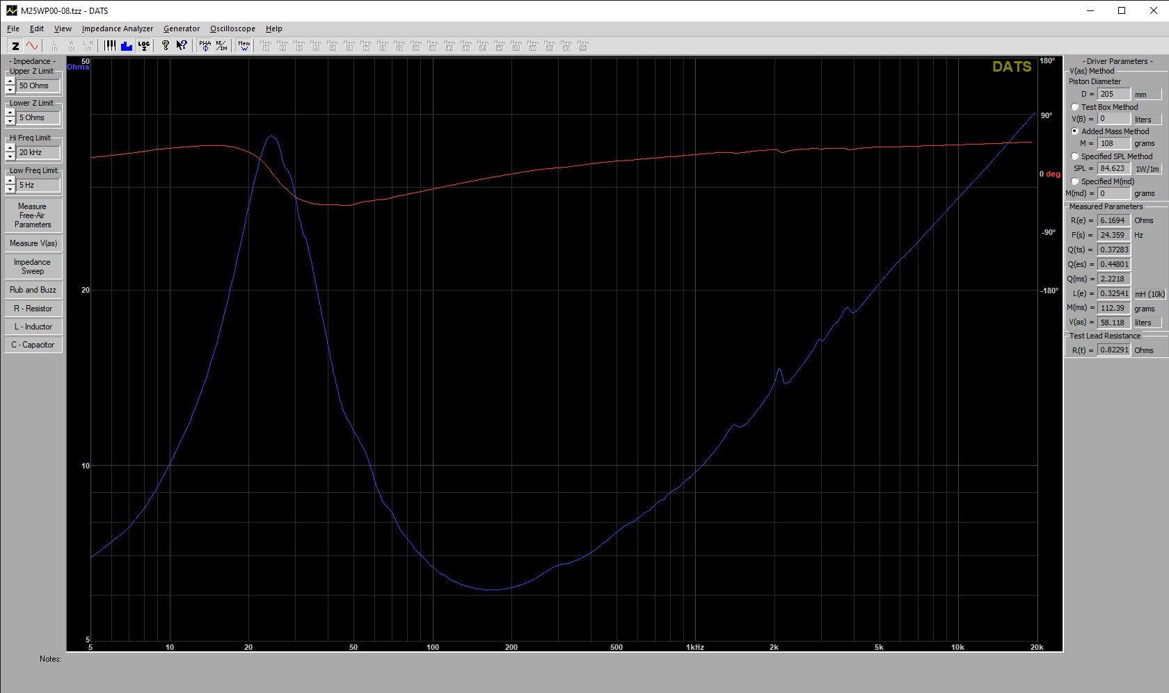

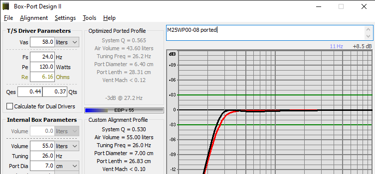

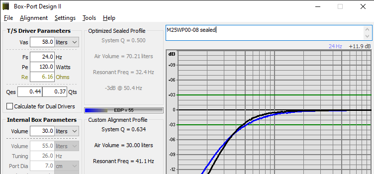

Hello, I have a piece for a subwoofer in the car, but I put another car driver, here the measurements with dats v3 and simulation in the boxes.

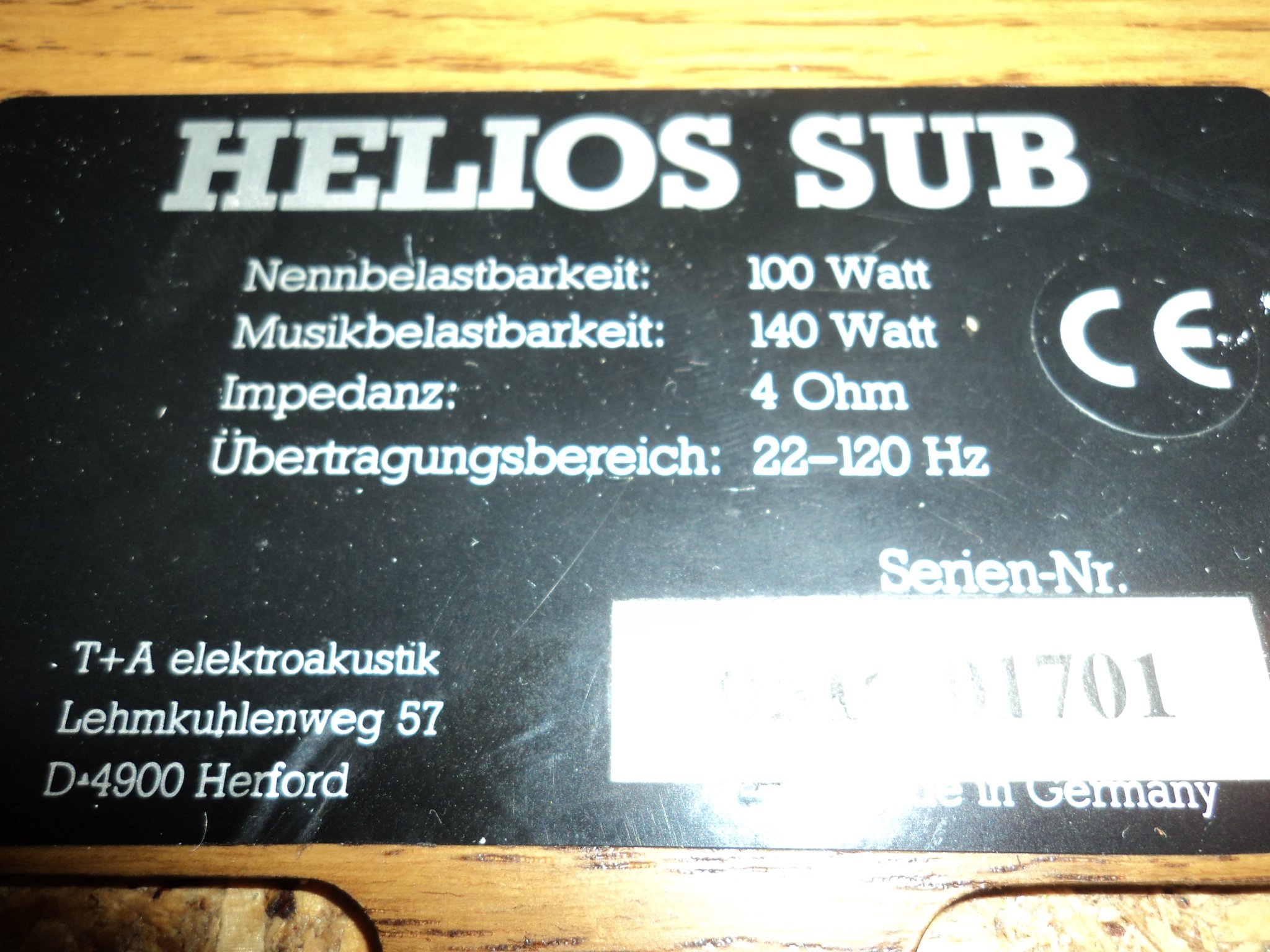

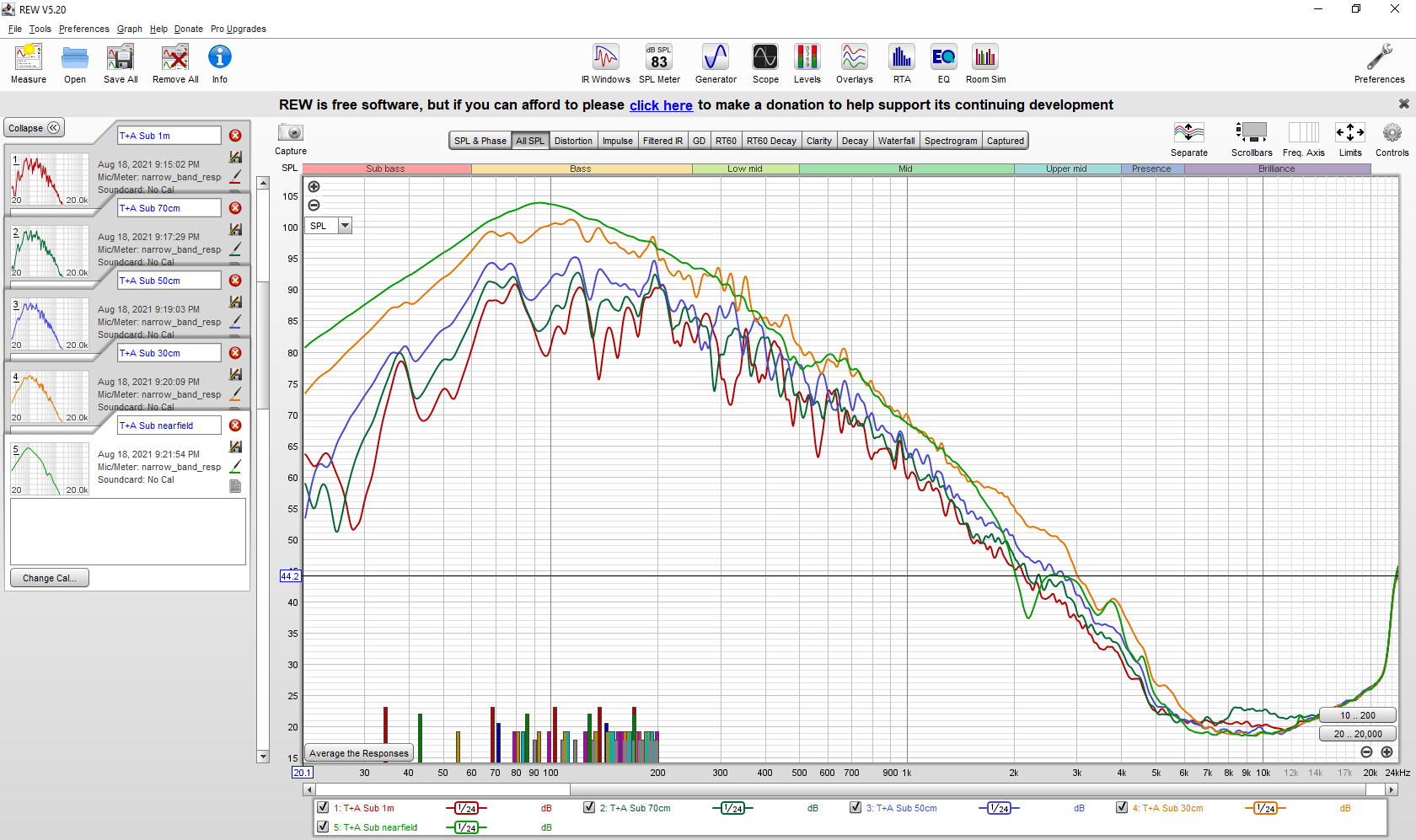

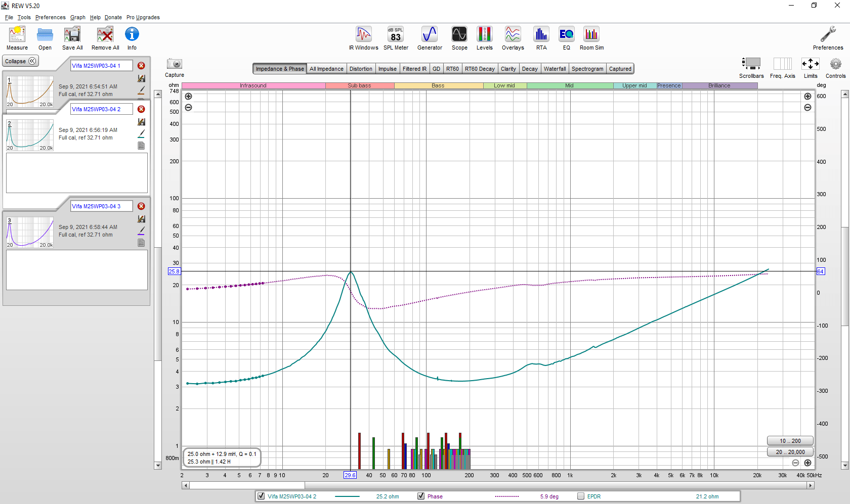

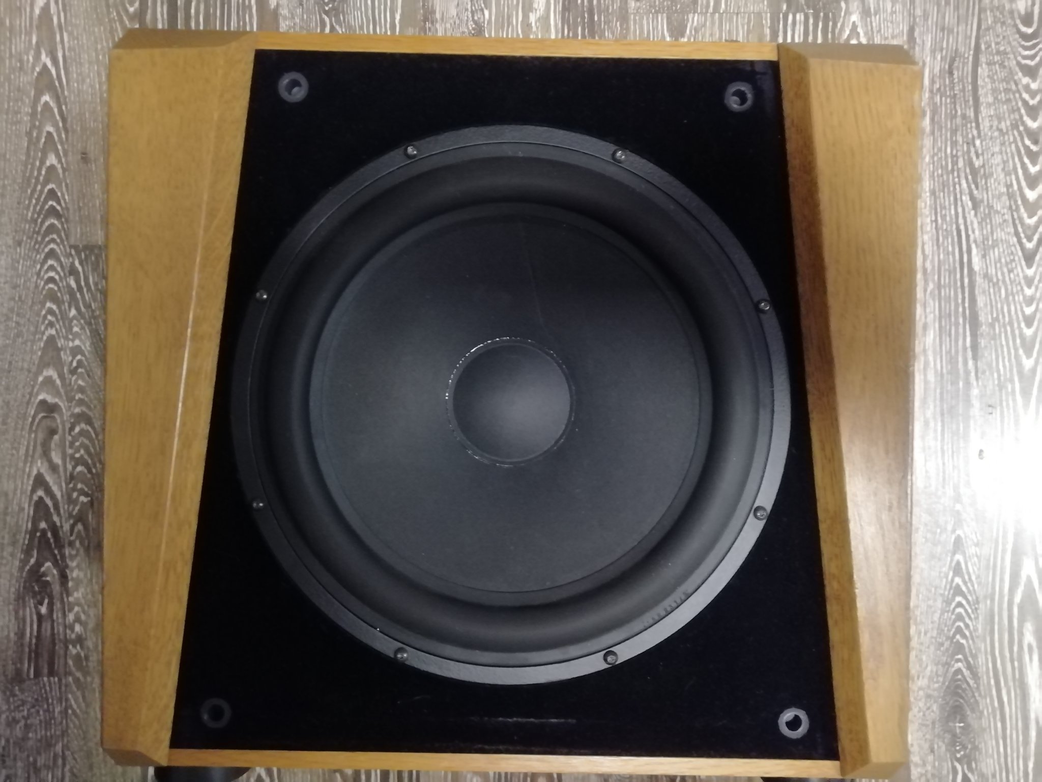

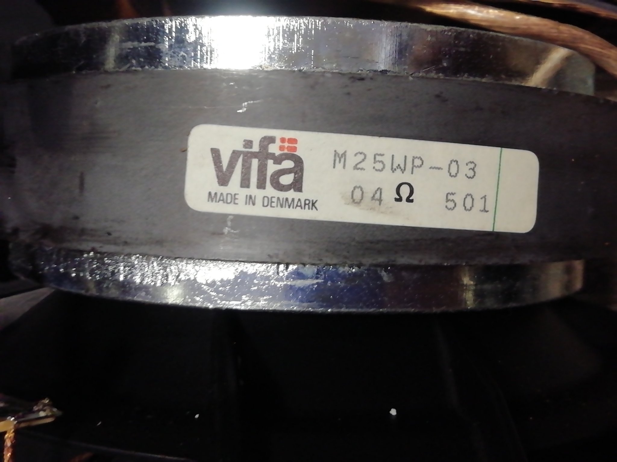

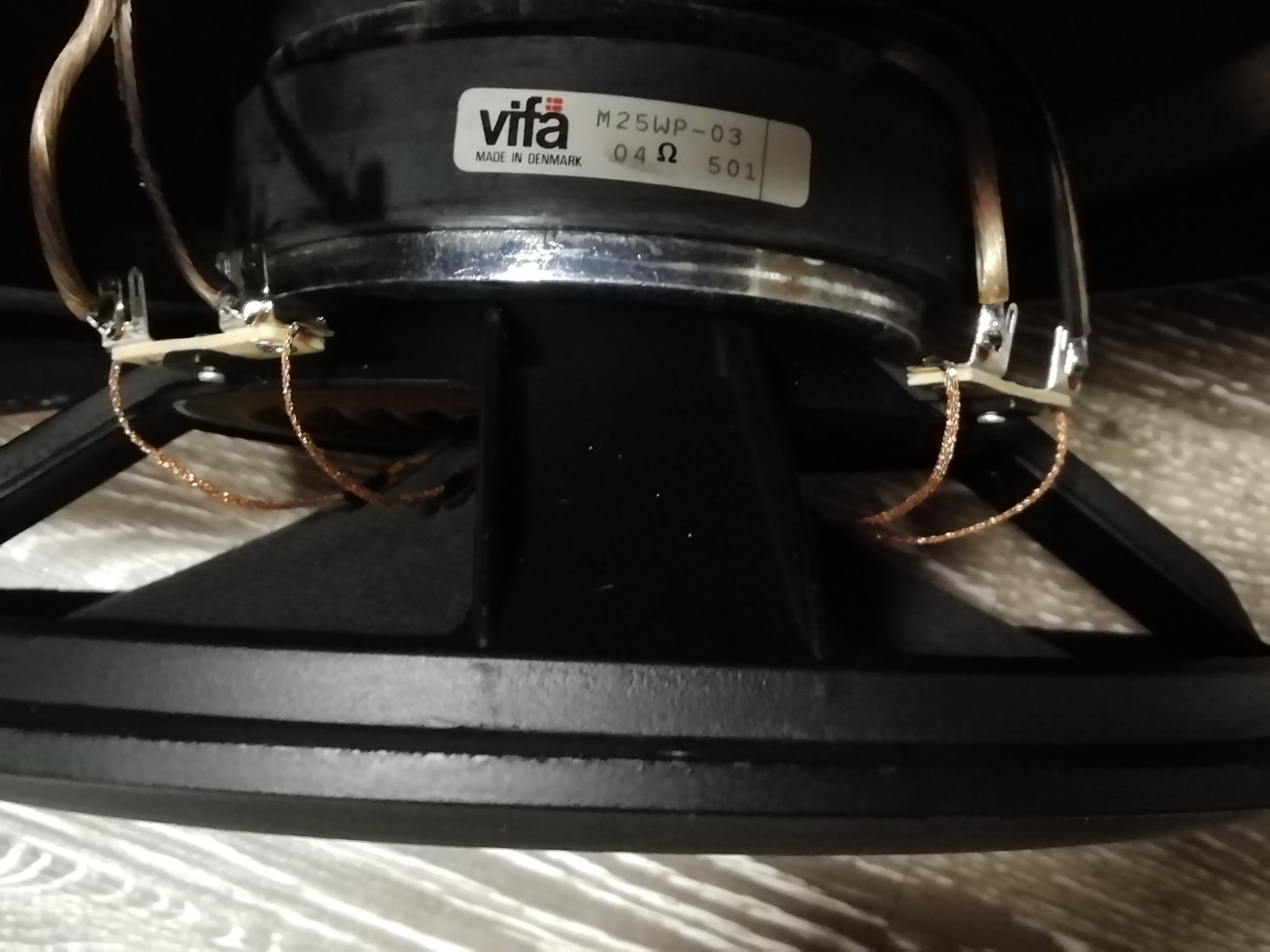

Here are pictures and measurements of the Vifa M25WP03-04.
