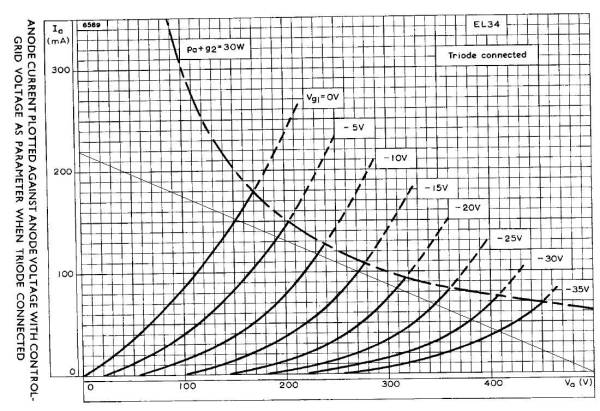

Since I posted I found this and downloaded it. It looks like it will really do the trick. I used the following procedure.
1. Window capture of curves from a Mullard data sheet (pdf) using GIMP. I cropped and saved the resulting file.
2. Open GIMP output file in windows paint and used line drawing function to put in a proposed load line.
3. Import the resulting drawing into Engauge.
4. Set the axis points.

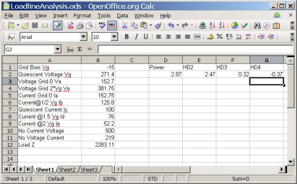

5. Point to the data points of interest and enter the needed values in a spreadsheet using Steve Bench's formulas for Power, HD2,3,and4
It seemed to work quite well. Doing the same thing for PP may be a bit trickier but will be fun to try.
Here is the image that I imported into Engauge.
mike
